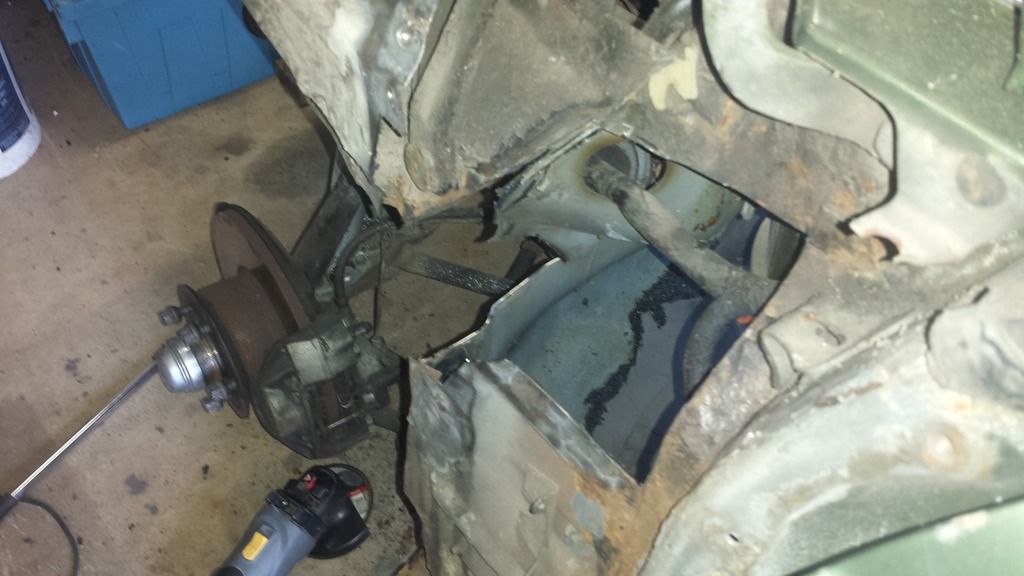

Rust repair

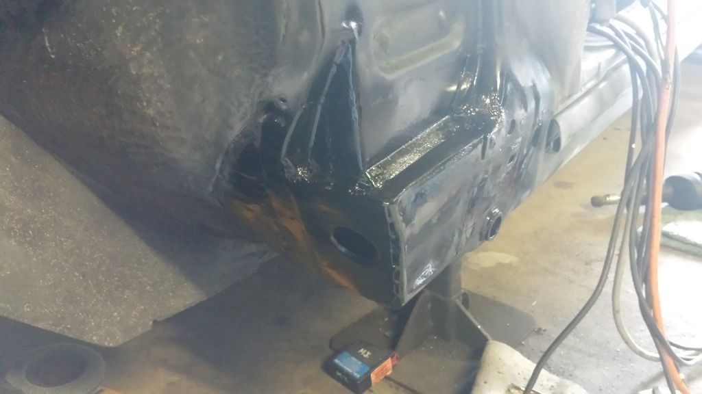

I started some rust repair on my LHS front guard / fender last night. After cutting out the rust hole with a wire brush wheel on my 4" grinder (and removing about 1 kg of 'soil' that formed inside the guard over 40 years of leaves filling it), I noticed that there is rust further inside and set about trying to remove the guard before reading the posts on this forum outlining what a nightmare job it is due to the factory sealant holding the panels together. I'm now unsure as to whether it is worth proceeding further. I hope I haven't already damaged the guard beyond further use trying to pry it off. I might just try to remove as much rust from the inside bit (probably structural?) and load it up with rust converter + kill rust paint, patch the hole and put it all back together, ensuring water can drain away? Cosmetics are a secondary concern for me - primary is to stop the cancer as much as possible before it spreads further.

The finished product. I could have spent a little more time sanding the bog, but hopefully this will halt the progress of the rust in this area for a while.
I won't be rushing to do the other side in a hurry, but at least it drains properly now too.

I hope you have noticed the rust in the A pillar above the sill panel. The water that gets in there will run inside the sill and can also wet your carpets which will then rust out your floors. Please don't leave it too long.

Kcodezd - thanks for your input. Yes I have wet carpets every time it rains and rusted floors. Have drilled holes at lowest point in floorpan to drain as a temporary measure until I get the cause sorted out.
I'm still not 100% sure of exactly where the issue is, even with your description. Do you have a photo? Someone also suggested the area where the bonnet hinges are - drains get blocked with leaves and rust out. I think someone has already had a go at mine, but the sealant has come away again. I will take some more photos and post here.
Amazingly, the only common spot that ISN'T rusted in this car is the passenger side windscreen wiper pivot.

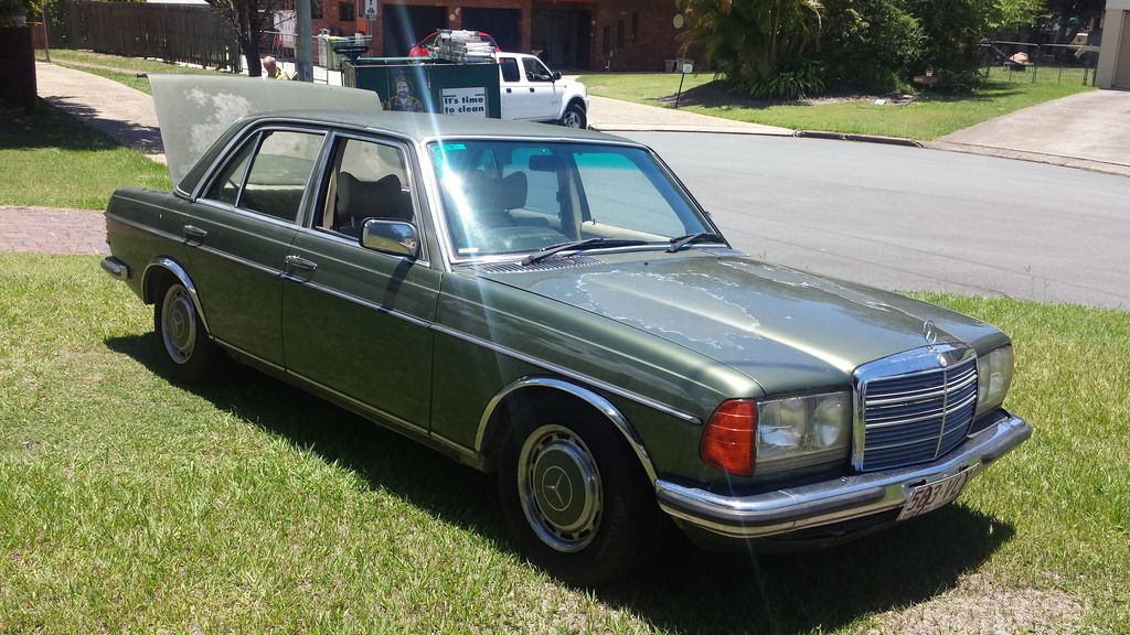

Re: Rust repair
This is my 280e that I'm in the process of repairing. I bought it in January this year and even though spending at least one day per weekend since then, I am far from finished. It is sad to hear people see this much rust that it's not worth repairing and decide to strip for parts. I know there were nearly 2.7 million of them made, but with that attitude there won't be many left soon. Especially in Australia.

Ok, yes - that all looks very familiar. Was it tough to get the front guards / fenders off?
I see your A-pillar rust and raise you some air vent rust. This should be fun to fix.
Also - do you know how to remove this pice of trip on the C-pillar to get to those few bubbles in the paint?

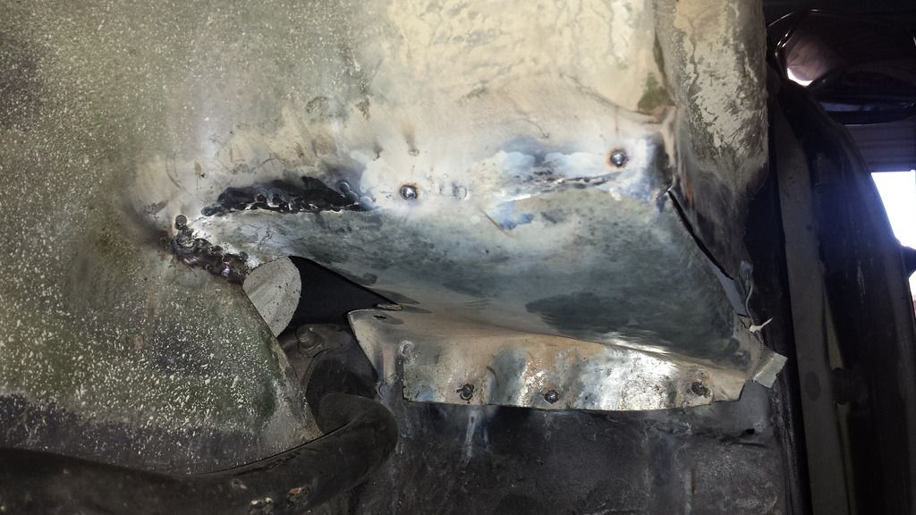

Re: Rust repair
Hi 3DB, first question, yes it was hard to remove front guards. It took me about 6 hours each to remove. I started with Stanley knives hacking at the body deadner, then google suggested using a flame to burn off body deadner, so I tried that. I do not recommend this option due to the toxic smoke it created. Third attempt and the most successful albeit still extremely time consuming and exhausting was to use mig wire tied to two screwdrivers, dragging between body and guard. Problem is you think your cutting through then the wire snaps, Again and again. Also it is easy to crease the top of the guard as you bend it up trying to reach the difficult areas.
Second, well not so much a question but an ante, my area below the front screen next to the air vent is actually in good condition. I have to thank someone for that, not sure who though.
Third question the C pillar trim removal isn't as hard as it looks. You will need something thin like a butter knife. Plastic preferably to lift the coloured strip in the middle, slightly bowing it out at the centre until the tabs pop out from each end starting with the rear of the vehicle end, then pulling it rearward to come clear of the front end. Then there are two screws to remove. Rust removal is then up to you.
My car is not registered yet so it isn't a big deal deal for me how long it takes to repair parts, but if yours is your daily it will no doubt be pretty daunting work to do on a weekend, and have it going again Monday morning. Good luck and keep up the posts of your progress.

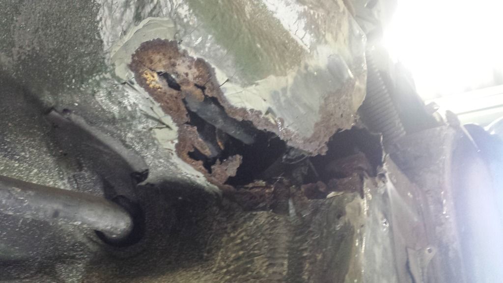

Re: Rust repair
Have you ever started one of those projects thinking it will be pretty easy and quick, then wish (far too late to turn back) that you'd left well enough alone?
I give you Pandora's Box:

Re: Rust repair
3DB that is the question I asked myself as soon as started looking closely at the rust at hand. The first bits looked daunting but as I go it seems easier to manage, and as I have small wins I get satisfaction in doing so. Here is some pictures of my progression, which I have hundreds of to remind where I started to where I am now. It is like therapy for me now.

Re: Rust repair
Very nice - looks very neat and, more importantly, structurally sound. Are you using a MIG? How do you go about rust proofing / sealing the inside surfaces and welds? Very nice.
Unlike my bog work around the door trim holes. Any tips on sanding that back with something mechanical that won't take forever, but also isn't too easy to overdo and thereby undo the work already done? I've tried with a flexible sanding disc on my 4" grinder, but it is too much and one false move ruins the finish and I have to top it up. By the same token, sanding by hand is out of the question unless it is just finishing touches. Maybe one of those small electric 'finishing' / 'detail' sanders?

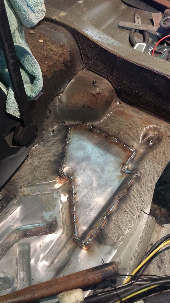

Re: Rust repair
Yes I am using a mig. The pictures I have posted, I was using gas less wire,which was ok but very messy due to lots of splatter. I have since started using argosheild lite which was a massive improvement, which then makes it easier to grind back the welds, highly recommend it. My whole car needs repainting so therefore not concerned about the original paint, so I attack with wire brush on an angle grinder or a 3M paint removing disc on the grinder. In side were I have welded is the biggest concern for rust to return, I try to paint all the insides as best I can before closing it up then spray liberal amounts of tctyl rust preventative every where through the holes Mercedes supplied from new. Fortunately there are many there.
Picture of the passenger floor using argon gas mig welding.

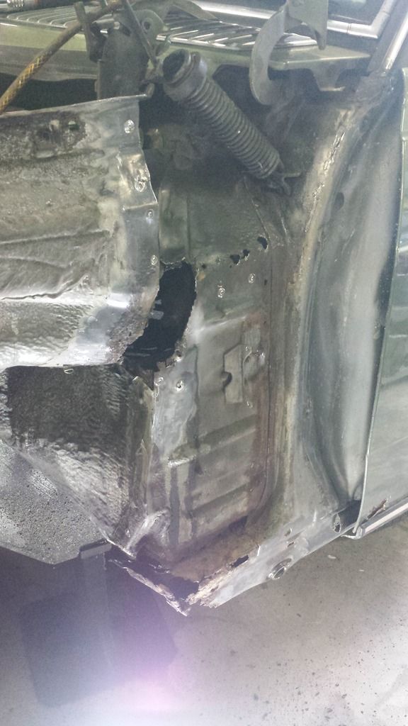

Re: Rust repair
I've now tidied up the big holes I made removing rust with the wire brush wheel. Again, I could have paid a bit more attention to filling & sanding the holes, but at 11:30 on Friday night I'd had enough.
Every time I think I'm getting close to done, I find some more.

Just a tip:
When you make sharp edges in your primer/surfacer like that, they are actually very hard to smooth out with the surrounding paint.
The trick is to make feathered edges. This can be done by using a tape trick using some wider masking tape. Roll over one side and stick it onto the front (glue to glue). The tape is now about 1/2-3/4 as wide as before.
The folded edge (don't make a sharp crease there) is now becoming your boundary for masking.
Paint will now just be dusted underneath the masking tape, creating a feathered edge.

I'm back on the rust bus again. Key objective: halt or slow the rot.
The parts I didn't get to 12 months ago are much worse now, so I need to act before I've got nothing left to work with.
I did the bit next to the air vent below the windscreen today and it goes back right up under the screen. Have removed all the rust I can and treated with rust converter. Will prime tonight....after that....not sure.

great pictures. just curious , how did you cut the odd shape near the glass ?3DB wrote: ↑Sun 10 Dec, 2017 6:35 pmI'm back on the rust bus again. Key objective: halt or slow the rot.
I've also developed some rust on the windscreen wiper motor cover....I'm fairly sure that has never been off the car by the looks. All that sticky foam sealant is still there, but needs to come off to paint. Should I get a new bit of the foam stuff or jut use silicone?
The other bits I need to deal with are:
- under the driver's wing mirror; and
- C-pillar.
Both have trim around and I'm still not sure how to remove that. Is it a case of just prying off with a screwdriver, or is there a trick to it that will avoid snapping it in pieces?
Also, the bottoms of my doors are looking bad around the rubbers, as is the boot. I'm scared to look deeper at this as it will probably be another Pandora's Box. But I'm wondering if I should just pull the rubbers out in the short term to let it all dry out a bit?

I used my new Dremel with a tiny little cut-off wheel. It worked a charm - took an entire wheel though.mathuisella wrote: ↑Mon 11 Dec, 2017 11:36 pmgreat pictures. just curious , how did you cut the odd shape near the glass ?
The purists might be advised to stop reading now as pictures of the repair are to follow and it is not pretty.
So I cut out all the very rusty bits, wire brushed as much rust as I could, all the while with the vacuum cleaner running to stop bits falling into the cavity to create more issues later.
Applied rust converter.
Painted with Dulux RustKill or similar (I only had an old tin of white)
And fabricated a patch out of aluminium checker plate.
Drilled some holes and riveted it on.
This will be my method for all rust holes going forward.
No more stuffing around with bog trying to get it neat, only to have the rust re-appear in little patches 6 months later.
I think it is in keeping with the ever more rat rod / industrial look that the car is evolving into.
I did bog the little hole on the windscreen wiper motor cover and re-painted the underside of it though.
