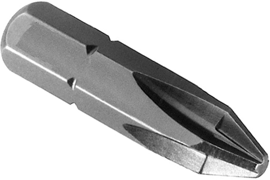

I used a Phillips head bit that I mount into an adapter, which fits onto my 1/2" ratchet.
Phillips bits come in various sizes, I think this is Phillips #3. Make sure you get the right one, otherwise you round the screw and you have to drill it out.
I replaced my screws with allen key countersunk; better availability and easier to remove...
