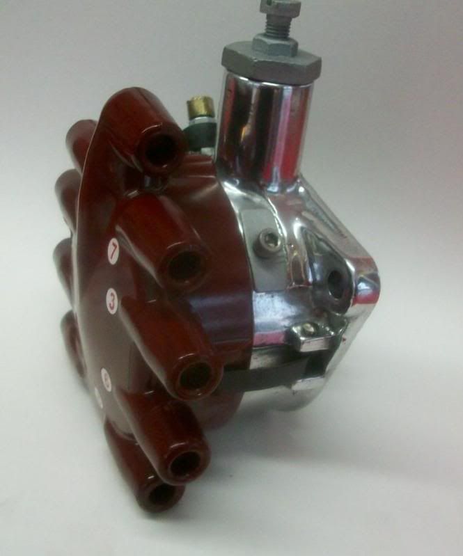

The dizzy on a M189 is gold plated with a cap that looks just like a 1948 Ford V8 cap but cost $600 .
:laughing6:
One thing ..All engines do the same thing,they just look different so the lack of a ECU controlled injection just means that everything is mechanical rather than Computer controlled. The same parameters are used in MFI,air and water temp, engine revs Vs throttle opening etc. They also tend to run a lot richer at 5% C/O at idle. Your engine should rev easily past 6000 RPM so it definitely needs work.

Post by fe11xx » Thu 16 Jul, 2015 9:50 am
Good thing I have 2 new caps in my parts store then, bought them for $150 each brand new from some guy in South America... or somewhere like that.

Re: M189 lacking power top end???
Post by fe11xx » Fri 17 Jul, 2015 8:15 pm
I did consider that mercmad, it does say that it suits 300se 300sel and 300seb so im assuming it does fit. I'll contact the guy and ask him, otherwise maybe its the same size base and im meant to use the crab cap. I'll be keeping the original one anyway for originality sake. Probably get it rebuilt too and turf the crane.
