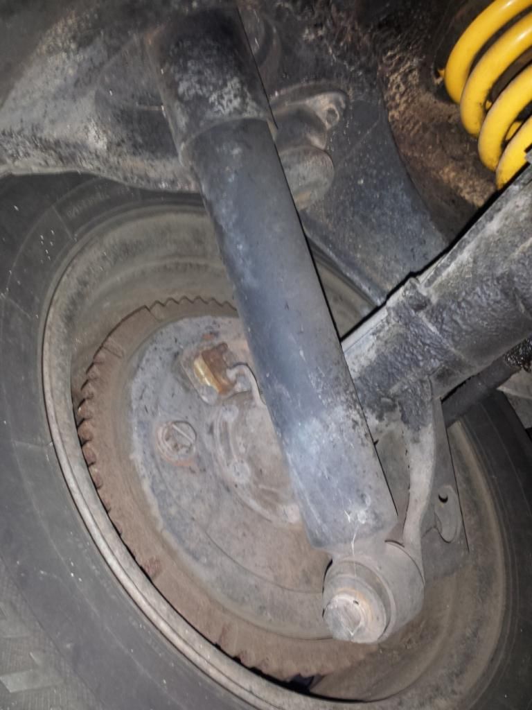

Also I've looked around for replacement bushings for the suspension but can't seem to find anything, do you guys normally use a particular aftermarket vendor for them or are they normally replaced with OEM Merc parts?
Haven't had the wheel off but it looks like a drum rear to my untrained eye

Yes Drums, they work OK though . All merc engines were balanced and if fitting a new flywheel ( not the convertor or fluid coupler ) it should be balanced to match the old one . The reason is that mercedes built a damn good engine but that long six cylinder crank will whip and crack if the damper or flywheel are swapped about . When rebuilding an engine it's normal to rebalance everything anyway .The cost is pretty negligible when using genny merc parts as everything is pretty close in weight . I have had a few (expensive) cranks rejected because of cracking and on all of them they had had different flywheels fitted,including the conversions from hydrak to manual trans on the roundies.
