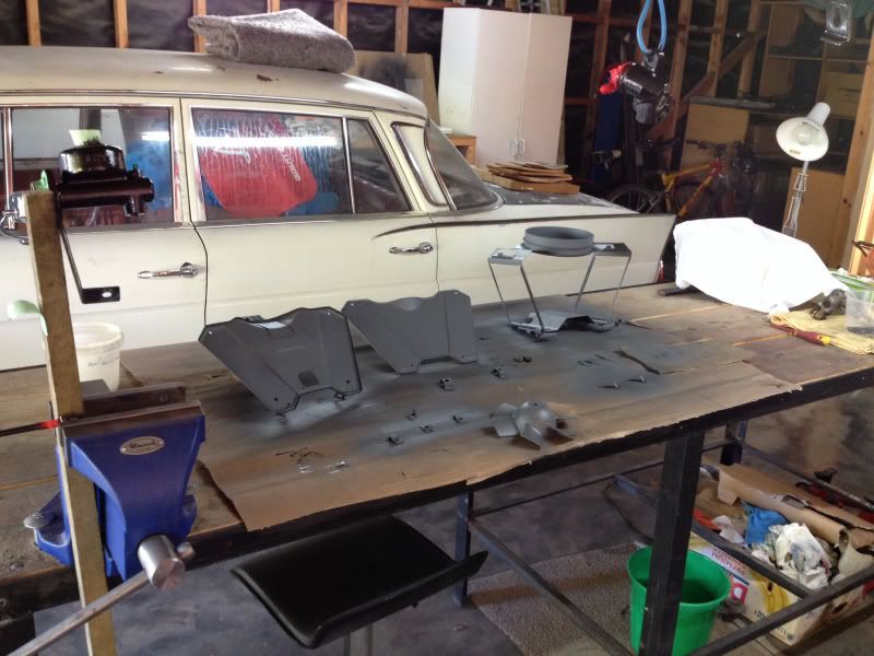

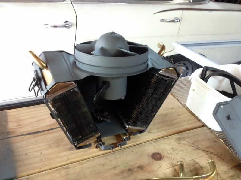

Update on the heater box progress

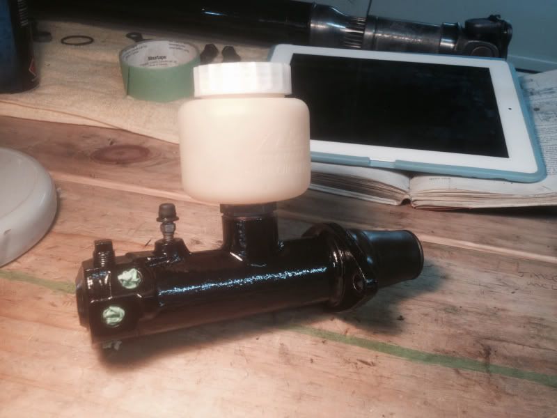

Freshened up the master cylinder too, bleached the plastic part and came up looking new
Posts: 1186
Joined: Mon 29 May, 2006 8:13 am
Re: Rotisserie Resto 220SB
Post by drew56cus » Fri 07 Feb, 2014 10:26 pm
Geez Harry, you really are rebuilding the car...
Go go go!
So what was your bleach recipe?

I used Janola bleach quite concentrated with some water and left it for like a day and a half, then scrubbed it down and it looked the dogs bollocks.

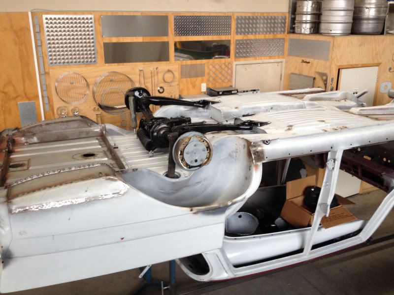

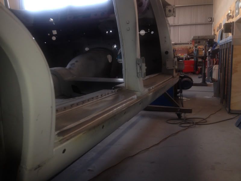

One step forward
And one back

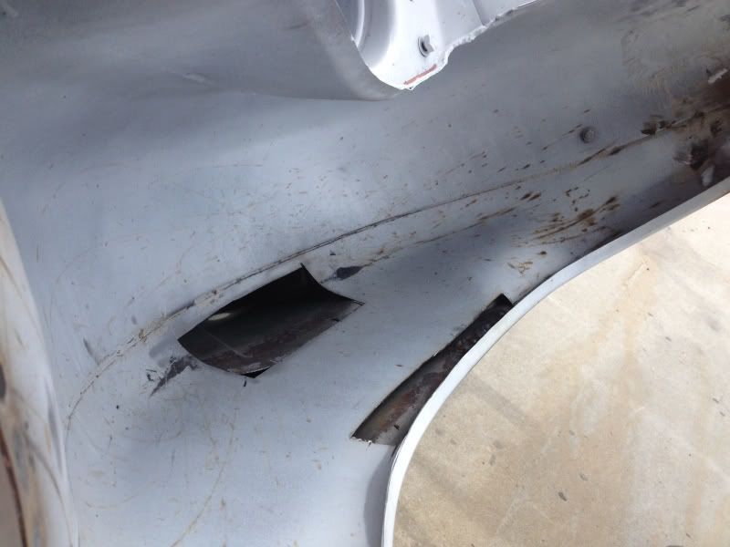

I decided to take a peek inside to see what was causing some pin hole rust spots on the rear arches and it seems those vents that were designed to drain out rain water collected around the boot hinges haven't been working too well. There's no fitting on the back of those vents, the hoses from the hinge area just sit in a cavity behind the arche and fills up with moisture, it's been getting down past the spot welds between the skins down to the lower lip too. More Repair work needed! Rather I found it now than after paint though!
Posts: 8082
Post by Mercmad » Tue 15 Apr, 2014 11:08 am
Thats in good nick ,most of those have rotted through the side of the car. :laughing6:

Really? That inner skin was rooted. She's all taken care of now though. That actually is the last of the rust taken care of now. Now for some progress

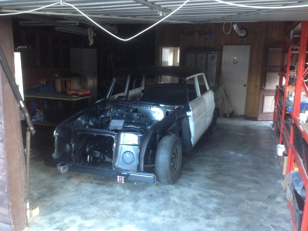

Post by harryskater_220 » Sun 03 Aug, 2014 3:30 pm

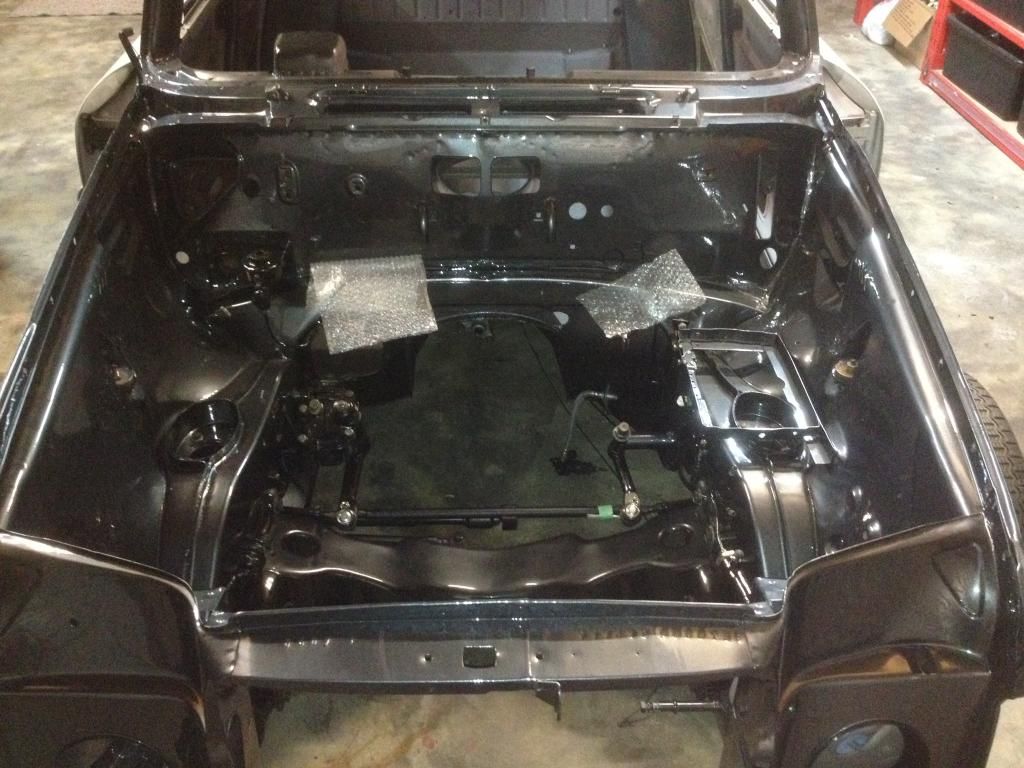

Finally some visible progress after literally years of effort. I had to pull the brake booster to bits again after realising I rebuilt it upside down! Does anyone know where I can get the fuel and brake line rubber clips from? And some of the specialised grommets for the firewall? I've seen complete sets which are totally overpriced and probably don't need half of them!
Opinions on the colour? I'm Stoked on my decision! Couldn't have been closer to what I wanted although it's not a Mercedes colour I've got a car painted in a colour I think is Awesome!

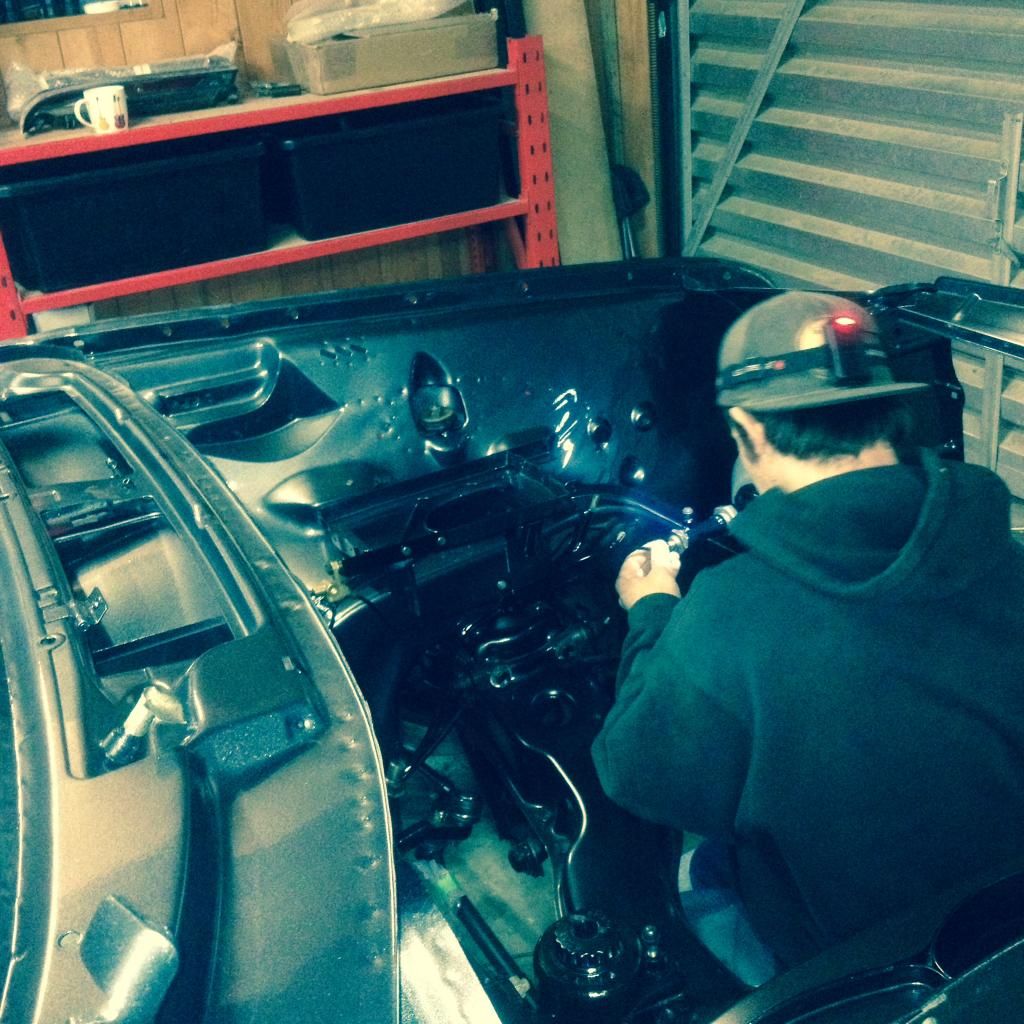

Post by harryskater_220 » Sat 18 Oct, 2014 6:32 pm
Another day in the Man Cave and a few more wires ran in and another step closer to getting the motor in..

Yesterday's Effort putting the motor back in. Went very smoothly thanks to the help of a mate and the girlfriend and not even a single scratch on the new paint job! Let's hope it's in there for good!
Posts: 1186
Post by drew56cus » Wed 31 Dec, 2014 10:26 pm
Very nice Harry! Out of curiosity, how do you lift and tilt the engine when installing? I am doing one tomorrow. I take the rock cover off and bolt my tilter brackets through a couple of the cam pedestal bolts directly onto the head. Ron uses the rocker cover bolts with the rocker cover still on - but I had one engine break a bolt doing that, which Ron reckons must have been due to it not being tightened properly. Always interested in how others skin their cats!
