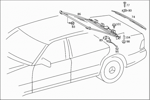

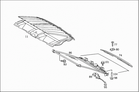

I got in touch with Mercedes Benz Sydney at the same time, and they provided me with the image attached, which I then cross-referenced with another image showing the W140 body for context.
Notice the differences in the spacer tubes (104) in the MB Sydney image, and the triangulated mount in yours?
I wonder if this difference is down to pre- and post-facelift cars. Mine's a 1991 build, for reference.
Anyway, thanks again for your help. The discussion with the engineer is much more fruitful as a result.

part number 104 is a tube spacer for the rear roller blind - it's got nothing to do with the child safety restraint anchors.
I think you need to ask them to check their diagram and ask them how they came up with a rear blind spacer part for the child safety restraint anchor...
The pictures show the group number reference where they looked up the part number
