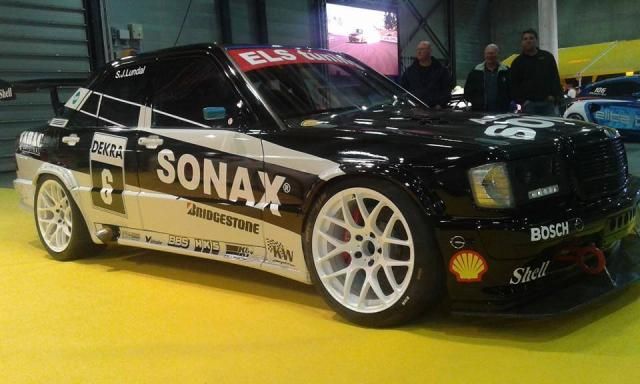

Lorinser LO's and a 16v bodykit. heheh...

Damo Cane
Posts: 32
Joined: Fri 01 Aug, 2014 8:41 am
Re: Building 190e Track day car
Post by Damo Cane » Mon 03 Nov, 2014 7:34 am
Hi Guys , no thats not our car but what we hope it will look like.
