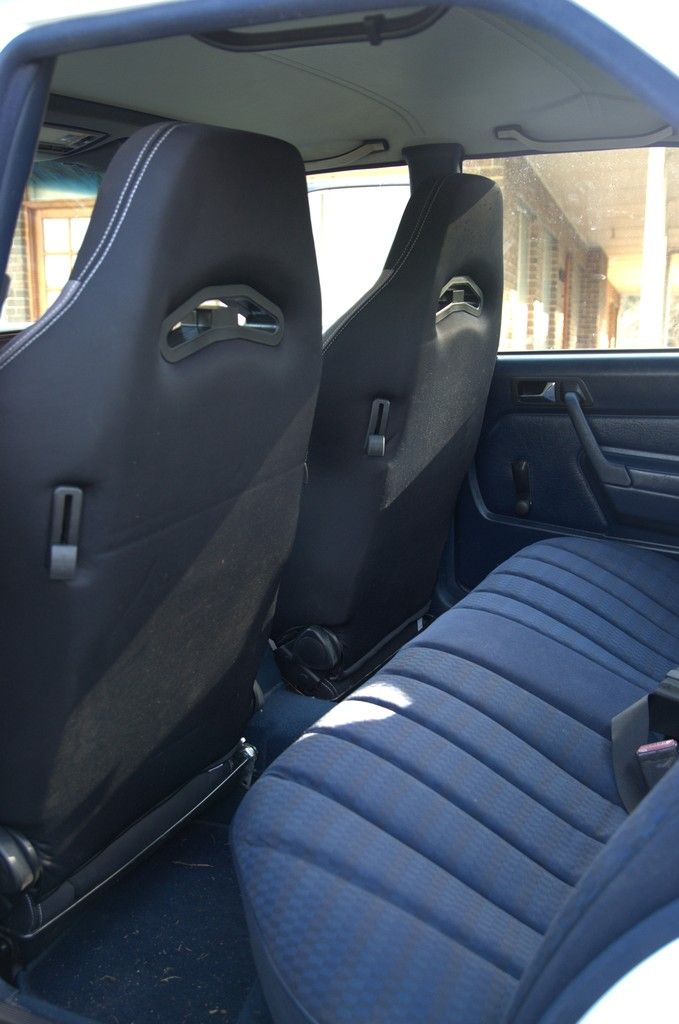

Hi,
Just showing off my new SAAS seats in my 180E 5 speed manual. This car is being used for me and my two teenage boys for Motorkhana. The seats we picked up second hand for $200 but haven't been used by the previous owner. We mounted them to the existing M-B seat base frame so they still have all adjustment functions and are at the correct height. Unfortunately this has meant we destroyed 2 M-B seats but they were very ropey anyway with the drivers having holes in the upholstery and wonky springs.
These seats have not only saved a few kilos but have made a huge difference for driver comfort and control, well worth the money and effort.

Very nice :thumbup: . They actually don't look too out of place.
And as much as I like my seats (came out of a 2.6L Sportline imported from Japan, which had the interior stripped and sold to me), even those won't be as supportive as your ones. Not only is the leather slippery, they're not as supportive as they look. But better than the worn blue cloth seats I used to have...

The SAAS seats look good. I'm looking at something like those for my red rally coupe.
Did they bolt up the original runners, or I'd you have to adapt something?
I've kept a set of runners from a car that I dismantled.

Giles wrote:The SAAS seats look good. I'm looking at something like those for my red rally coupe.
Hi Giles,
The seats were quite easy to fit thanks to M-B excellent engineering on the base frame. After removing the backrest and stripping the upholstery I cut the springs off the seat base with a cut-off disc on an angle grinder, then I was able to drill holes in the base frame to bolt the SAAS seat onto it. It was a bit fiddley with limited access from the bottom of the base frame with runners etc. The only other thing I did was to buy some flat bar steel which I drilled and bolted underneath to act as a cross member so in case of an accident the bolts wouldn't pull through the seat base frame. I used Loctite for all bolts. It was a great project and no welding required.
The only thing I will say is if you purchase aftermarket seats is to make sure they comply with ADR.
