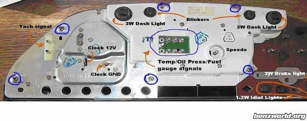

Now you have the cluster out you can see the small bayonette fittings which are the illumination globes.
If however, someone has fitted bulbs greater than 3w then they may have well melted the light refracting prisms and you need a new cluster frame.

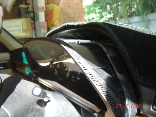

What are the chances.....the other day i blew a brake wear idiot light and thought id take a few pics as i pulled the instrument cluster out today.
My high tech tools
In they go
Out she comes (bit of effort reqd)
Electrikery!!!
Hope these pics help someone.

Great pics Simon, I would only suggest that the two tools are inserted a little further down the sides of the cluster closer to where you can see the 'louvering' on the side in your pic.
When the cluster is out, you can see a few 'teeth' behind that side part that the tools are meant to grip onto...

Post by Richard46 » Mon 04 Nov, 2013 8:42 pm
I replaced the dash globes with one high-intensity white LED mounted on top between the speedo and tacho. It involved removing the clear plastic lens, and the results were fantastic, the dim illumination was solved. While I was about it, I replaced the warning lights with high-intensity white and red LED's, well worth the effort. Cost? about $10 for the LED's and resistors. Highly recommended.
Richard
