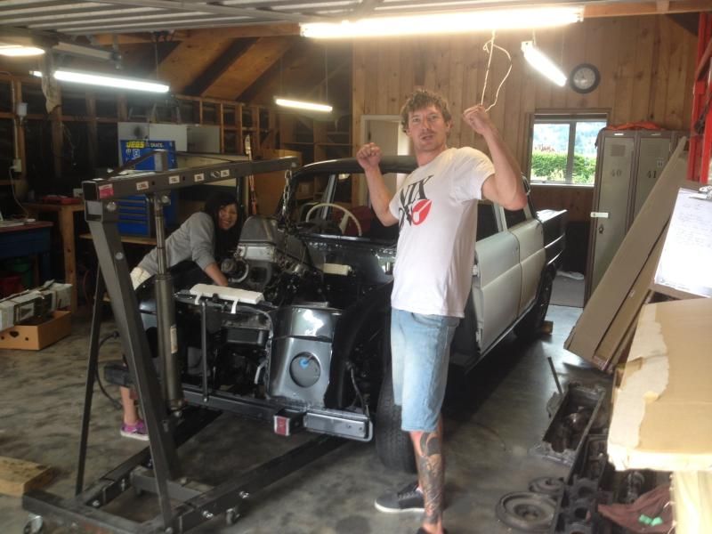

I use some strong webbing straps and wrap one around the front of the motor around the front pulley and another around and under the back of the motor.
Tie it all to the hook on the hoist or at either end of the balancer beam if you use one of these. I also use a big nylon rope as a secondary in case the webbing fails. They usually fail at the steepest angle or at the most inconvenient place.
Having said that, my webbing has never failed.
I would have thought that attaching to the rocker cover bolts to carry 400 or so kg is a bit risky, but if Ron has done it successfully ...... If those brackets that support the rocker cover distort, they would have a pretty big chance of coming in contact with the cam.

How u going with the motor Drew? I tied the motor in three different places- a chain bolted to the front of the motor with m10's I think and two tie downs, one in front of the bell housing and one where the gearbox meets the bell housing. I just adjusted the tie downs longer than the chain so that it lifted off the ground on around a 45 angle. It took a few goes to set the angle I wanted then it was a case of inching forward and lowering down until the gearbox flange was in the tunnel then had to get my mate to put a bit of force against the motor to create a bit more of an angle so that the gearbox wouldn't hit the firewall until the sump had cleared at the front then again with the inching forward and lowering down. 3 people are key for getting it in nicely I found. I had the lady watching on the left and stabilising and my mate on the right getting the angle of the dangle right and I had the easy job of just lowering it In!

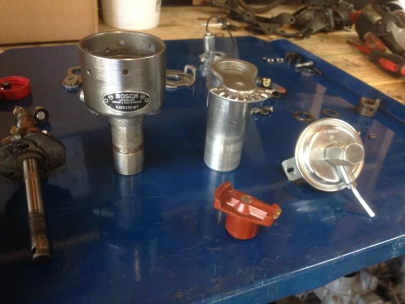

Today's work stripping down the distributor and cleaning up the hundreds of tiny pieces and my mate and girlfriend in the other picture getting the motor in

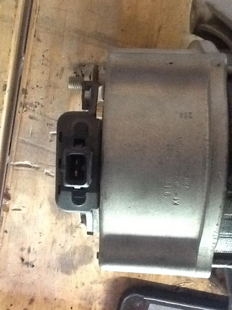

Would any one happen to have an electrical plug to fit one of these new school Bosch Alternators? I bought this one already reconditioned but no plug to go with it. It's a higher output Alternator than the original generator to keep up with the electric compressor which powers the air suspension.

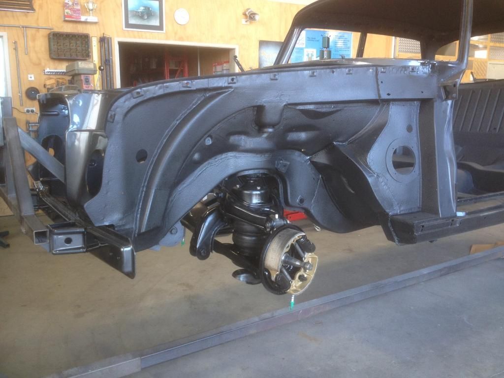

A snap of some (very slow) progress over Christmas

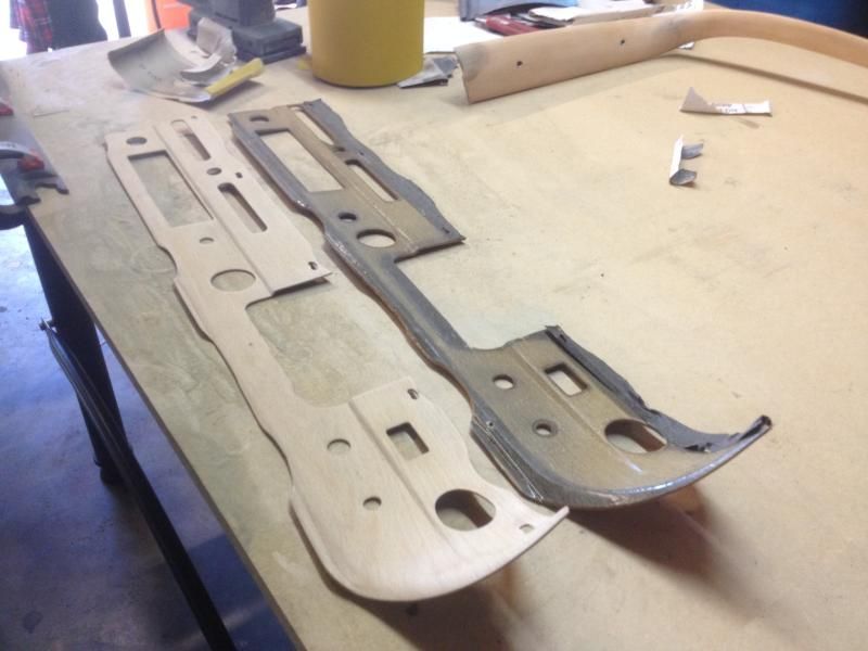

Curious as to how you obtained that pristine looking dash veneer. Is it a custom job? Will look very nice when the dash is all back together.

Jeremy, it was just a lot of tedious sanding, I hit it with 100 grit to get all the flakey varnish off and worked finer til the dark patches were gone, I've gone a little deep in places and will need repairing before I give it the final varnish but it's looking better than it was so I'm happy.

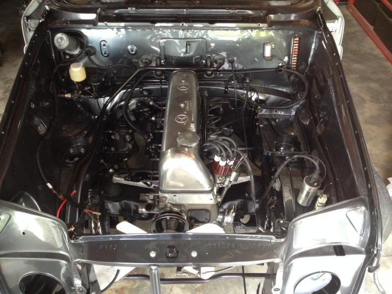

So i got the 62 finny driving last weekend!
Brakes and clutch bled and working beautifully.
Not running beautifully though as a bit of tuning required once exhaust is complete and air cleaner back on but pretty happy to get to this stage.
Next is paint for the remainder of the body and panels and now trying to track down new seals- i need everything besides front and rear windscreen seals. would anyone have a good contact? The windcreen seals i got are URO and seem to be a very good quality...

Post by harryskater_220 » Mon 13 Apr, 2015 7:22 pm
Anyone seen one of these before? im guessing its a home made contraption.. Looks like someone has spent a lot of time making it!
Its been made to fit into the space between the front seats as a storage box. Just thought id share that with you lot as i just found it after being stored away for a couple of years
Posts: 1811
Re: Rotisserie Resto 220SB
Post by Bartman4800 » Mon 20 Apr, 2015 6:19 pm
Looks a bit like a coffin Harry.
It's nice and the craftwork is impressive.......but I would not put it in my car. :sad1:
Have never seen it before though, might fetch a few bob on Fleabay....

Post by harryskater_220 » Mon 20 Apr, 2015 7:03 pm
The old girl before going for the rest of the panel & paint last week!
Things are gonna start coming together pretty soon!
Posts: 1811
Post by Bartman4800 » Mon 20 Apr, 2015 8:30 pm
Those 2 Webers look quite impressive! Rest of the car does not look too bad either :bom: :jokercolor:
Did you coat your cooling fan or did you polish it?
My experience is that after polishing, it starts to corrode straight away...
