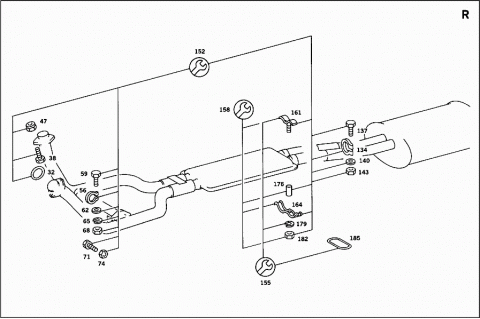

I meant to answer this the other day, the rubber ring in the middle of the car is still there? It's a big thing that holds the exhaust on two hooks.
Ron, I had a look. I don't think there is anything else supporting the exhaust except the 4 rubber figure 8's (2 on either end of the muffler).
Perhaps that is why my rubber rings fail at such an alarming rate?
Can you point me to a diagram so I can check for sure?
A1094920082
A1094920543
A0004921683
A1094900343
A0004920053
These are the part numbers for the ring ,bracket etc. MB's sghould either have used ones or new ones for you. and yes that will cause the rear rings to fail .Image
