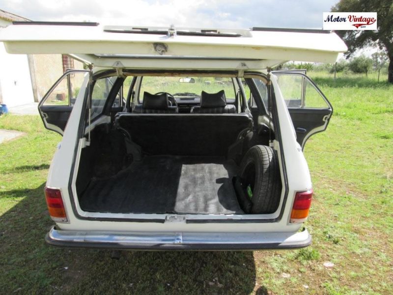

Hi all,
after 9 months and with a lot of help from my Argentine friend (without him it would be impossible), the W115 pickup is finally bought ... still in Argentina:
Additionally I bought a W115 "rural" station wagon, our local club here takes it. As they both fit in one container, we share the shipping cost.
Once it's here in Germany it will be stripped down completely, welded and the planned V8 conversion starts. At the moment I have two options, I will follow from next week on:
1) Get the SLC front and rear axles and a W126 500/560 SEC donor car for motor gearbox etc.
2) Get a pre-1985-facelift R107 500 SL and everything bolts in ...
I'm pretty excited now and I hope those cars arrive safely in Germany ....

to shorten the waiting time for the cars (still not on the ship), I received some photos ... as you can see a lot of work is waiting :banghead: ... I can already start looking for a dashboard, new door cards, rear lights ... anyway, hope dies last :laughing6: ... car has been converted to floor shift, but still has the bench in the front ... happy gear shifting :laughing6:
Best regards

Post by Mercmad » Mon 21 Sep, 2015 8:39 am
Argentina is great example to those who follow Ozlabor politics . From a wealthy country in the 19th Century with full industry and infrastructure to a nation of the very rich surrounded by the destitute who pay enourmous taxes to support the rich and the government. Don't expect the bureaucracy to move in a big hurry there. :pale:
i hope you have a reliable contact there. it looks like another in the same colour for sale too.

Post by pastelgrey300D » Mon 21 Sep, 2015 12:35 pm
^^^ That beige wagon looks really nice! A really well done conversion! Not so sure about the red one...
Posts: 7993
Re: W115 Ute Project starts ...
Post by Mercmad » Mon 21 Sep, 2015 2:46 pm
I think the beige one is a Crayford conversion but the red is a Mercedes Argentina job.
heres another version also Argentine but with a lower roof profile.
Posts: 2630
Post by T-Modell » Mon 21 Sep, 2015 5:01 pm
I'm pretty sure, the red one is NOT from Argentina; there's much more than just Crayfords ... Binz, IMA, etc. Here's a photo of "my" rural I bought in Argentina:
You can be assured that we do everything we can to get the cars out. Nothing is easy at the moment there. Things change from year to year, soon there are elections and the economical state there isn't easy either ...
Edit: This is the IMA brochure ... Image

Posts: 7993
Post by Mercmad » Tue 22 Sep, 2015 5:46 pm
if you look close at the beige one,it has the crayford rear door (Ford Granada ) and the tell tale symptoms of plastic filler in therear 1/4's. They built over 300 of them too. But if you need a few hints on how to V8 your ute... do it American style with a pick up chassis :error:
