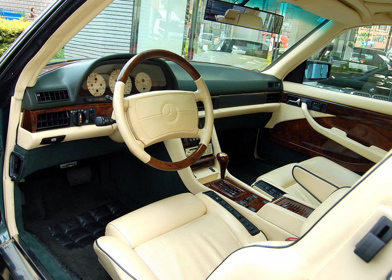

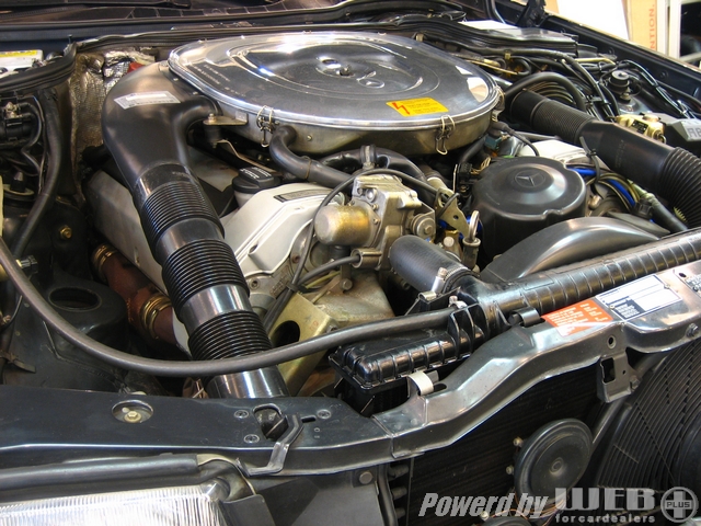

Heres another AMG conversion which was for sale in the USA a few years ago. (2008)
These are M119's not AMG M117 conversions.
I guess the bloke you are talking about is in Ryde?. Not much point paying top dollar for work you can do yourself.
I would sooner just build manifolds than try and re-engineer the steering as AMG did when they did this conversion
