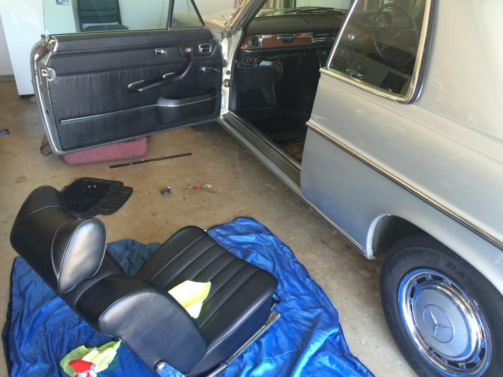

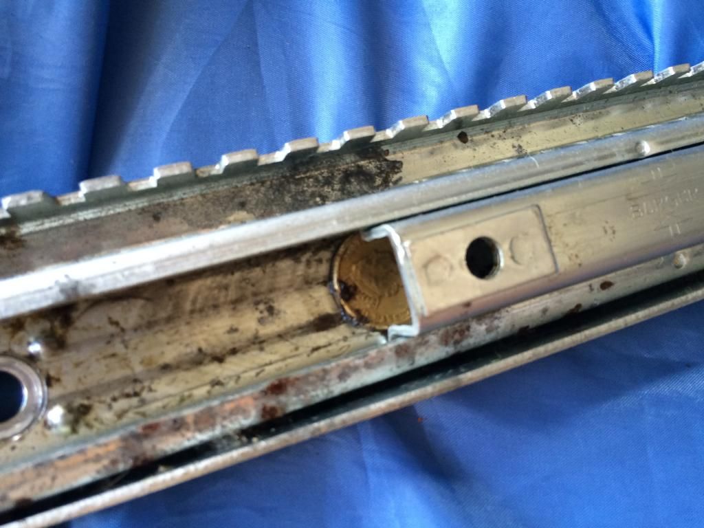

Post by edenning » Mon 03 Nov, 2014 11:30 pm
After a 100 km round trip cruise yesterday along the coast, I thought it was time to repaint the stone chipped eyebrows on the fog lights. Disassembled, sanded, primed and repaint, along with polishing the chrome surrounds, they look much better. Although I thought the car had cleaner more masculine lines with the fog lights off.

Today I pulled the seats front seats out of my w114 280CE. They were getting very hard to adjust forward and back, In fact they were so hard to adjust I just didn't even try any more.
I took the seats out and gave them a good wipe down while on the garage floor. Then I took off the runners, gave them a good clean, lubed them up with some silicon spray and back on. At least that was how it went for the passenger side which i did first.
When I did the driver side even after cleaning and spraying the seat runners it was still incredibly difficult to move forward and back. On closer inspection there was a $2 coin stuck in one side of the seat runner. With a bit of fiddling and cursing and hammering I manages to get the $2 out. Amazing, the seat slides forward and back easy and smooth, just like it should.
So, put the drivers seat back came to tell you about it. :)

Nice work, ah the joys off owning a car that is 30 plus years old. Did the same to one of mine a few months back. Makes a huge difference, it makes me wonder why people leave the relatively easy fix jobs untouched.
