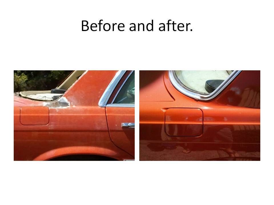

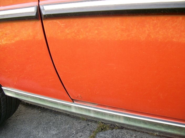

I did the same to 3 of my doors some time back.
Its a simple job but time consuming.
If I was to have my time over, I would have just replaced the doors and had them painted to match, however I was also having done rear boot wells and rust in the passenger side floor as well as the rear window sill and cracking paint on the bonnet.
You say you were quoted 2-3k......... Unless you are doing more than a couple of doors, then this price is excessive. (I paid 2k for all the work mentioned above).
Sounds like you are being told "we really don't want to do this".
I had the same experience and some of the quotes were much higher. I soon realised most body shops were not interested and most didnt have the expertise. (Most prefer "take off and replace the panel" jobs)

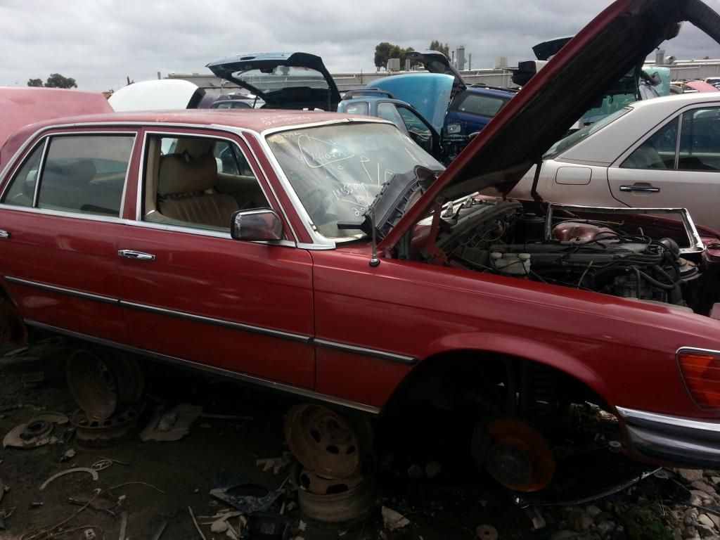

There are plentiful front and rear doors around at the wreckers (here in Melbourne at least) and the going price is $120 -$150 each, complete with glass and furniture.
Surprisingly the guys that did my car were taxi repairers. Guess what they do all day?......Panel beat, straighten, weld, smashed up taxis. This was 2nd nature to them.

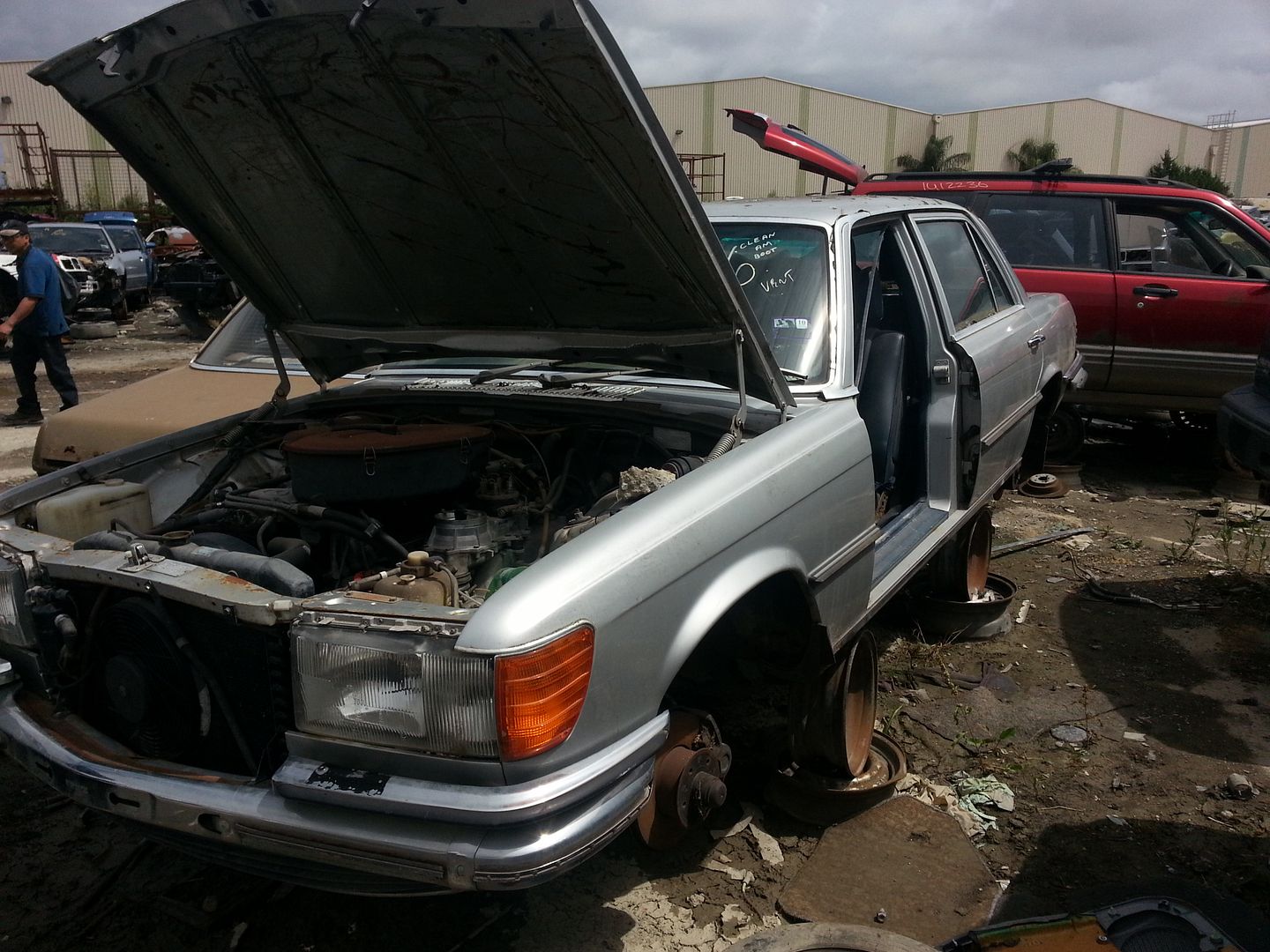

The 1st 3 pics are of my car with some of the repairs I had done.
The other pics shows a local wrecking yard a few weeks ago.
Good Luck
Below some pics from a local wrecking yard

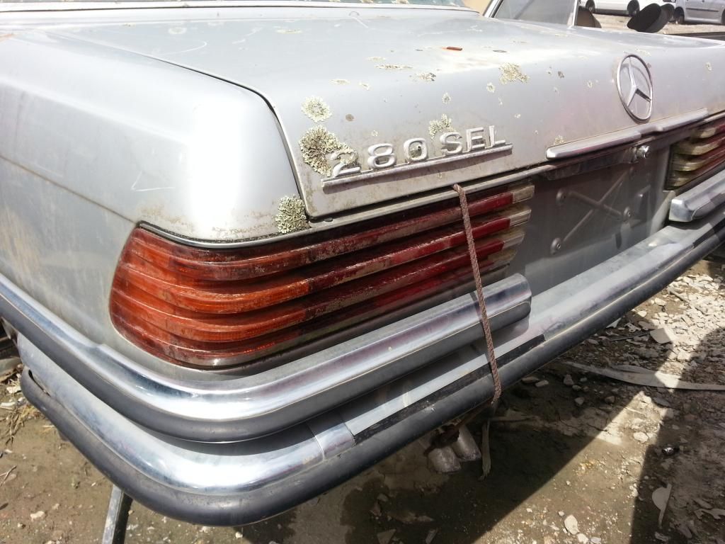

lichen growing on a car in OZ in unusual. It must has sat somewhere for a long time. :laughing6:
McGavin
Posts: 394
Joined: Tue 26 Nov, 2013 3:34 pm
Location: Gippsland Victoria
Re: Rust repairs
Post by McGavin » Thu 16 Jul, 2015 8:30 pm
Mercmad wrote:lichen growing on a car in OZ in unusual. It must has sat somewhere for a long time. :laughing6:
Dodge truck sitting at home covered in it, like spearmint green shag pile carpet. :)

Post by mrkozzy » Sun 02 Aug, 2015 8:00 pm

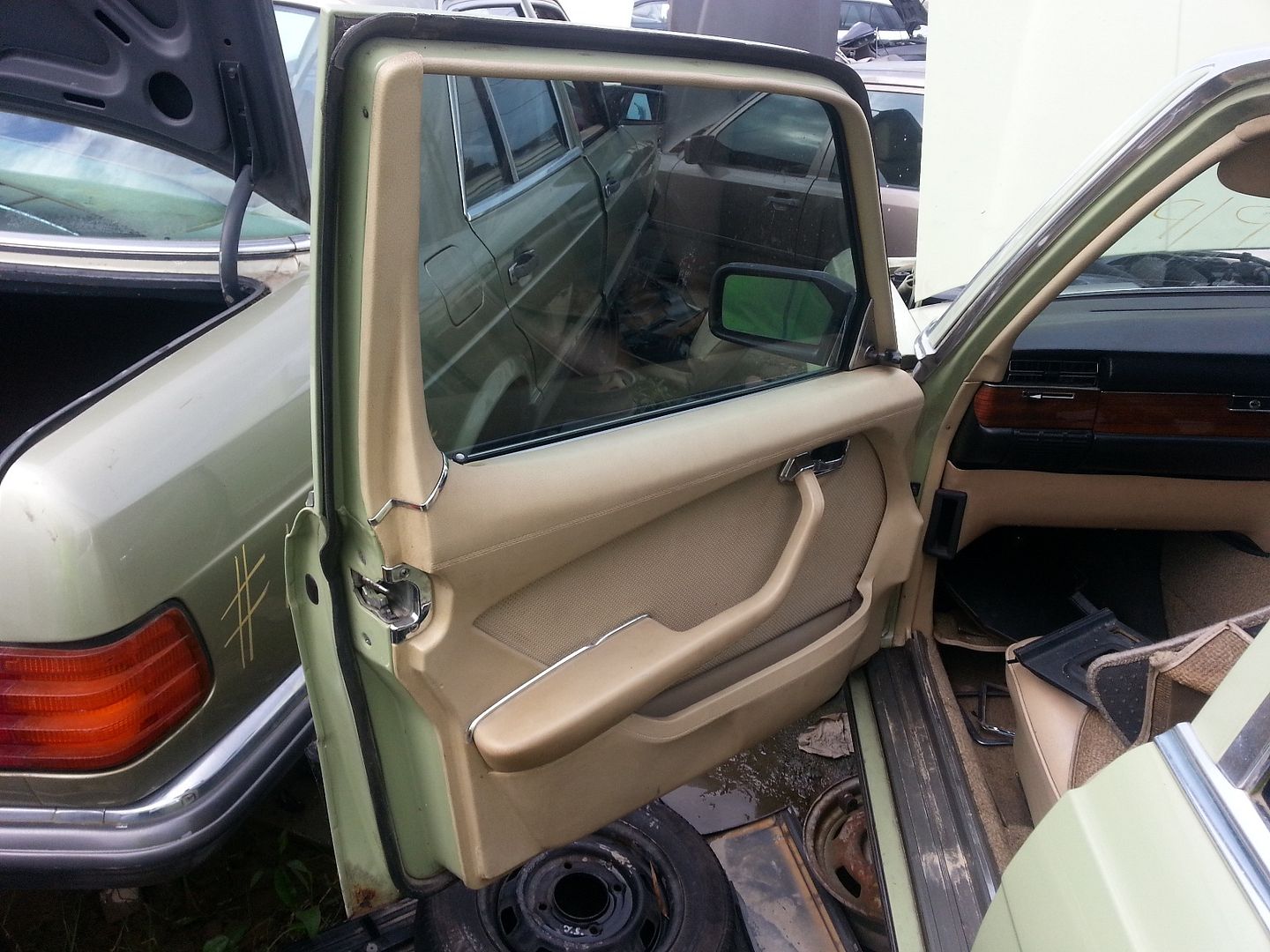

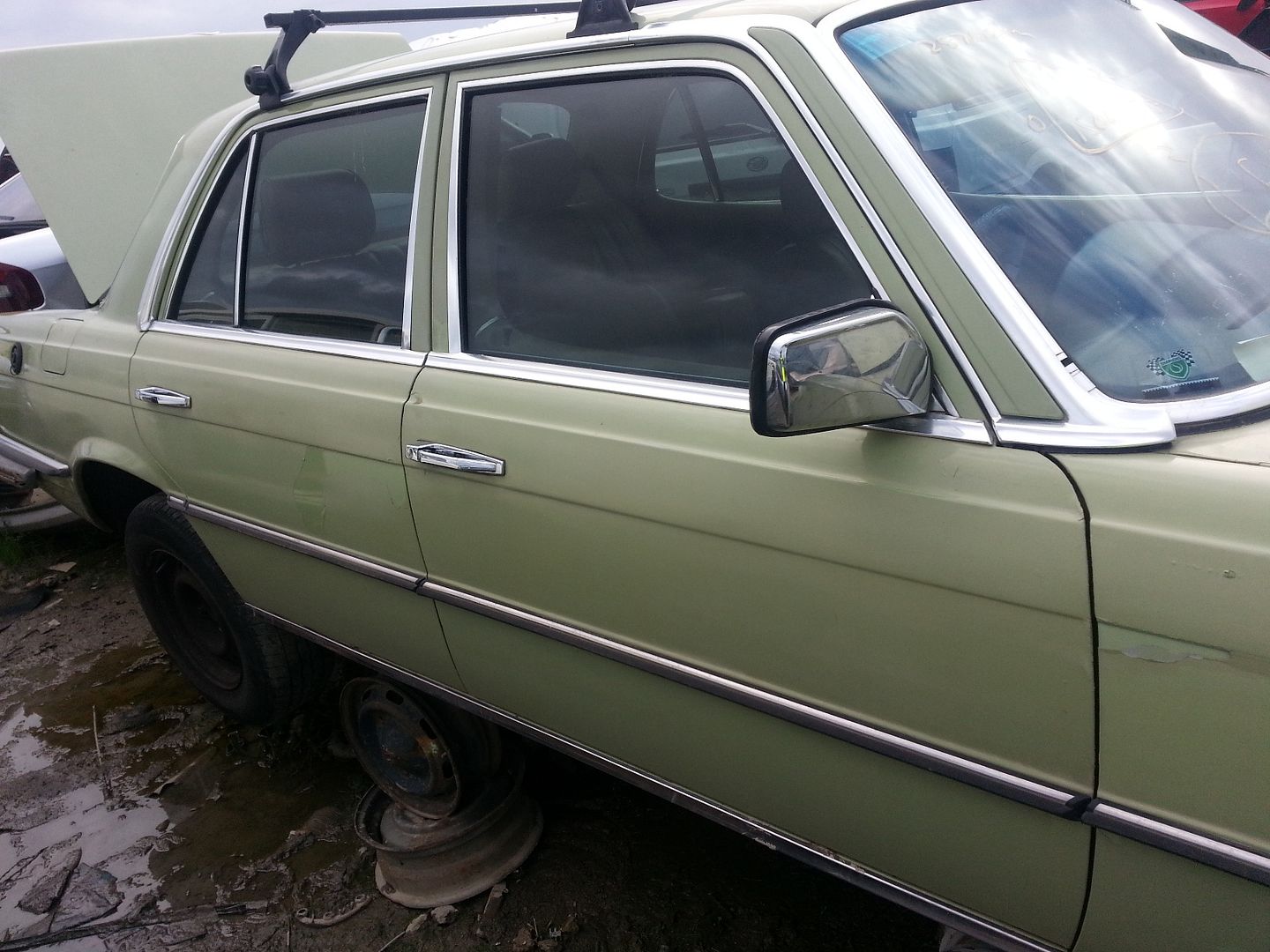

116 just came in last week to the local wrecking yard. (Springvale)
All the panels & Doors are in VGC.
Passenger front door has a small internal rust spot (see pic) but nothing too drastic. Surface stuff mainly.
In fact this car is mostly intact if you're looking for any other bits.
They were asking $120 for each door..as is...( I gather that means all door hardware, door trim etc etc )
At the moment it is the only 116 on the lot.
Seems to be the turn of the w126 to go through the crushers and recyclers. There were 6 of them parked next to the w116.
