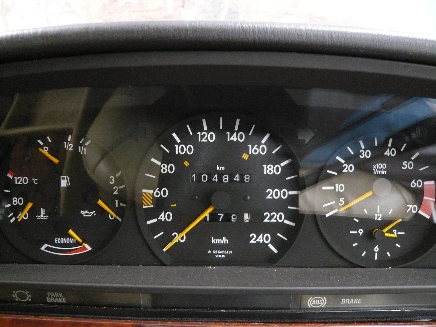

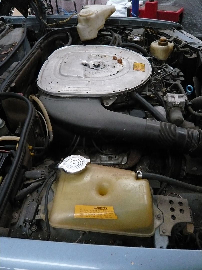

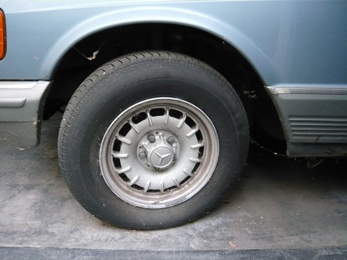

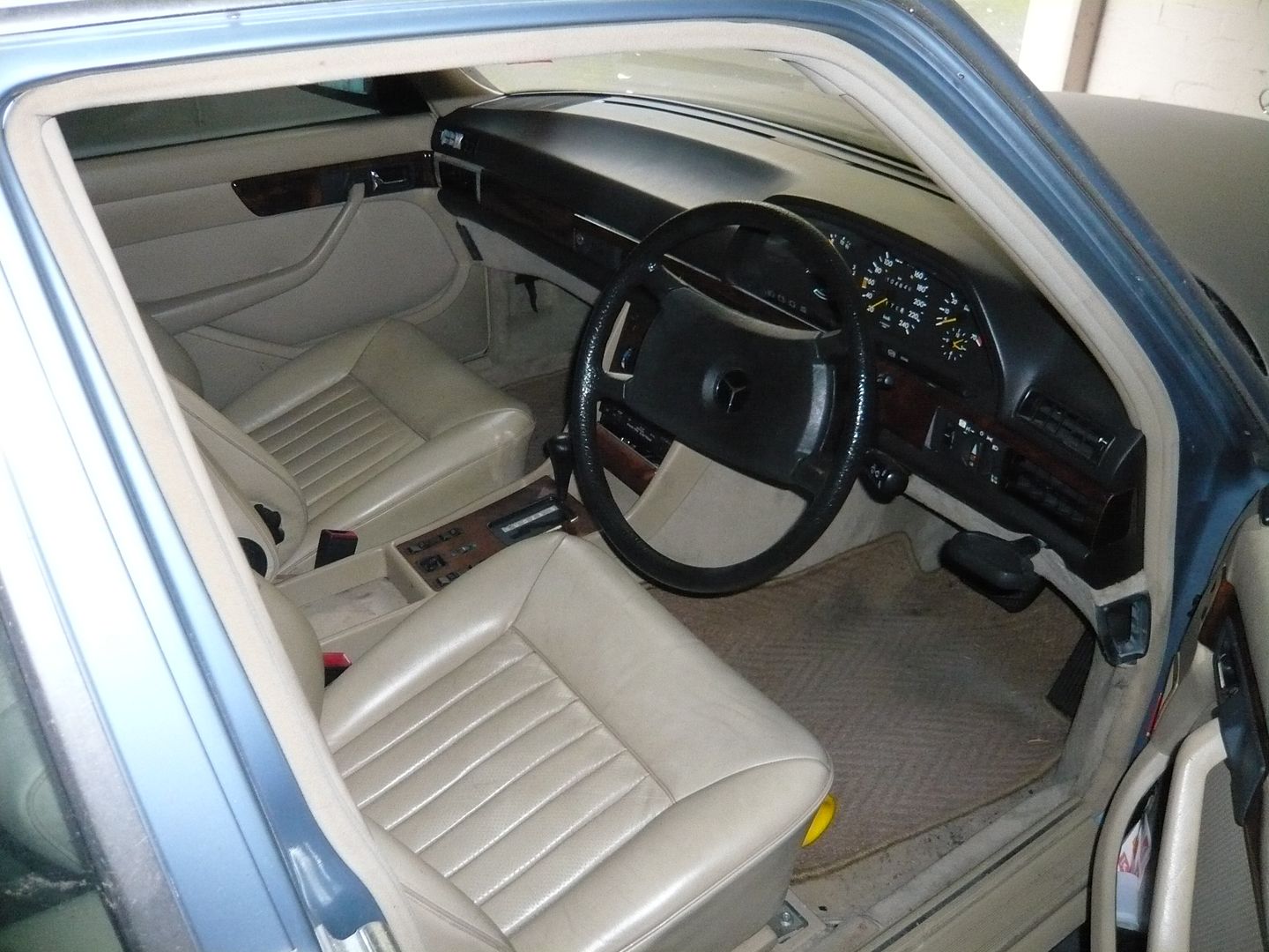

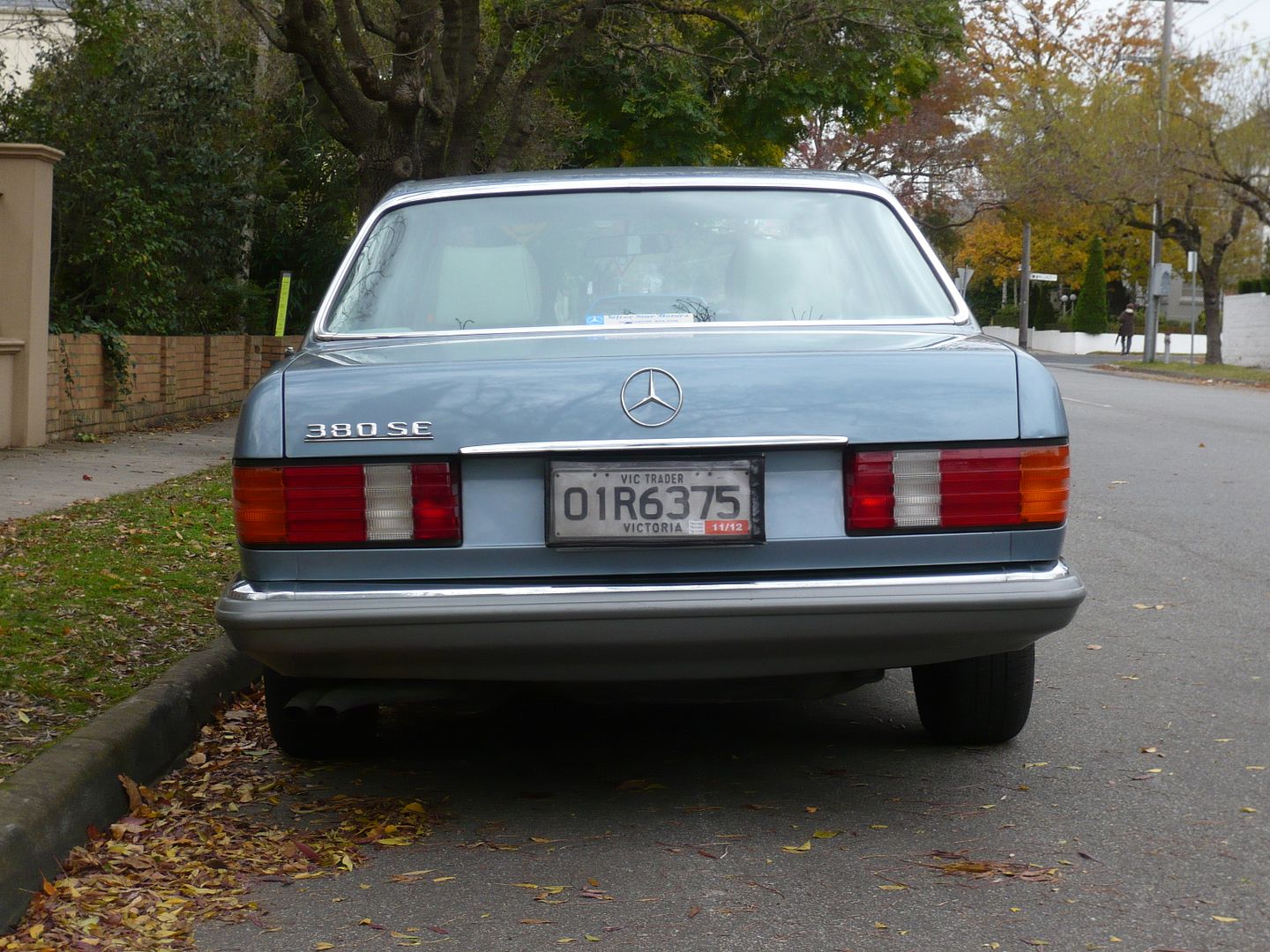

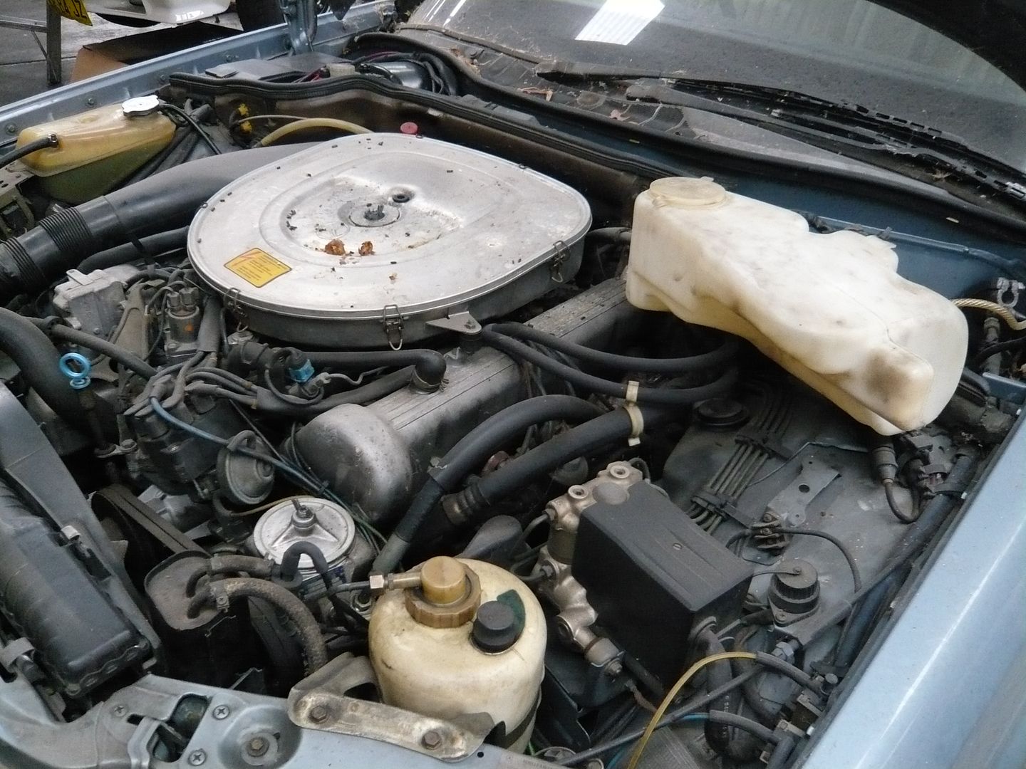

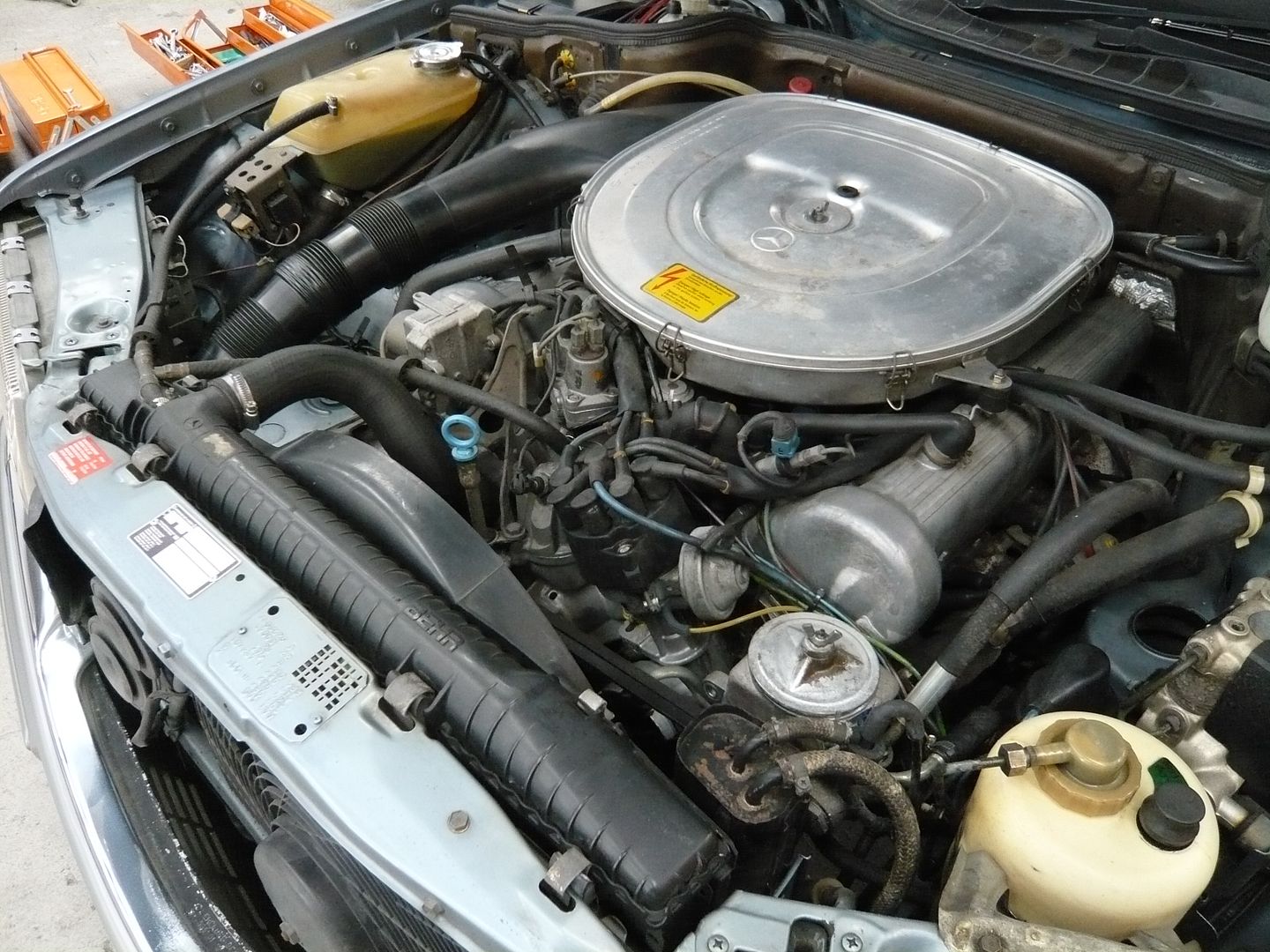

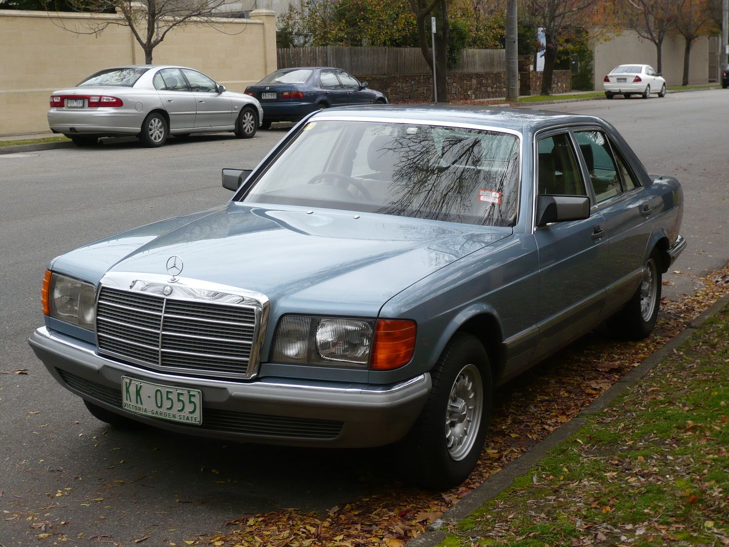

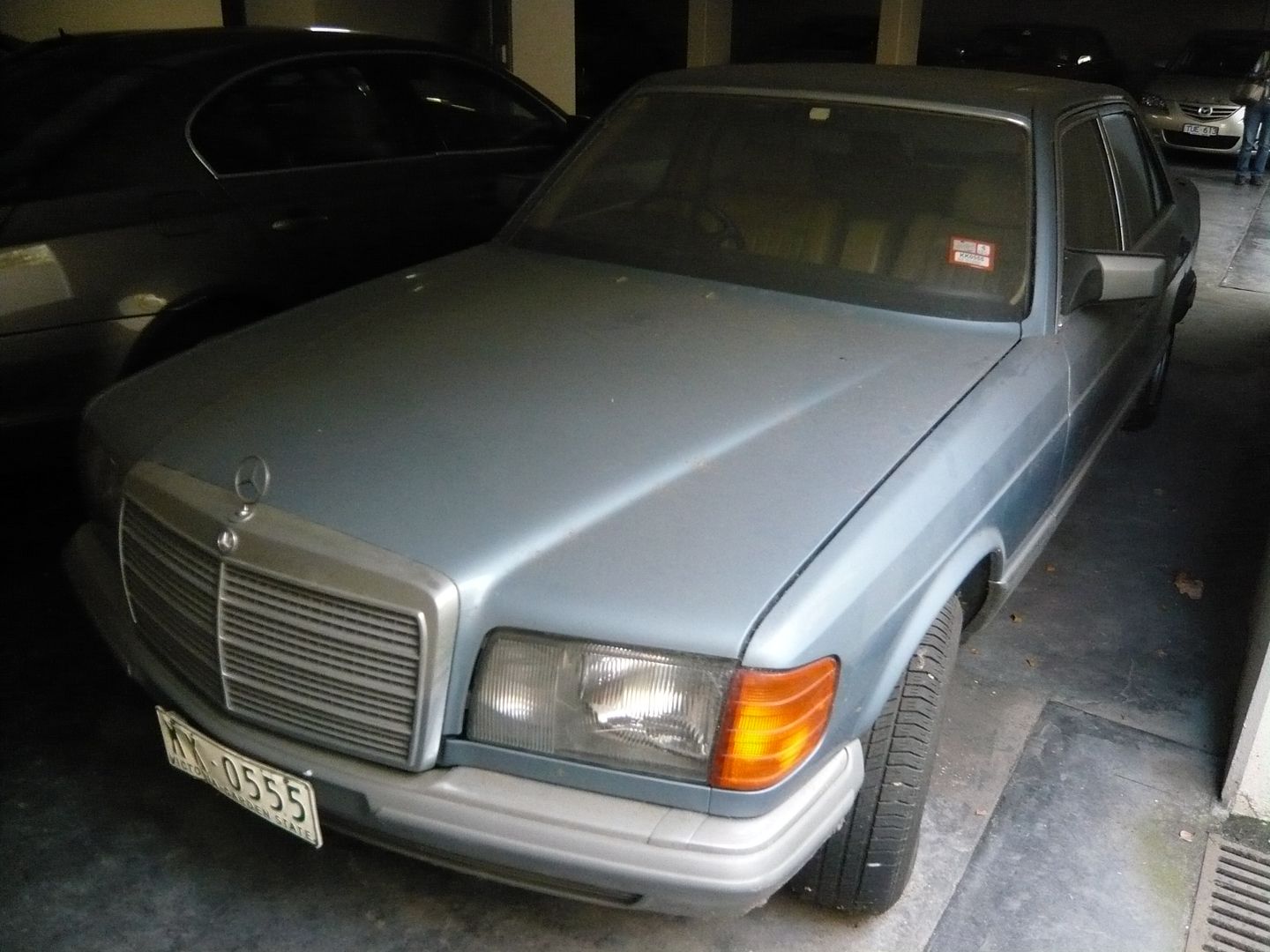

I found a 1985 Australian delivered 380 SE for sale one block from me. One owner, deceased estate, 104,900 kms. Sounds OK so far, but hadn't been driven for 8 years, and 3 months. Just been sitting in the basement of an apartment block...........with one of the rear windows part down. The poor thing was absolutely filthy both inside and out. Coverered in cob webs, a spiders nest under one of the rear floor mats, snails stuck to the air cleaner box and cam covers. There was an alarming quantity of mice poo distributed under the car. I had to make a decision on the spot whether to buy the car. I had no opportunity to test it so the engine could have been damaged for all I knew. The late owners daughter was keen for the car to end up with an enthusiast and not parted out or scrapped, but she wasn't sure it it ran when it was parked, but it was reasonable to assume that it did. Cosmetically it looked OK, some scrapes on the bumpers, a swipe in the DS rear wheel arch, two dented skirts and oddly, some timber veneer missing from the glovebox lid and LH vent vent surround. Anyway, I took the risk, said yes, and picked it up last week.
Some pics as I found it:
I didn't dare try to start it at the pick up address, so had it flat topped to my garage. I noted in the service documents the last service was 437 kms prior, so at least the oil was reasonably fresh when it left standing. The fuel tank was on reserve, or so the fresh battery suggested, I put in 20 liters of fuel. Then pulled out the plugs, squirted a decent quantity of both Wuerth Rost Off followed by Wuerth synthetic grease from an aerosol can down the bores. I turned the engine over by hand for 5 revolutions. Replaced the plugs then cranked the motor for one minute (Two burst of 30 seconds, I was scared of burning out the starter!) with the fuel pump relay removed. Oil pressure gauge flickering warmed my heart (Along with seeing oil on the camshaft lobes through the oil filler hole).
I replaced the fuel pump relay and cracked off the supply line to the metering unit and was pleased to see fuel leaking from the union after cranking the engine for two seconds with the ignition disabled. Now connected, I cranked the car and it fired first time, but died after about a second. It needed to be cranked another 30 seconds before it finally started. First on 7 cylinders, then all 8, and settled down to a smooth idle. I let it run for about 10 minutes, feeling very happy.

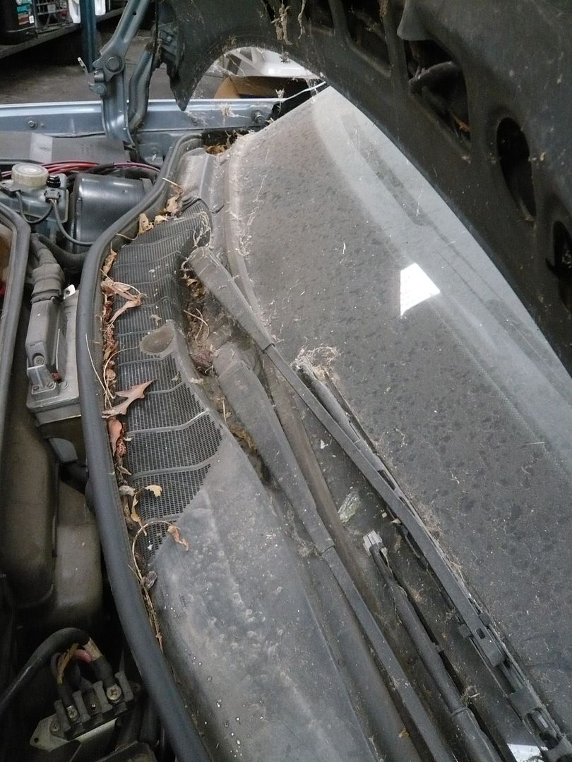

First job was to clean it, it was the filthiest car I have ever cleaned, just disgusting. I will need to shampoo the carpets ultimately, but I manged to wash off the more stubborn stains by hand, and of course the interior was covered in a fine layer of silt. I washed the interior with soap and water. So my first drive was from the back of the garage to the front, about 25 meters. I was nervous about the brakes, but it had a pedal which was a good start. And it pulled up at the end of the drive, lucky. This is how it turned out after two days of vacuuming and washing:
I changed the brake fluid (That was foul, the initial fluid bleed appeared to be like treacle) so I hope there are no corrision issues in the caliper bores, but I would be surprised if not, really. I will do a fluid and filter change for the engine, transmission, power steering and change the differential oil and coolant. Along with a host of other deferred maintenance jobs. I am particularly worried about the transmission, lets see how that works out. The 2/3 and 3/4 changes are seamless, but the 1/2 change is hard shifting. Lets see if a fluid and filter change helps, perhaps a modulation pressure adjustment miught be in order. And it seems very keen to down shift on a moderate throttle too.
So far everything works except for the pneumatic height adjustment for the headlights along with the air conditioning, no surprise on the air con, but I dislike inoperative things, so the headlights need further investigation. And the cosmetic issues will drive me nuts, but I must do the mechanical items first. The tyres are 12 years old, and would be binned anyway, even if they were round due to age (They feel somewhat square!) and today I ordered a set of Michelin XWX 205/70-14 which was painful financially. I won't have a chance this weekend to do much, but I plan to get into it the following weekend. More to come later no doubt.

I've been playing a little with the 380. The car died on me last weekend. I'm not surprised poor thing, I was driving to the workshop and it stopped. I managed to restart it and make it to the shop. Further investigation revealed the fuel injection metering unit had seized in the wide open position!
Have a look at the varnish on the base of the fuel distributor, disgusting, and I had to lever the metering piston out with two screwdrivers, it was stuck solid. Wuerth Carburettor cleaner to the rescue!
I would have preferred to the split the fuel distributor halves however I did not have a gasket, and I had to move the car that day. After mixture set up, if the car is not smooth, I will remove the fuel distributor again and rebuild it properly. I have a friend at Bosch who can help me with a K-Jetronic test bench.
And after cleaning:
While the other pieces were soaking, I had a little clean up of the exposed parts:
And all back together:
More later.....
Carl.

OK, back to work...
I see the distributor advance mechanism is connected to the inlet manifold via a solenoid operated valve. I understand that the purpose of this is to retard the ignition in 3rd. and 4th. gear. Can anyone confirm if it serves any other function? In the following image, the solenoid valve is the one closest to the camera.
And look at this disgusting device:
It fell off, sadly:
Notice the kink in the lower radiator hose? Does anyone have a U.K. specification 380? I would be curious to know if this lower hose is shorter for these models, as it is not necessary for the hose to clear this tool of the devil.

carl888 wrote:OK, back to work...
I can't speak specifically for a W126, but this is common for cars of this era as a simple strategy to reduce emissions.
The sad part is that it increases fuel consumption.
Imagine that! Reduce emission by burning more fuel... Car makers struggled in the 80's to adapt emissions equipment to existing motors :)
Correction, the solenoid that affects vacuum retard is the one farthest from the camera. I can also confirm that in 3rd. and 4th. the ignition is retarded about 4 degrees by this device. I assume this is to reduce NOx emissions at the expense of fuel comsumption. (Added to the already retarded ignition settings for the Australian cars).
Can I ask other Australian 380 specification owners to have a look at their distributor please. I would like to know if any have the vacuum advance mechanism connected. The vacuum retard is the line connected to the diaphragm on the INSIDE. The advance mechanism is the line on the OUTSIDE.
On my car at least, that appeared relatively unmolested, the vacuum advance was not connected, and I could see no evidence of a vacuum line where it may be so. Curious! The manual I think is wrong, it says it should have the vacuum adavance circuit only. Any ideas?

Here are the results of some work today. Today I disabled the vacuum retard, EGR and as you've seen, the air pump. I connected the vacuum line from the intake plenum (The fed the vacuum retard circuit) to the vacuum advance mechanism. The advance mechanism made some groaning noises as it was energised, very funny, being brought back to life after 27 years sleeping.
I then disconnected the vacuum advance again and set the timing at 750rpm to an amazing 10 degrees BTDC. Fuel is 95 RON. I was expecting detonation but an agressive road test revealed none. I was surprised at this figure, however I may have to be careful in warmer weather, it was just 9 degrees when when I did this. I then reconnected the vacuum advance and road tested the car. At 750 rpm with vacuum connected advance was 25 degrees. With the advance connected, the idle is smoother, that is the only difference I can detect so far.
The car is much improved. The throttle repsonse is very quick, it's lost that lazyness that it had before and the mid range flexibility is noticeably better. I am very happy with the performance.
The only issue I have is a very agressive cold idle. For the first two minutes the car will idle at 1,600 rpm, which is too high. If I disconnect the advance mechanism (Making sure the hot idle speed is re-set) it idles nicely at 1,100 rpm when cold, which is where it did before. So I am curious how high the cars with the advance circuit only idled?
I am thinking, it would be very easy to incorporate a 50 degree thermo vacuum valve in the advance circuit to disable it during the warm up phase. In fact, this valve is already in position and not being used (Was for the smog pump). However I do not see any such device in the vacuum circuit for the cars with the advance mechanism, so perhaps I simply have a control pressure imcompatibility as the Australian engine does not expect the advance circuit to be connected. Would anyone care to comment about this cold idle issue?
carl888
Posts: 517
Joined: Tue 08 Aug, 2006 11:15 pm
Region: Victoria
Re: 380 SE
Post by carl888 » Wed 13 Jun, 2012 12:51 am
The first picture shows the engine as it was originally. You can see the rubber hose that supplied filtered air to the air pump exiting the the RHS of the air cleaner and down past the top of the cam cover to the pump. The following photos should be self explanatory.
