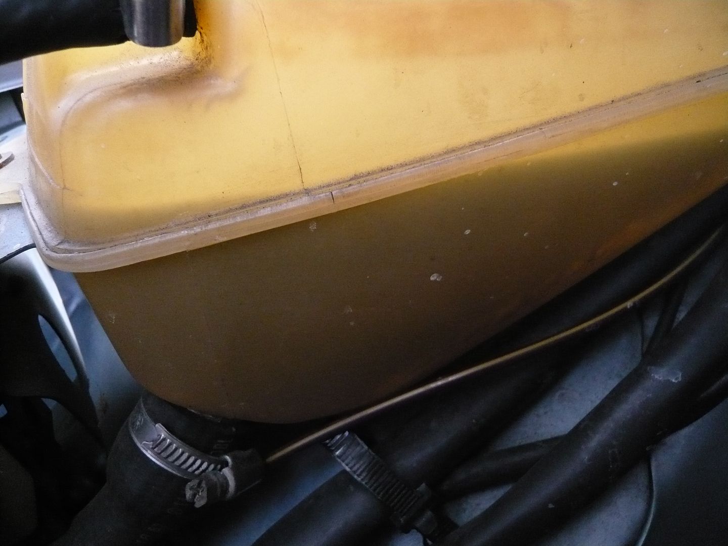

Also, I have these hairline cracks in the base of the header tank. They appear to be internal, but it doesn't look good for long term integrity of the tank. Anyone else seen this? Thanks for any information.
carl888
Posts: 517
Joined: Tue 08 Aug, 2006 11:15 pm
Region: Victoria
Re: 380 SE

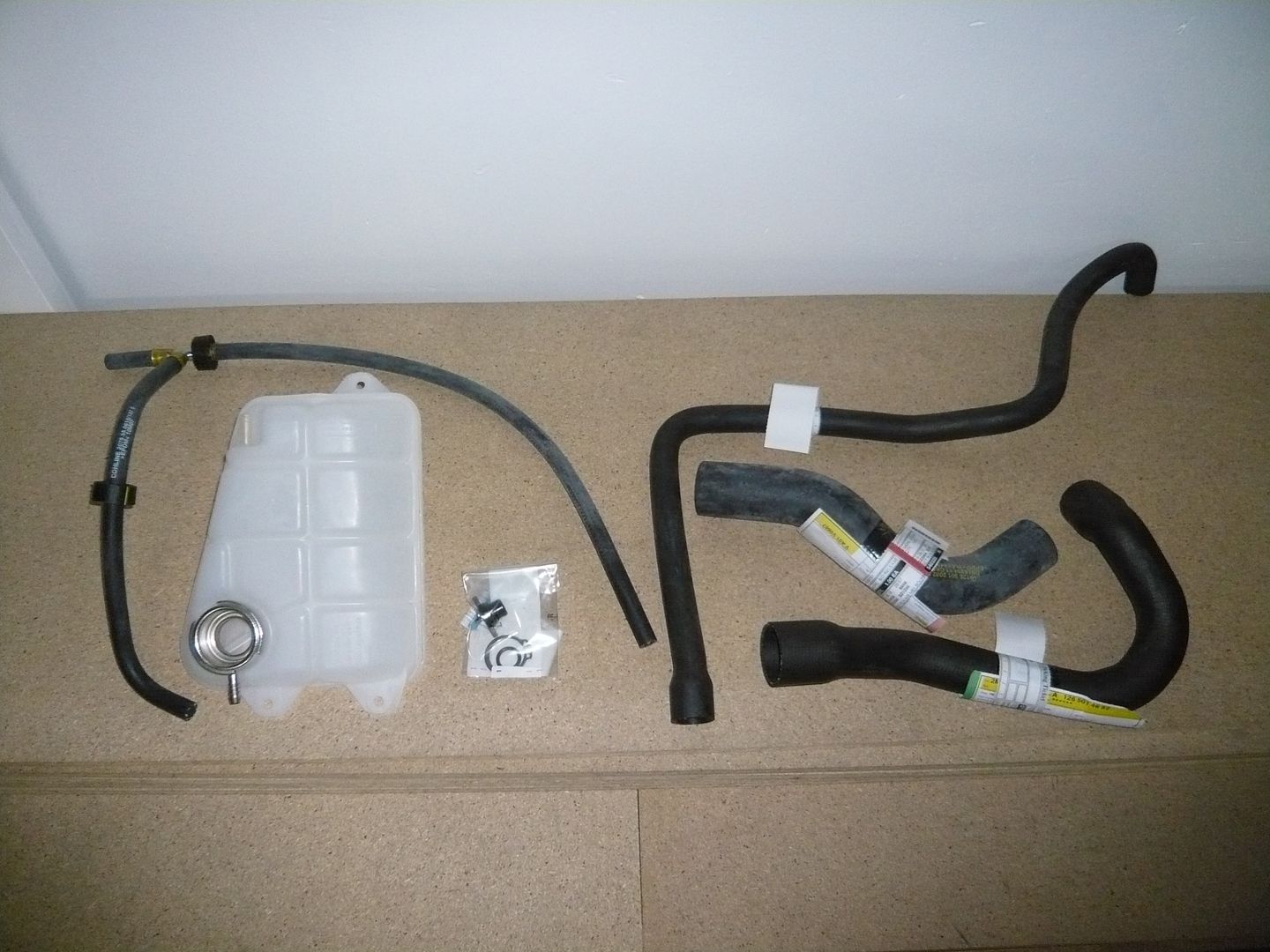

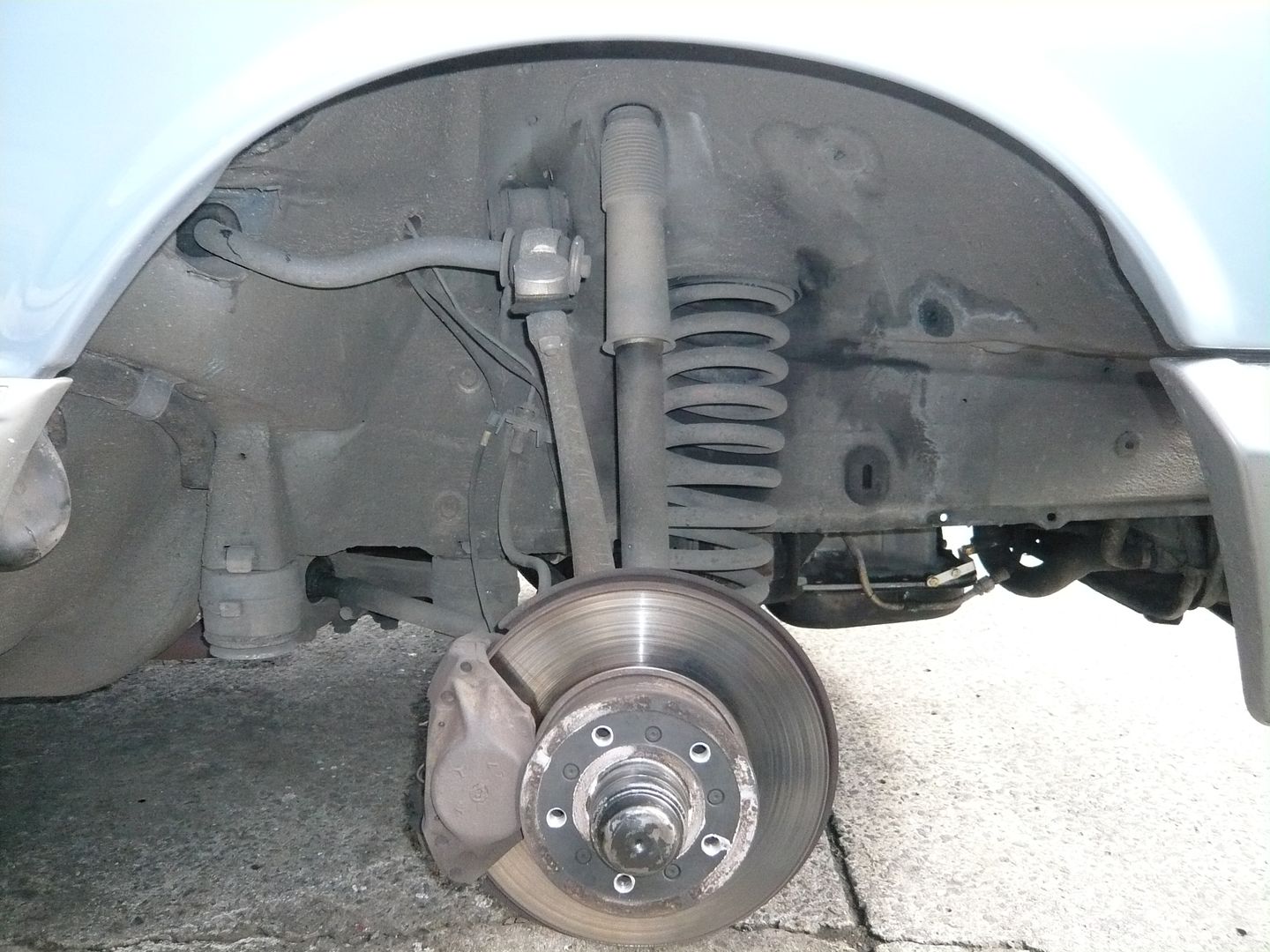

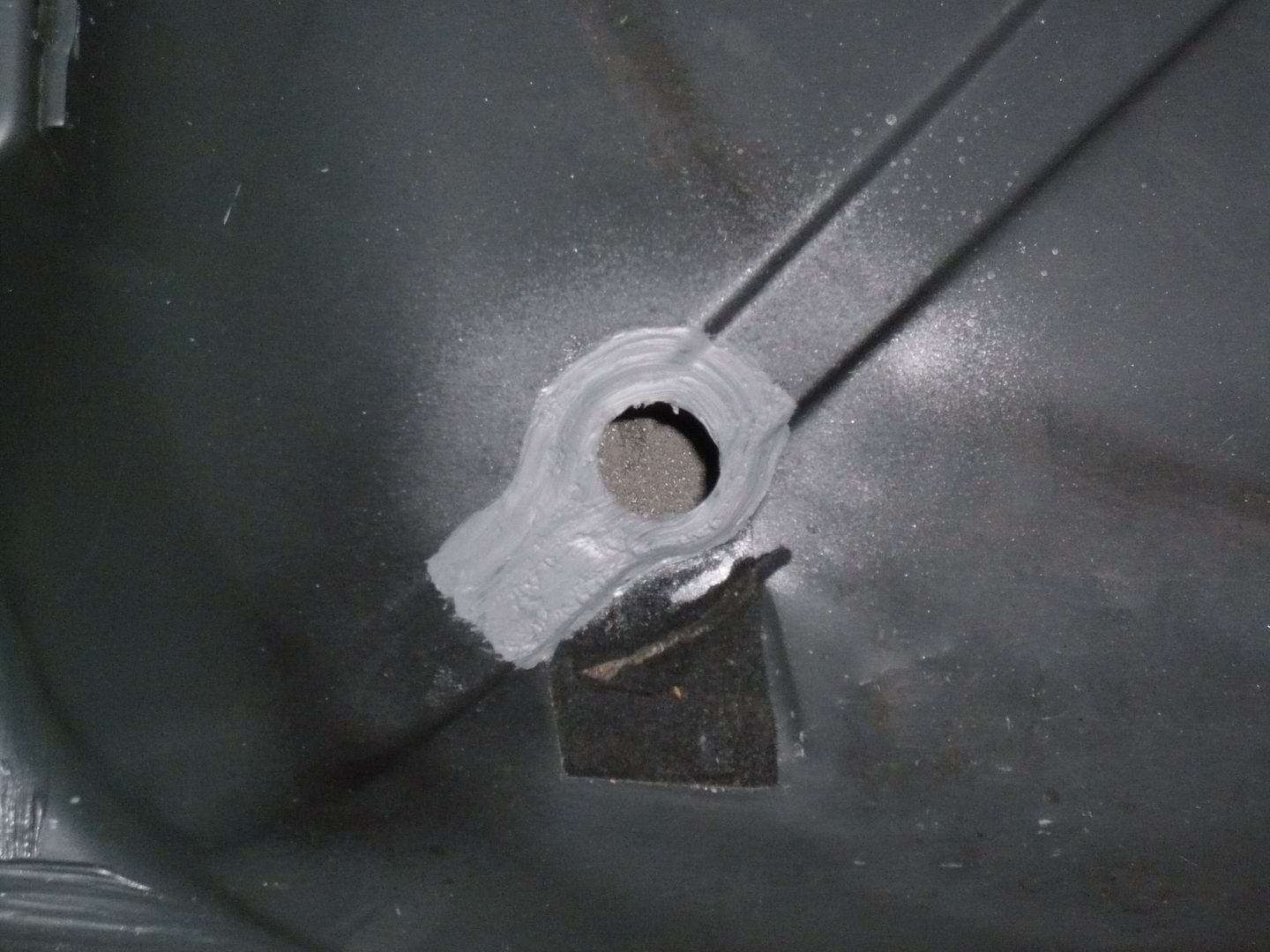

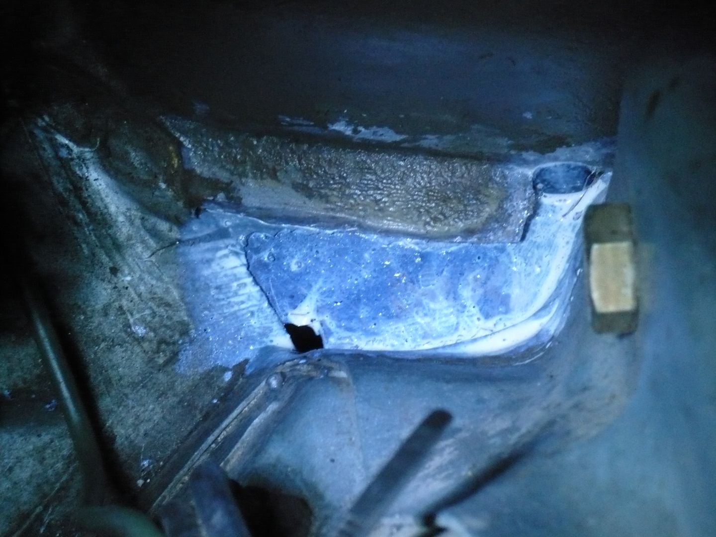

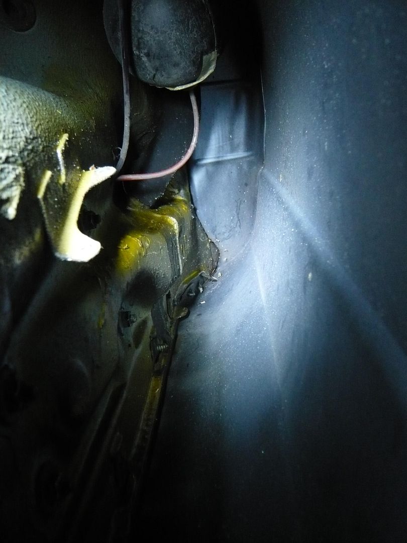

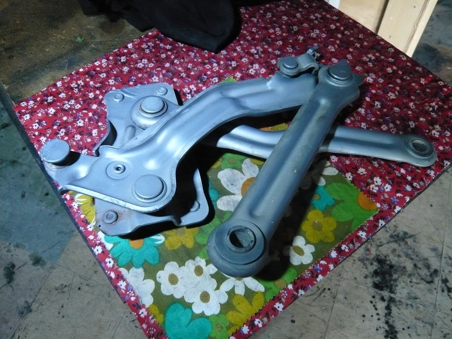

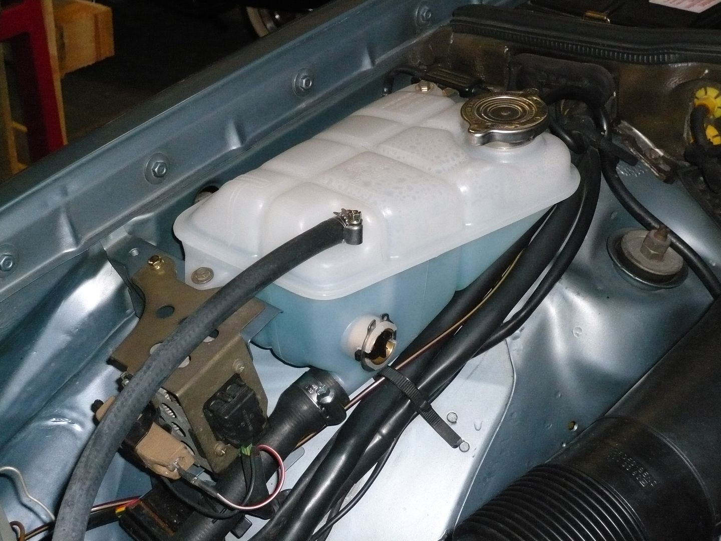

Post by carl888 » Thu 05 Sep, 2013 2:06 pm

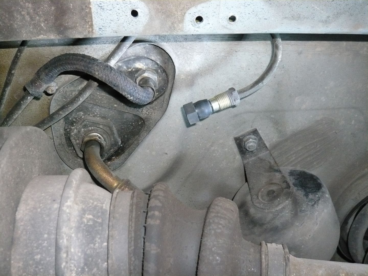

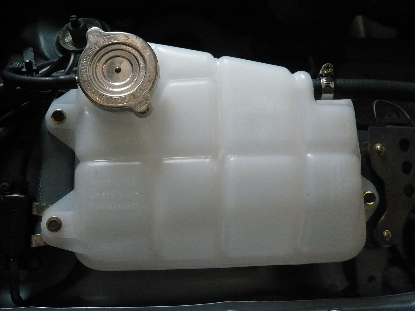

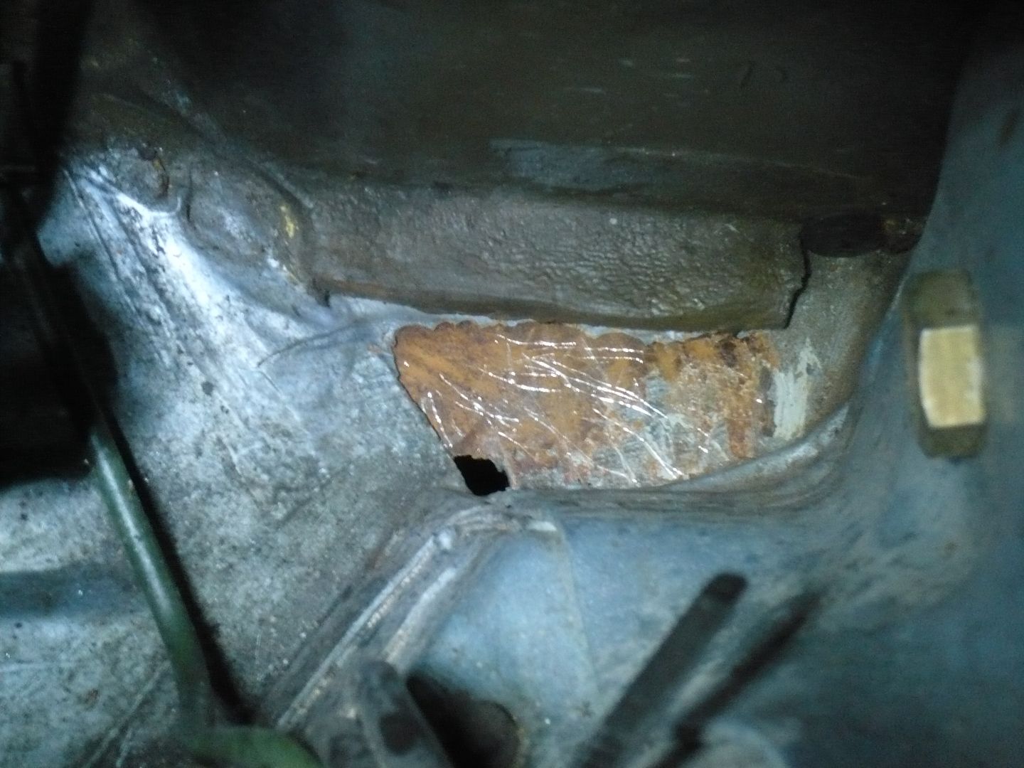

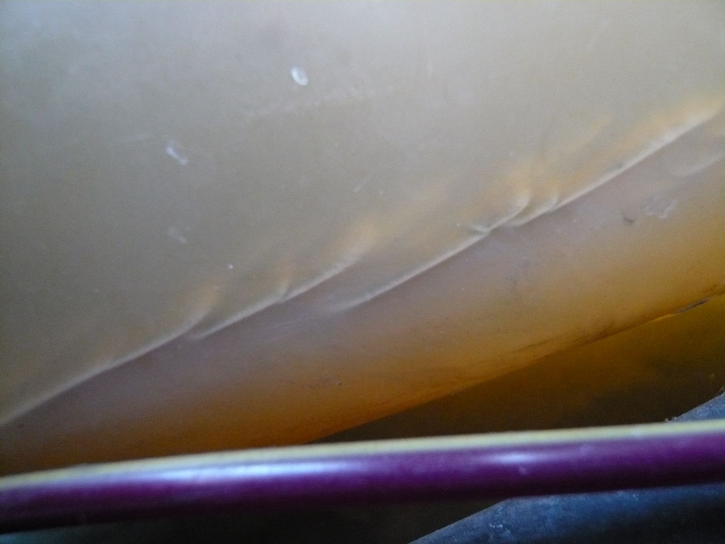

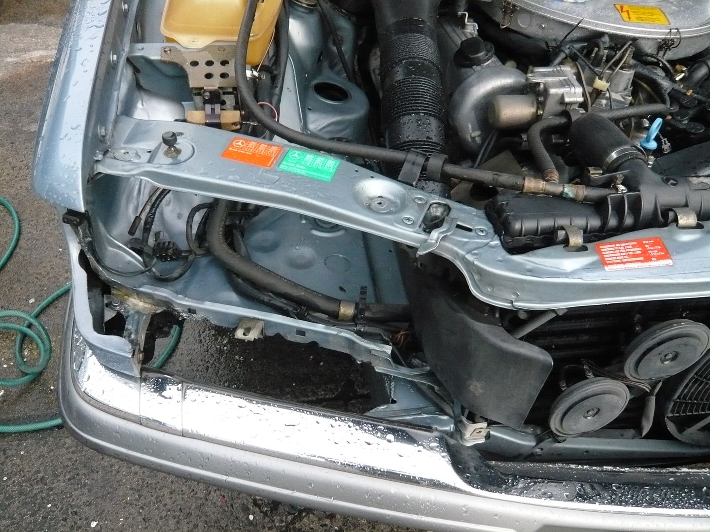

Well, the header tank lasted about another week before the cracks finally gave way. Luckily I was in the garage, not on some drive. I also discovered a blister on the underside of the top radiator hose. And thanks to John Green, I finally secured a fourth 14" alloy that had luckily spent most of its life in the boot of a 380 SEC. Although the four alloys had minimal use, one had been fitted with an incorrect knock on weight that had marked the rim. I managed to re-paint just that section and although no great painter, after three coats of clear and one base coat I couldn't tell that section had been re-finished. The original tyres were the Michelin 205/70-14 XVS, funny to see one dated 1984 with almost full tread left.

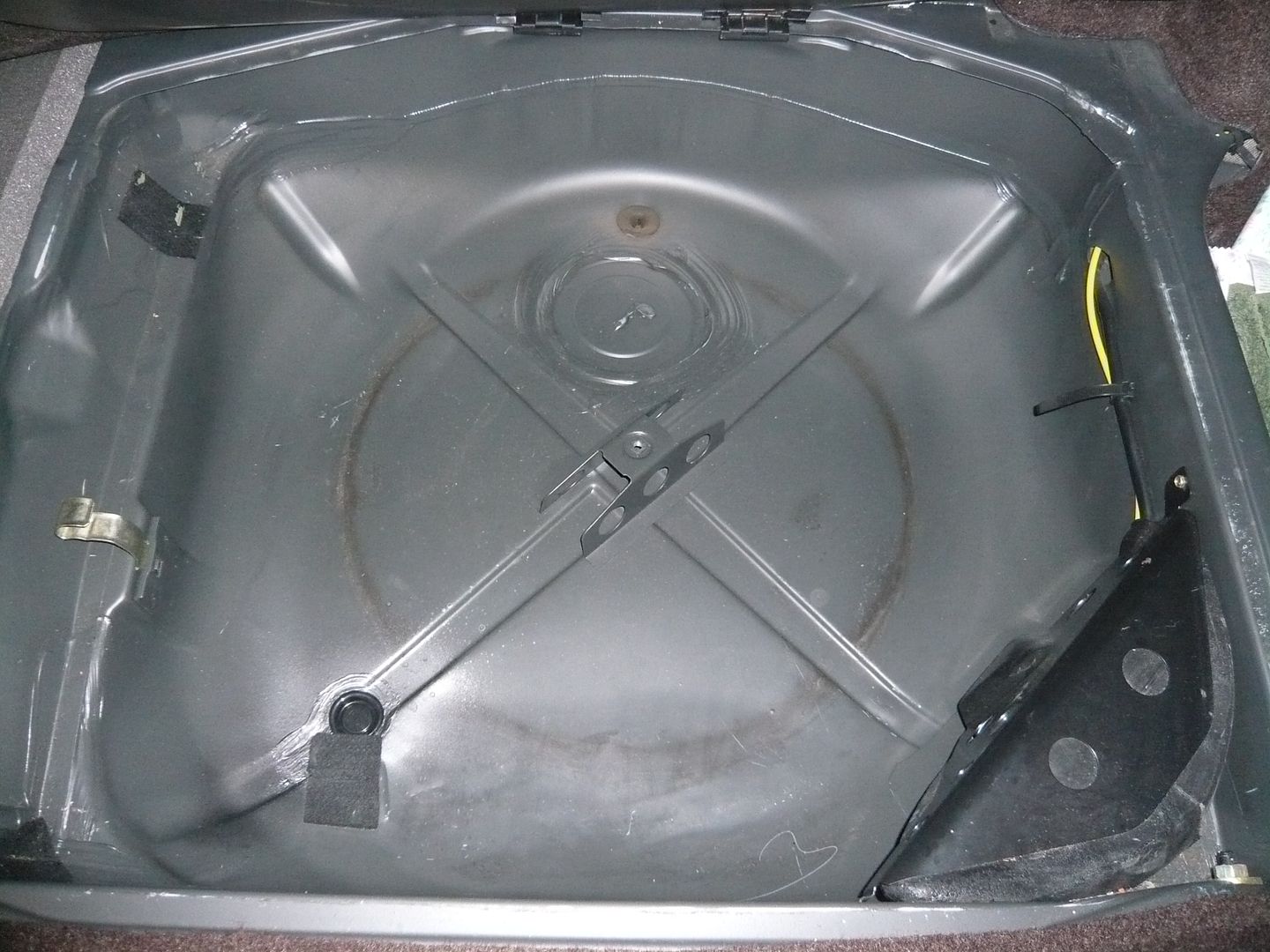

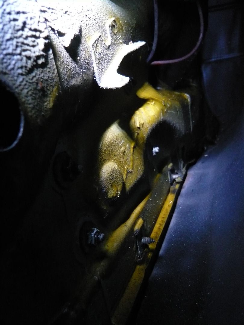

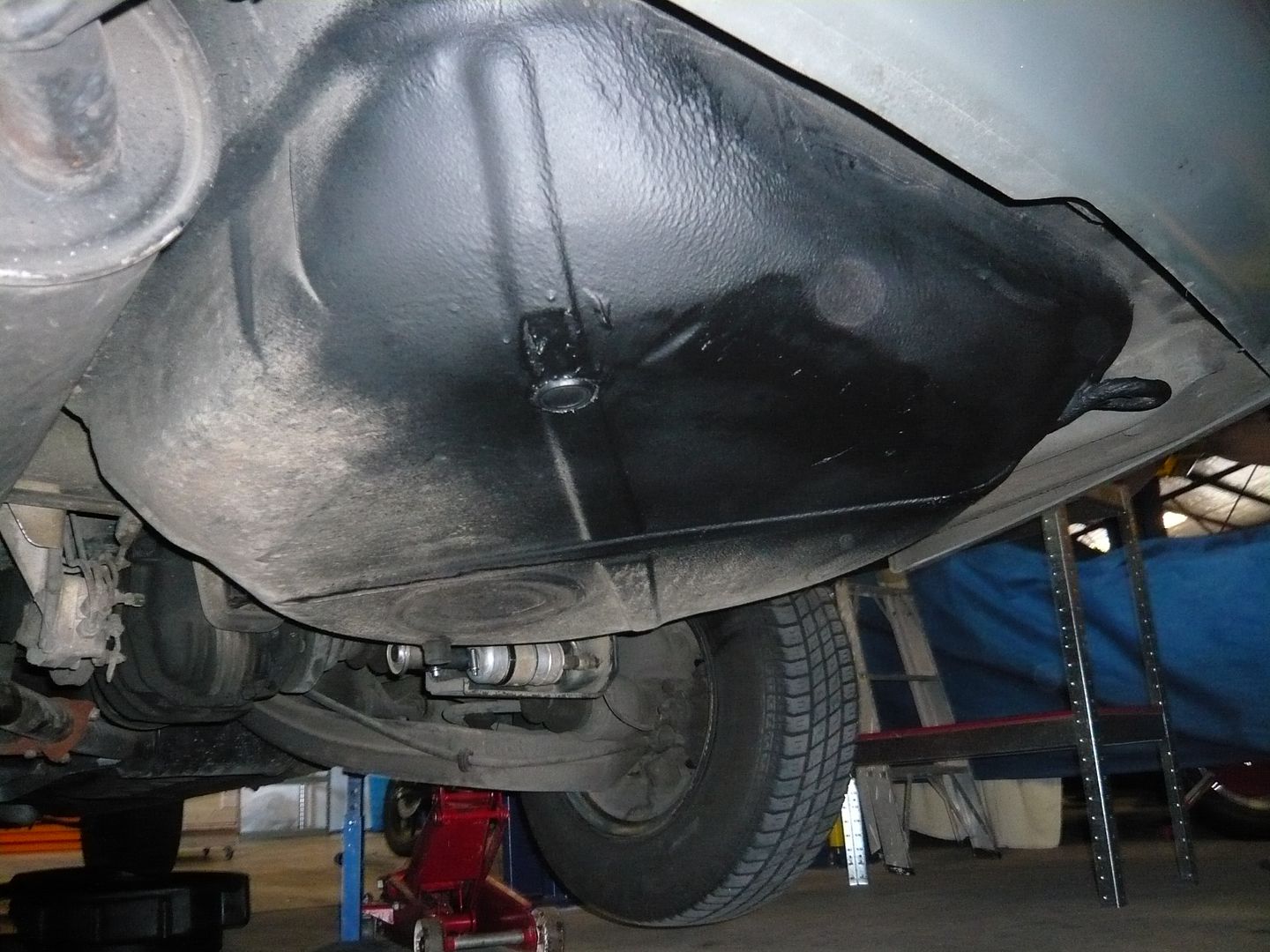

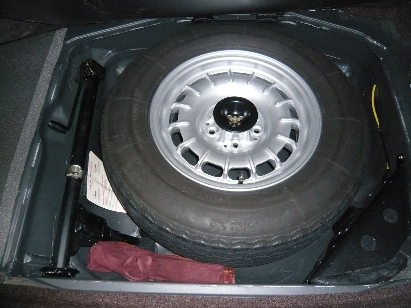

The rear section of the boot had also been grounded, pushing upwards the spare wheel well. Again, with the careful use of a hammer and dolly, I was able to press the back to its (Almost) original profile. At a later stage I will also re-paint the exterior section of the wheel well as the underseal has been scraped in places.
I was also having issues with the pneumatic adjustment of the headlight aim on the drivers side. I decided to remove the lamp assembly which also gave good access to the lower radiator to lower header tank hose, which was earmarked for replacement. The snowball effect ensured that as the wheels come off, I may as well clean inside the wheel arches. They cleaned up very well, but what was surprising was the amount of hardened mud trapped behind the lip of the wheel arches at the rear. It really took some scrubbing to remove this build up. Some pics:
It's odd how sad a car looks with one of its eyes missing!
One of the original spares:

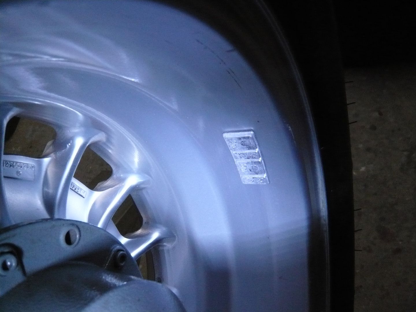

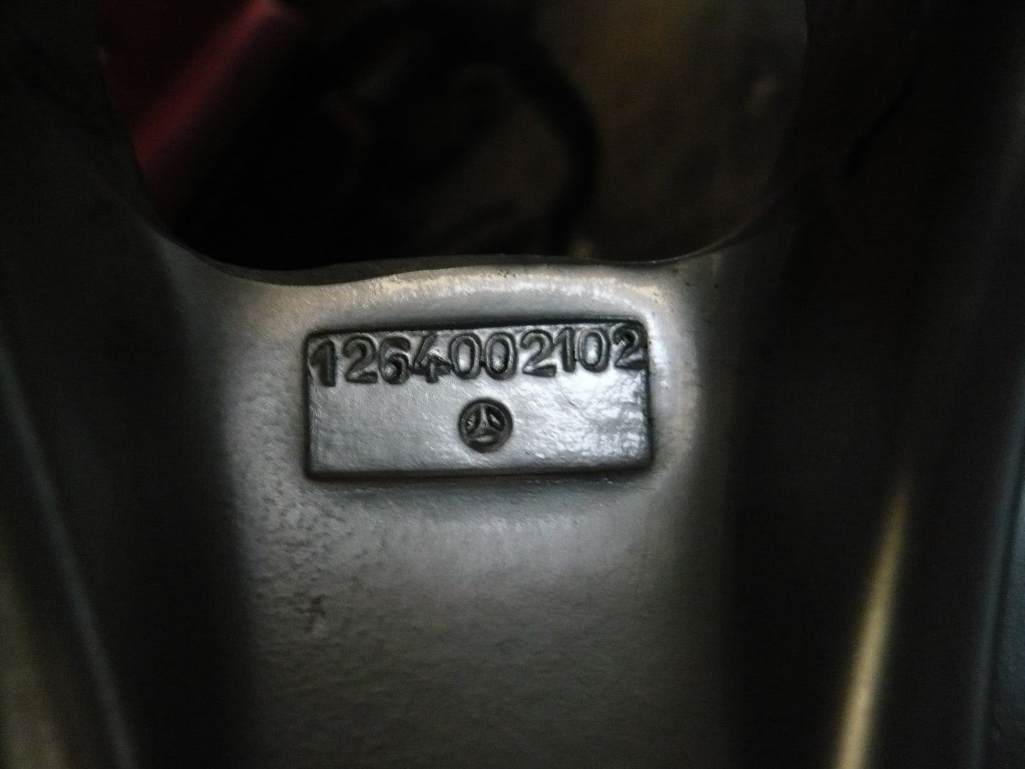

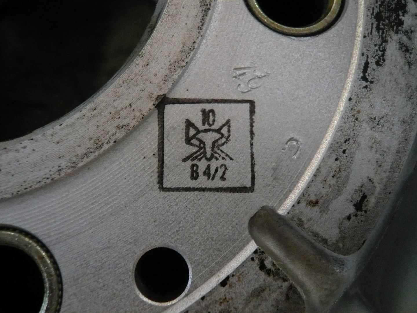

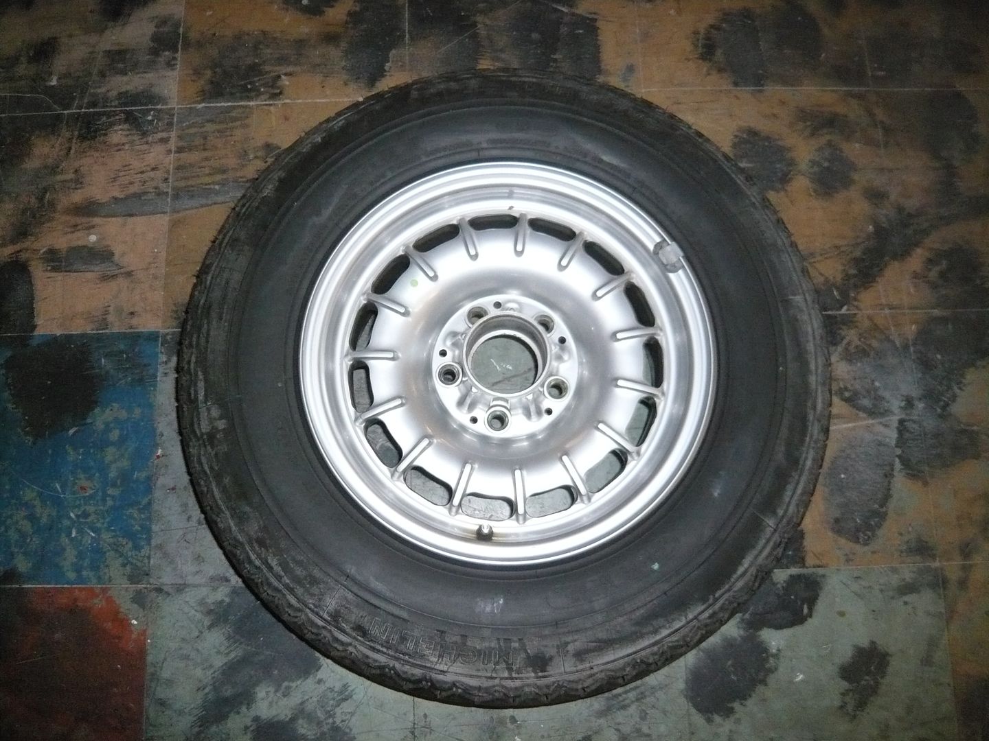

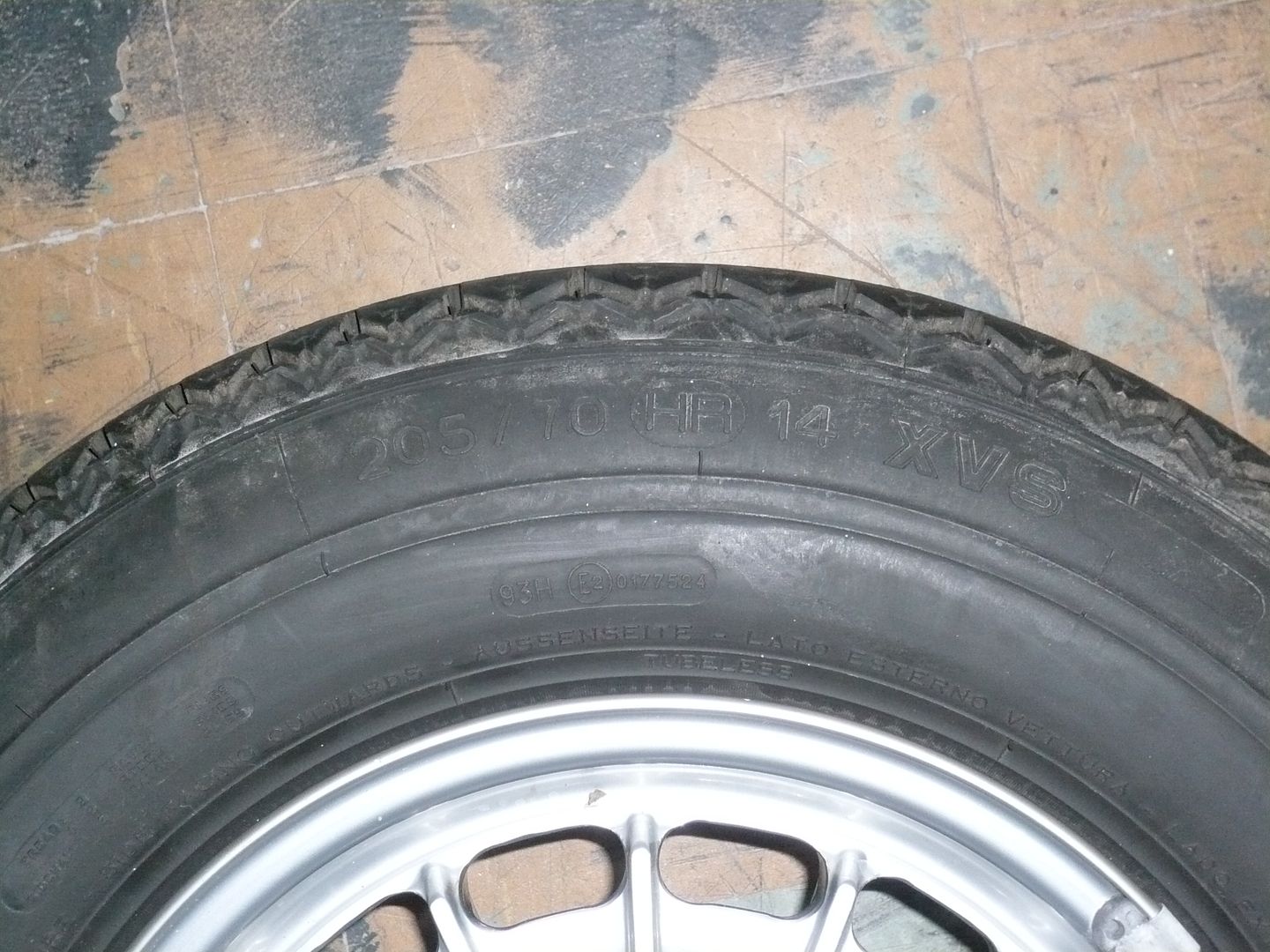

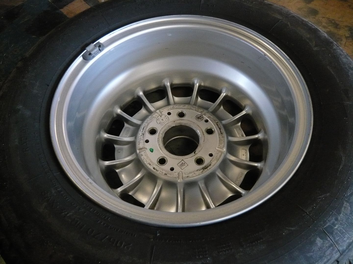

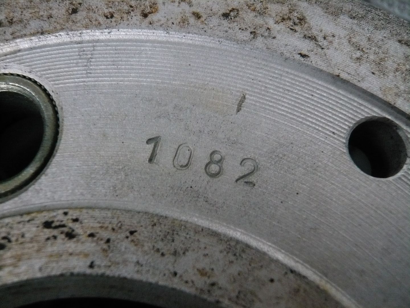

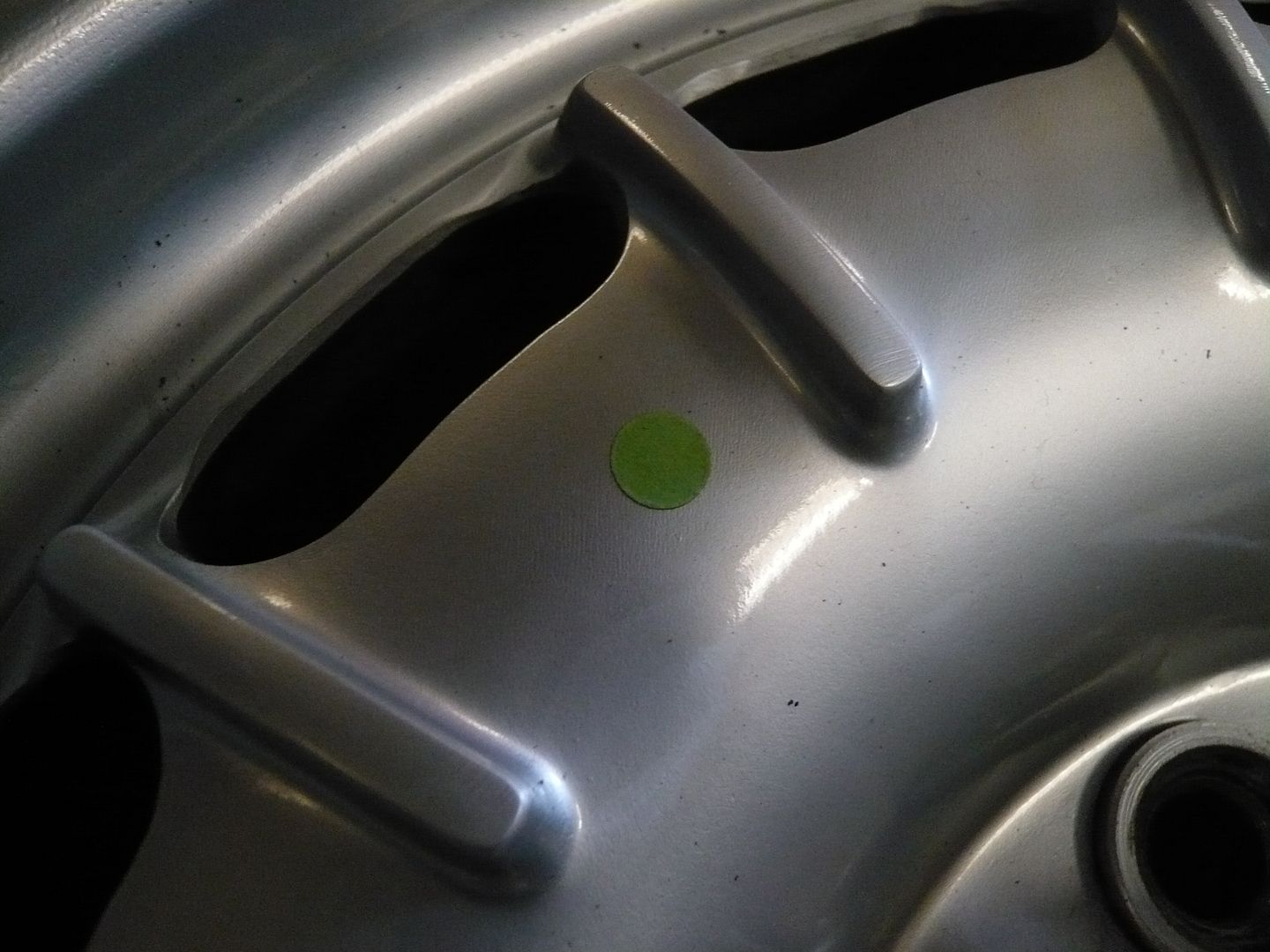

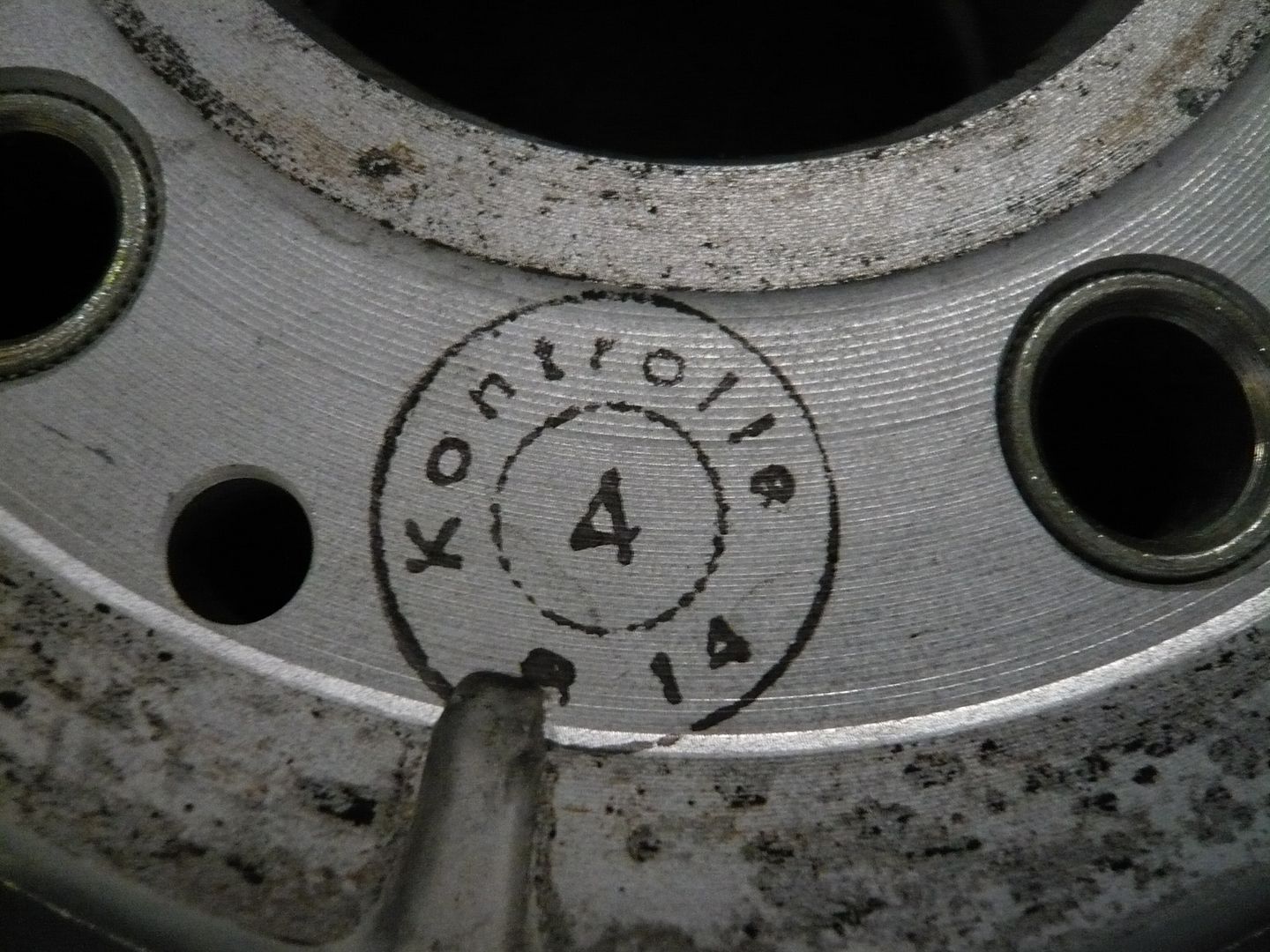

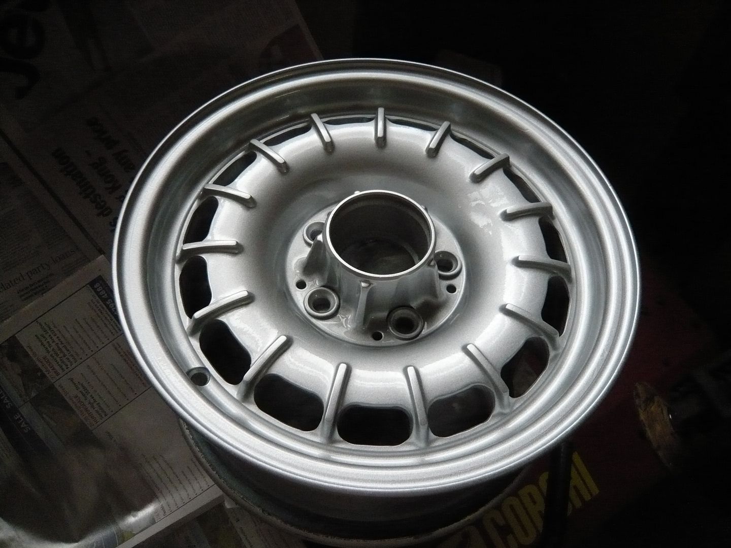

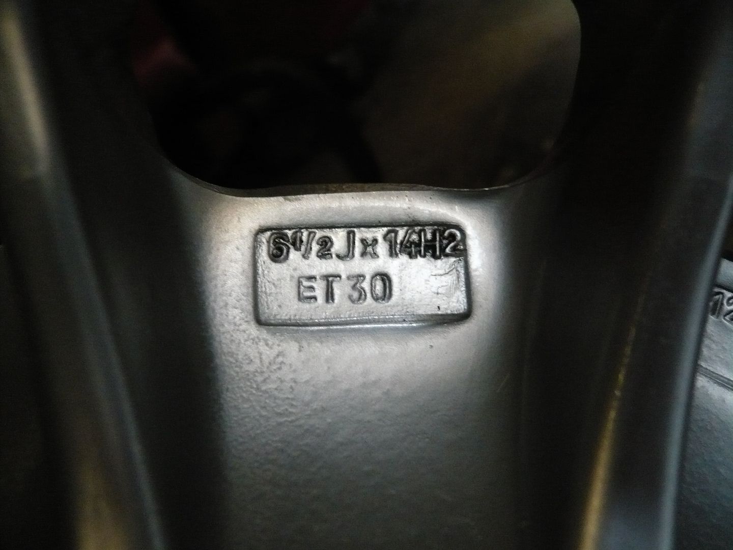

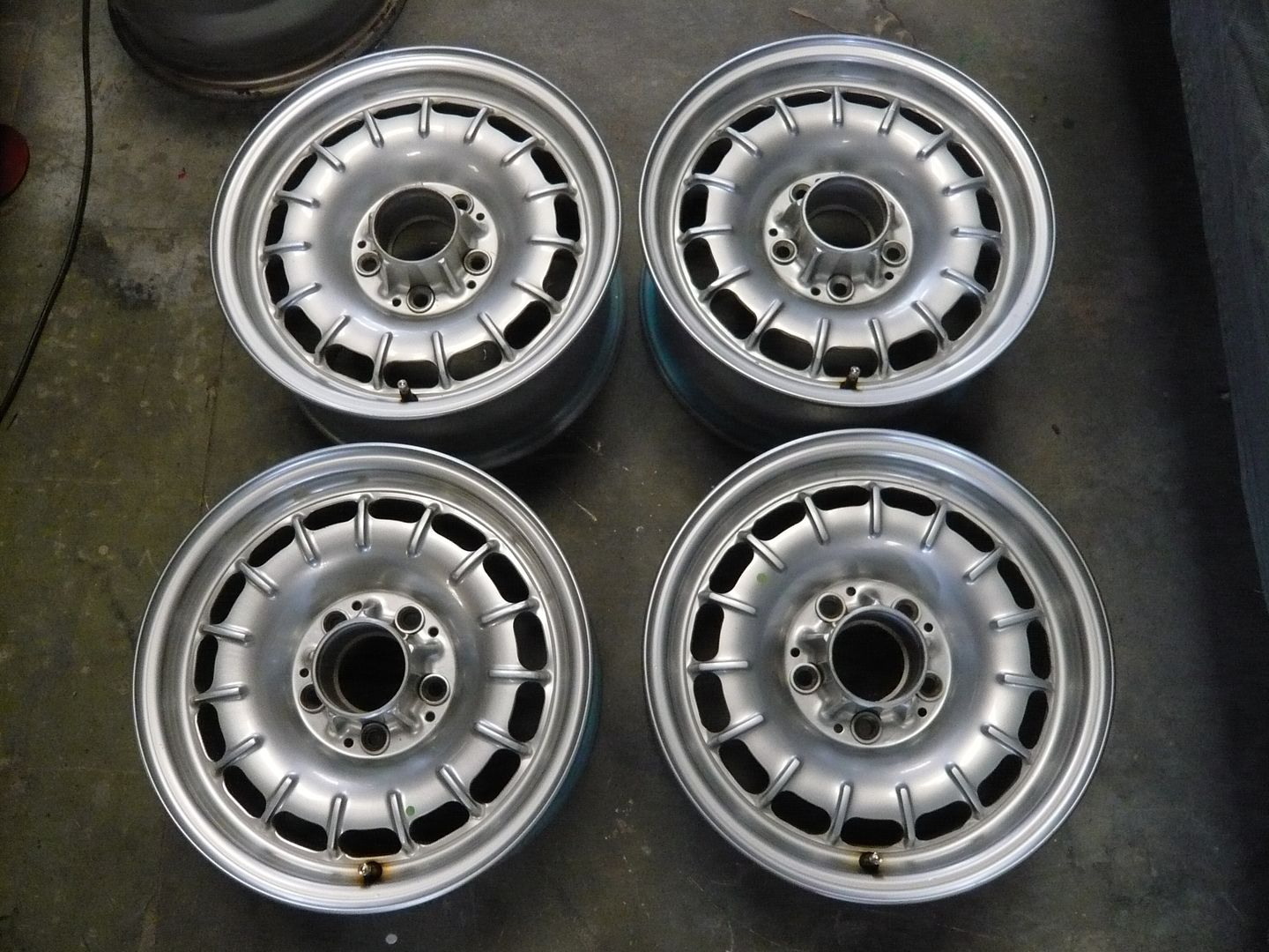

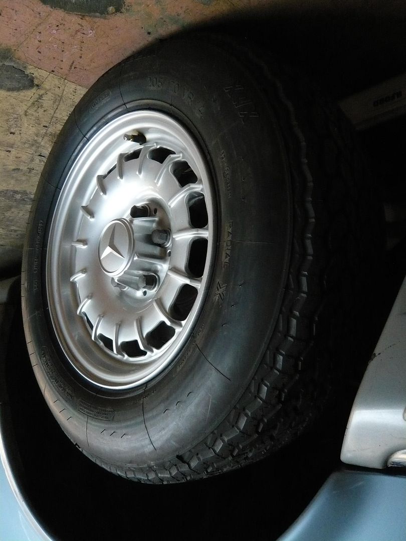

I noticed a green sticker on the rims, for Porsches, this indicates the highest part of the rim, I wonder what this means in Mercedes-Benz speak? Does anyone know? I left the stickers on. Additionally, notice how the original rubber valve stem has discoloured the rim in its immediate vicinity. All four rims show this discolouration. Finally a picture of an original Mercedes-Benz style weight, held on by the correct powder coated clamp so as not to damage the wheel. I cringe when I see a "Normal" weight just bashed on the wheel with the resultant damage.
A selections of stampings found on the back of one of the wheels, quite a few!

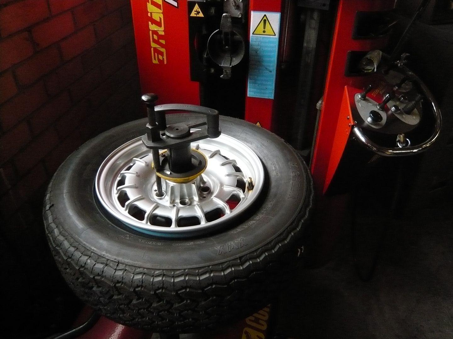

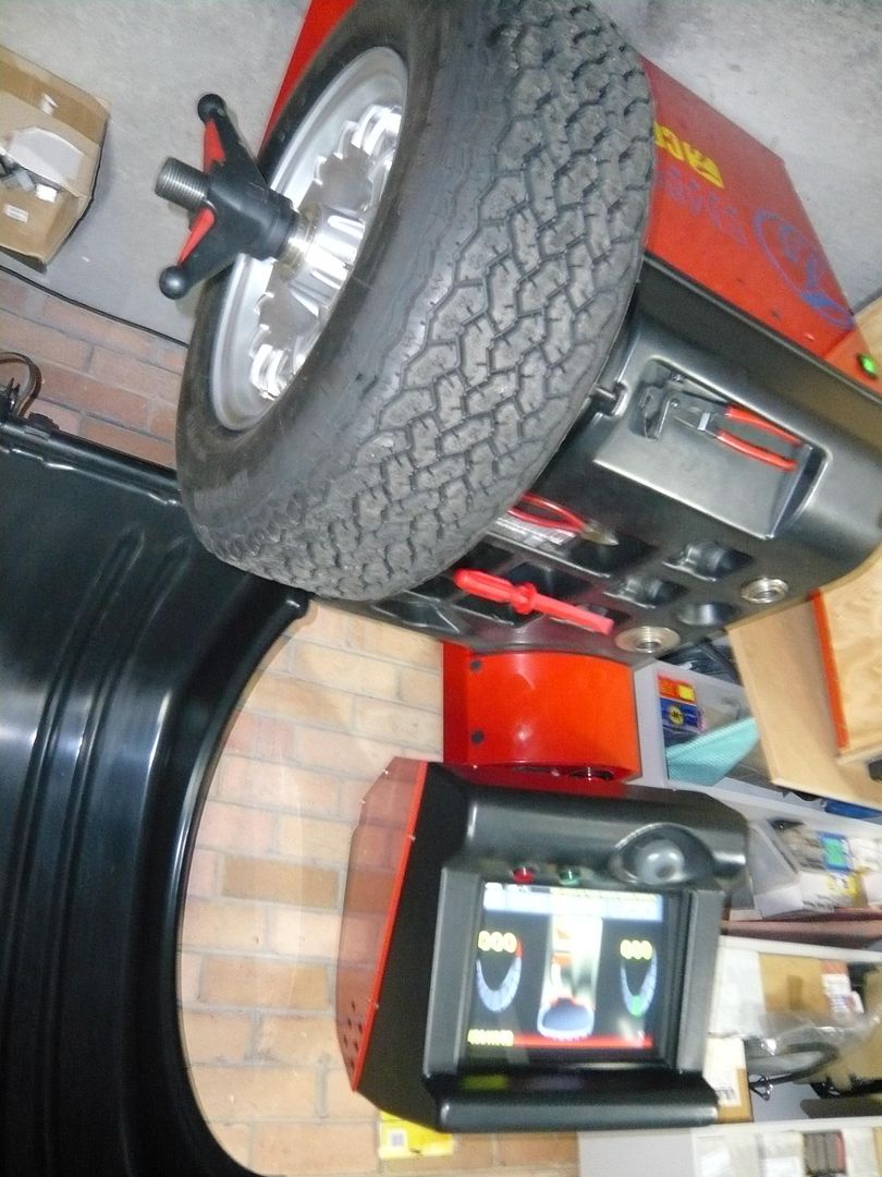

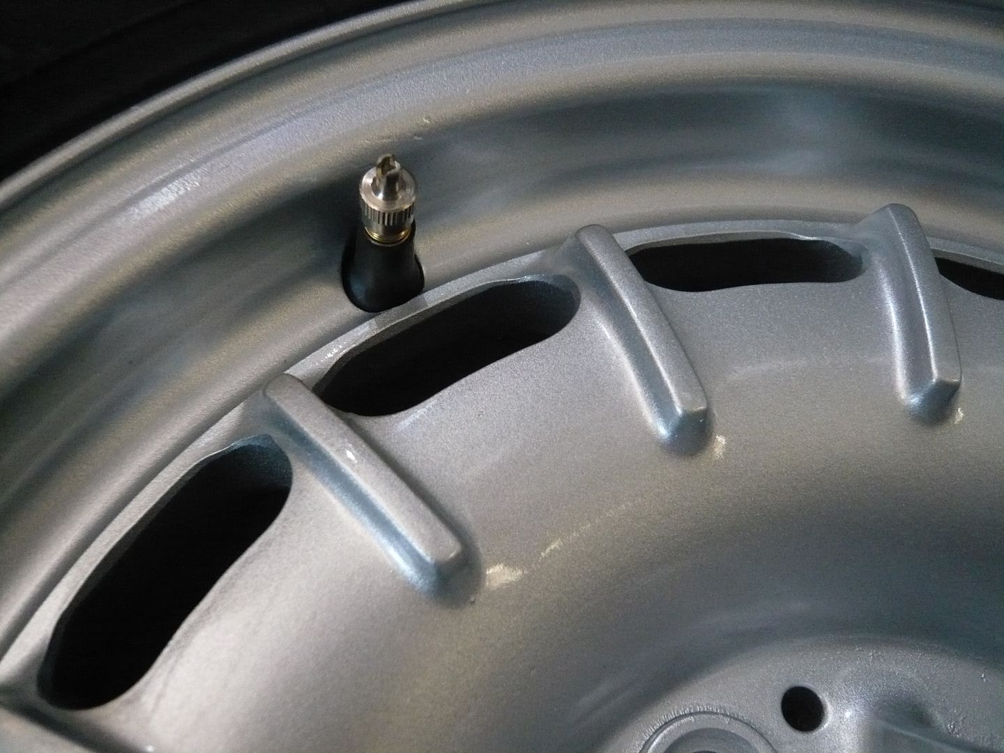

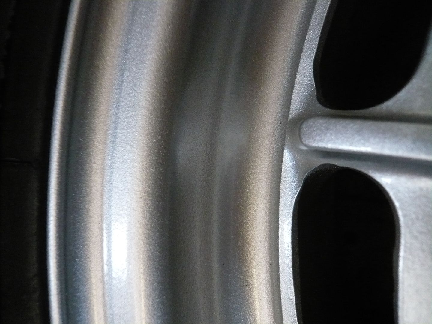

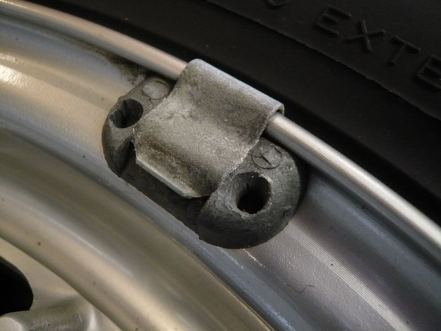

The four very nice condition rims all cleaned up, marks painted, new stems fitted and the Michelin XWX tyres going on:

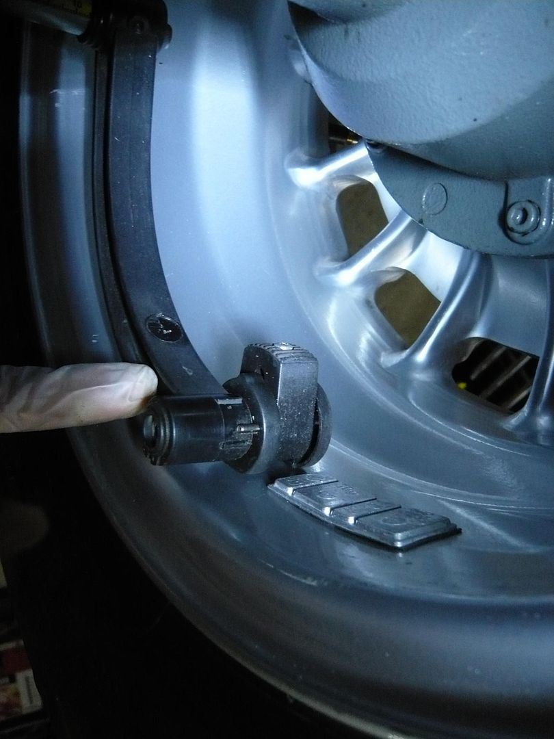

I don't like the knock on weights, in fact there is a small ridge on the inside of the rim when you can place adhesive weights easily. The only issue is the weights that may need to placed on the inside of the rim, even a slimline weight will rub against the brake backing plate. You can see the rub mark in the weight in the following picture:
The solution is to be a little creative with the wheel balancer. Just use the machines data arm to tell it that the rim is about 5 1/2" wide not 6 1/2" and you can place the weight an inch further in therefore clearing the backing plate.
And a nice result. It's good practice to rotate the wheel on the balancer hub 180 degrees to double check that the wheel is sitting on the shaft correctly, in this case, the wheels and tyres had immesureable run-out which is a relief and balanced very nicely:
Ready to go!

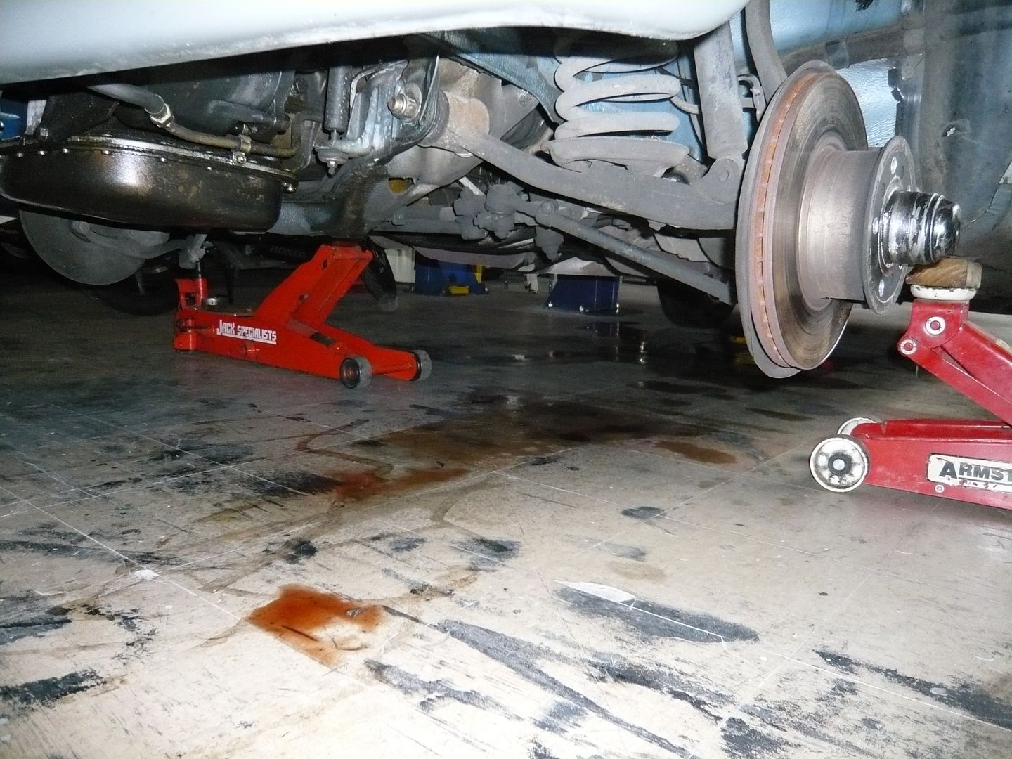

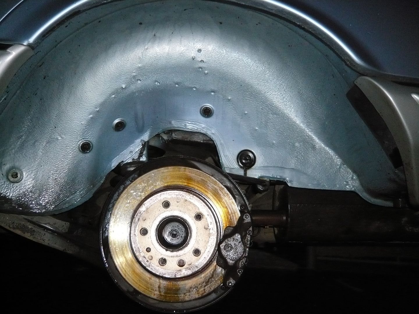

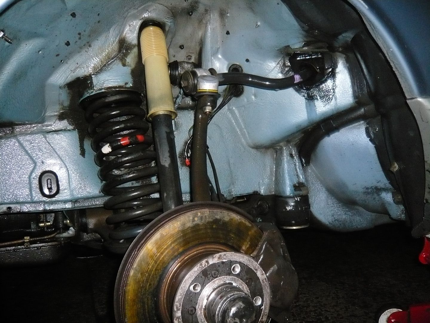

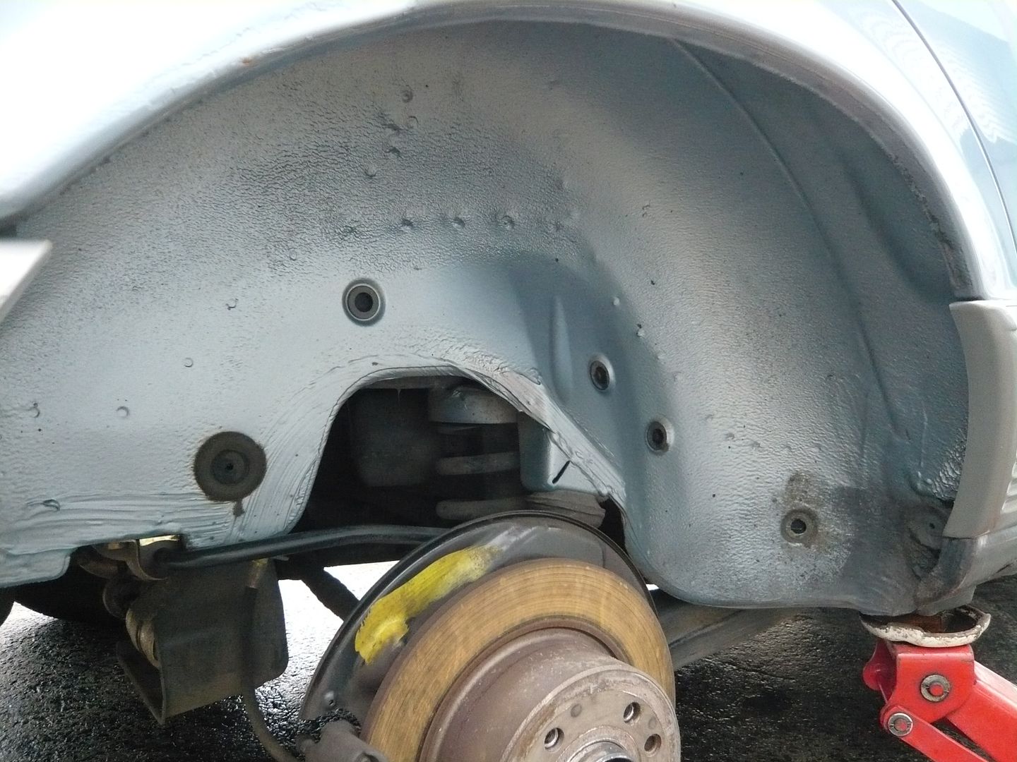

Once the wheels were off, it was time to have a look at the wheel arches. It's funny how little swipes of paint applied at the factory mysteriously appear when you clean in here! I used a mixture of plain water and CT18 truckwash with a lot of elbow grease. A few pictures before and after.

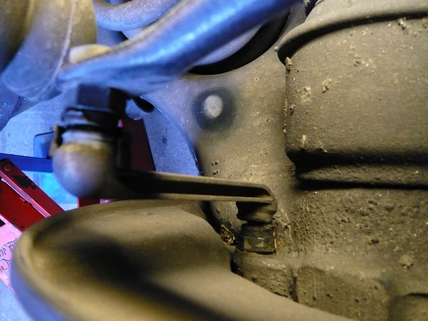

I also checked the torque of the bolts securing the steering box to the rail. I see this is a service item but I wonder if it's actually done? In this case, the bolts were tight:

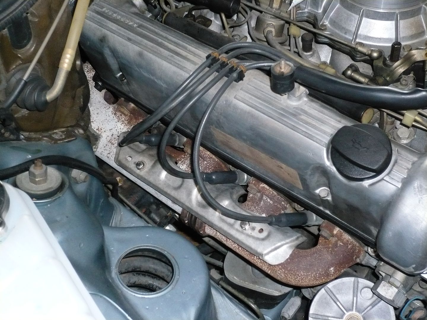

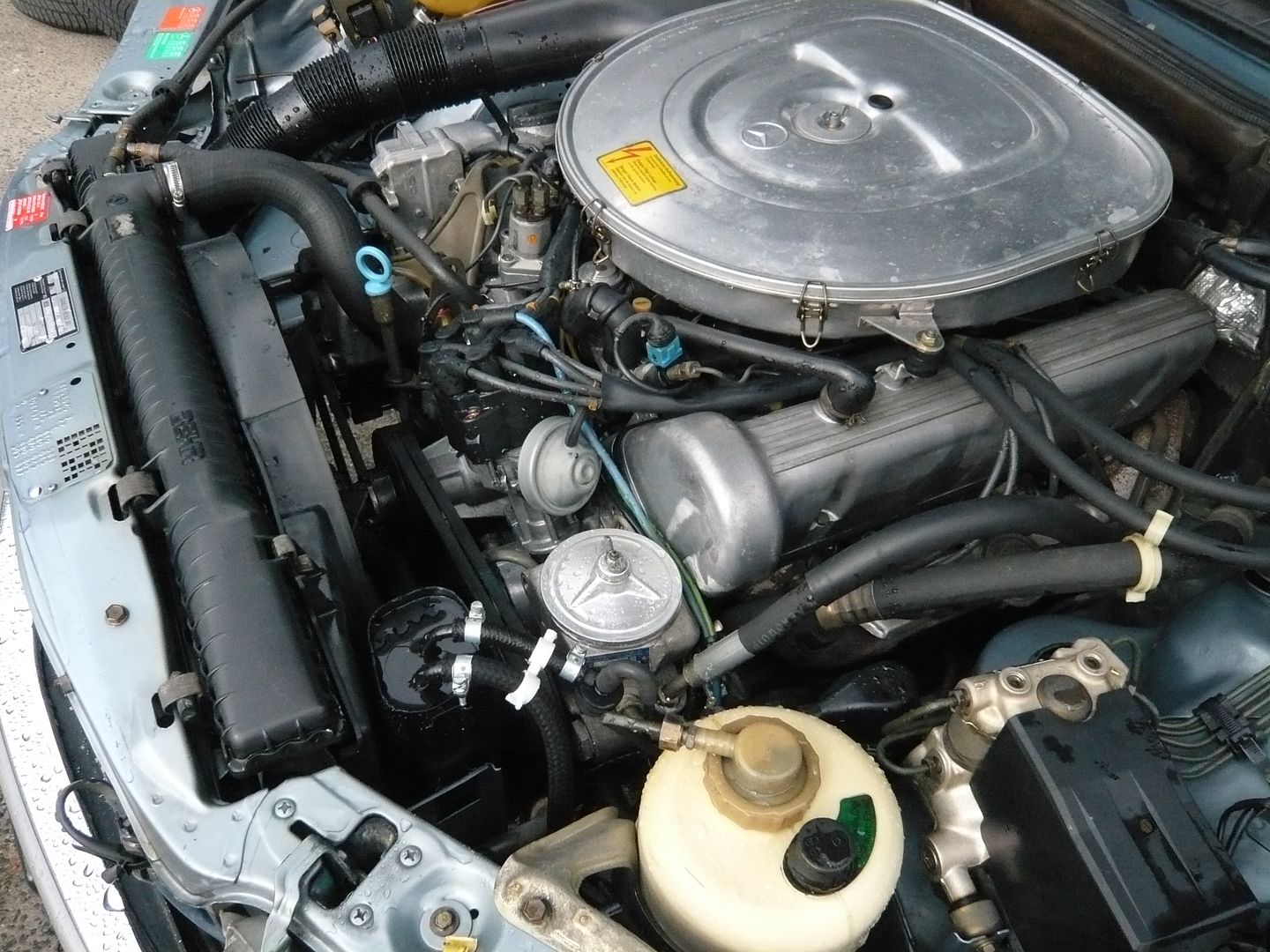

A case of "Whilst your in there" eventuated, so I cleaned the engine and the area behind the RHS headlamp assembly:

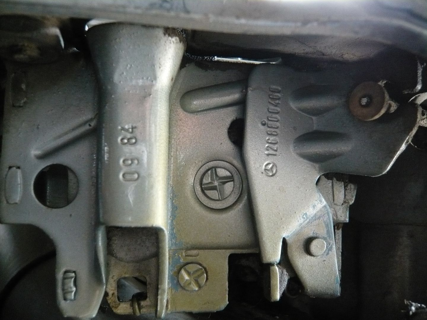

Funny to see a date stamp on the RH bonnet latch, I don't see two many such stampings on these parts:

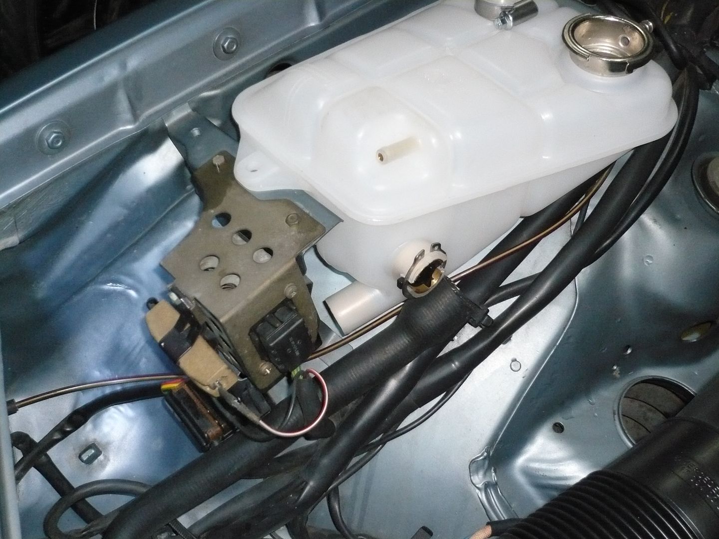

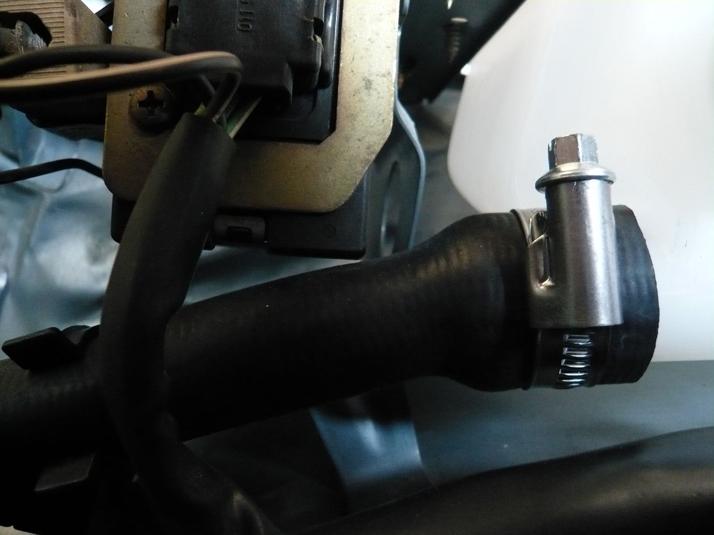

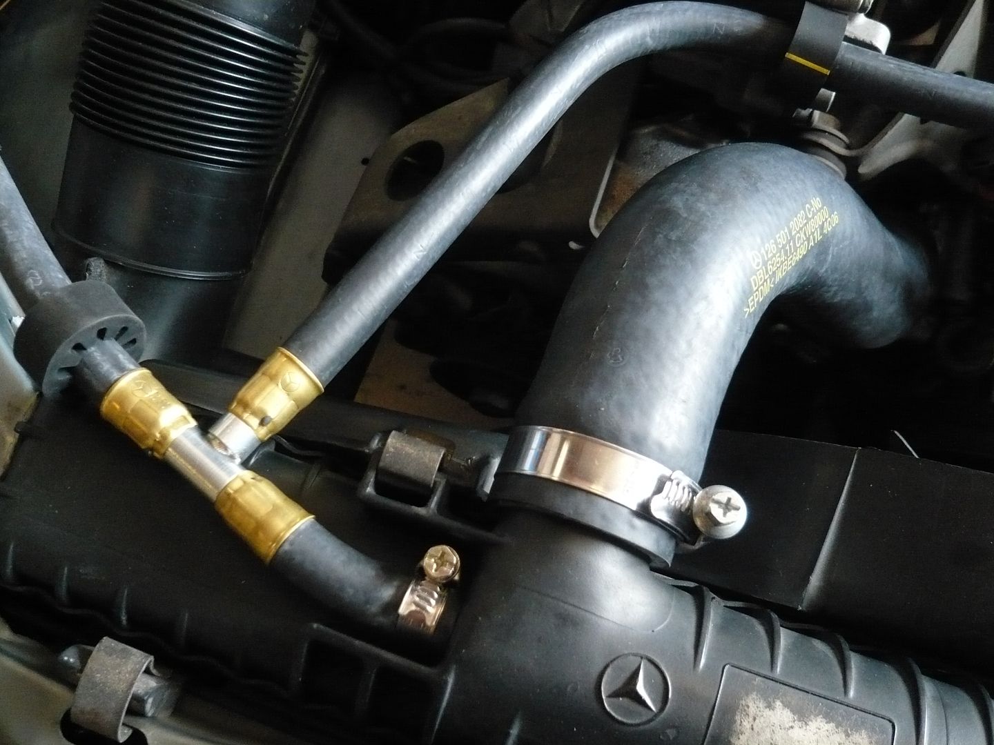

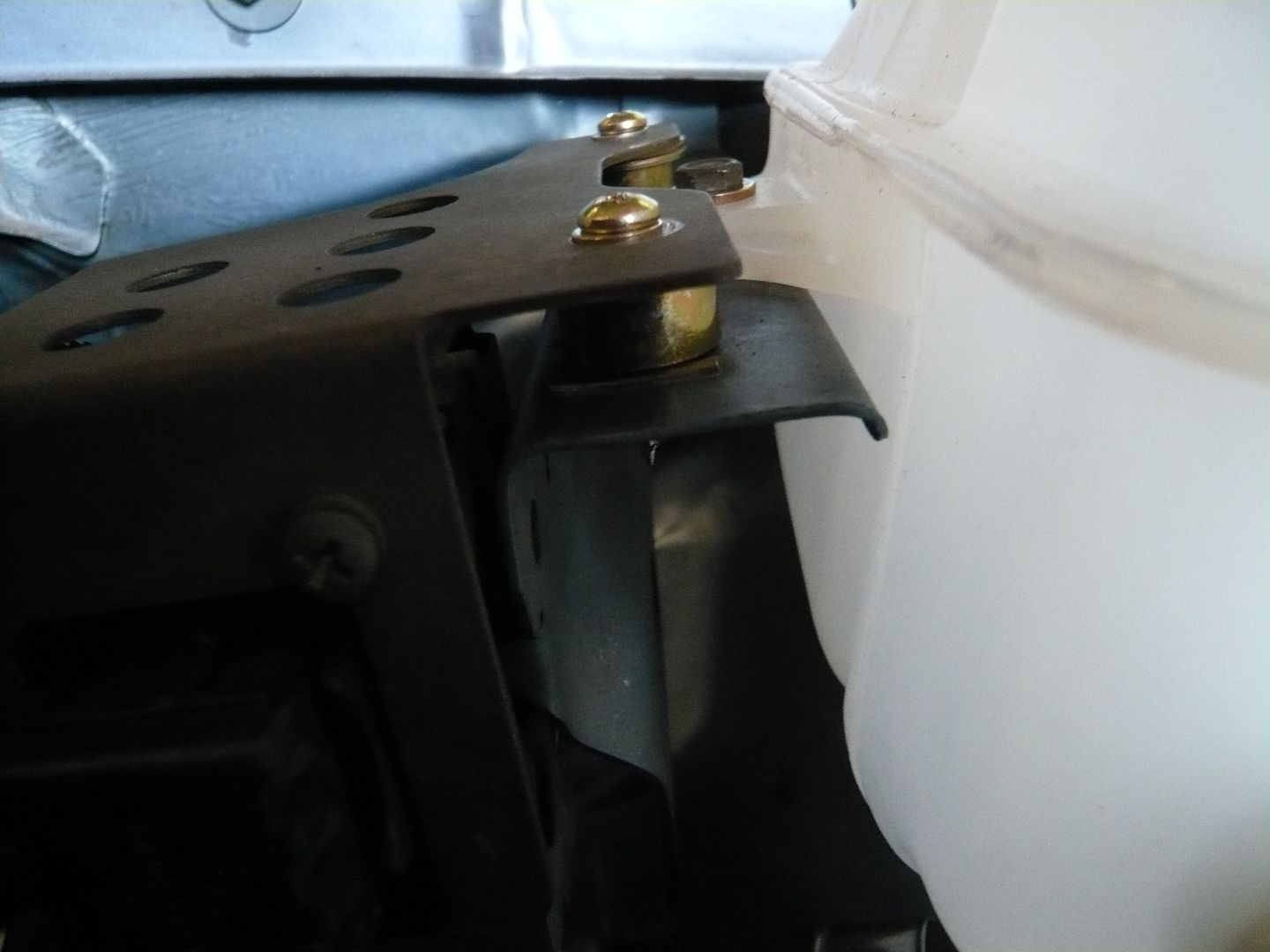

Now on to the leaky coolant system, new header tank, hoses (Except the one at the back of the thermostat housing as it has been done before) and I left the heater hoses at the back of the block. They looked good but will do them at the next coolant change in three years time.
The hoses were fine, but the lower outlet for the header tank fouled the fan resistor network and ballast resistor assembly:
The only way to get it to fit was the make a small stand off for the above mentioned assembly so that the lower house would clear:
It's not quite the solution I had in mind (I would have preferred it to fit!!) but I had no alternative. The part number of the tank is A 126 500 1549 which unless I'm mistaken should be correct. The small plug on the right side of the photograph of the tank is the sealing kit one receives in the package to cover the coolant level sender for the series II W126. The series I cars do not have this feature.
I managed to find the correct stickers for the radiator fan shroud and the header tank. With the new design of the header tank with its "Criss cross" pattern, the sticker doesn't fit. The best location i thought was on the top of the fuse box. Sadly, the fan shroud sticker pictured bottom left and damaged was missing and by chance I found it under the brake master cylinder. I was going to stick it together and fit it to the fan shroud when suddenly a gust of wind blew it away and no it's no where to be seen! Does anyone have a spare, the part number is 000 584 1340, it is no longer available apparently. Sigh! (Although the replacement sticker carries this fan cover information you'll notice)

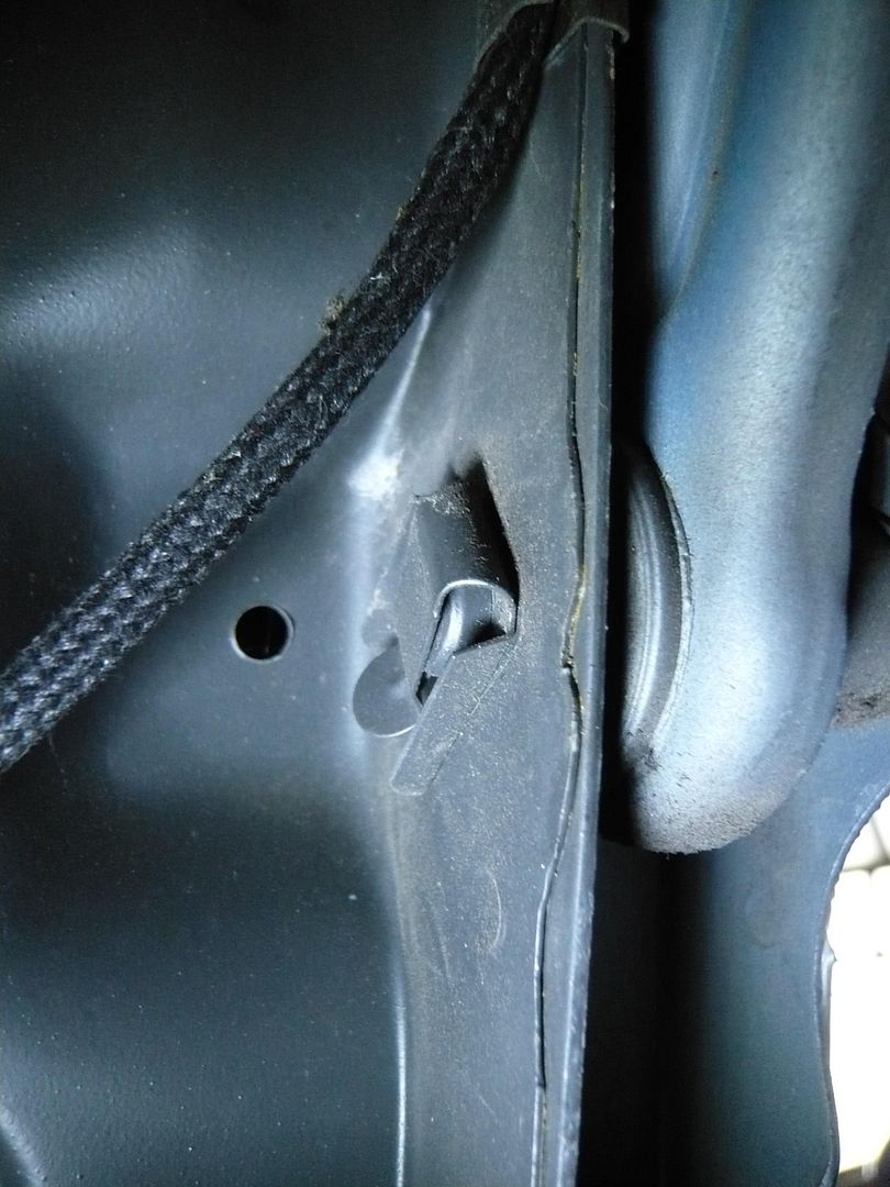

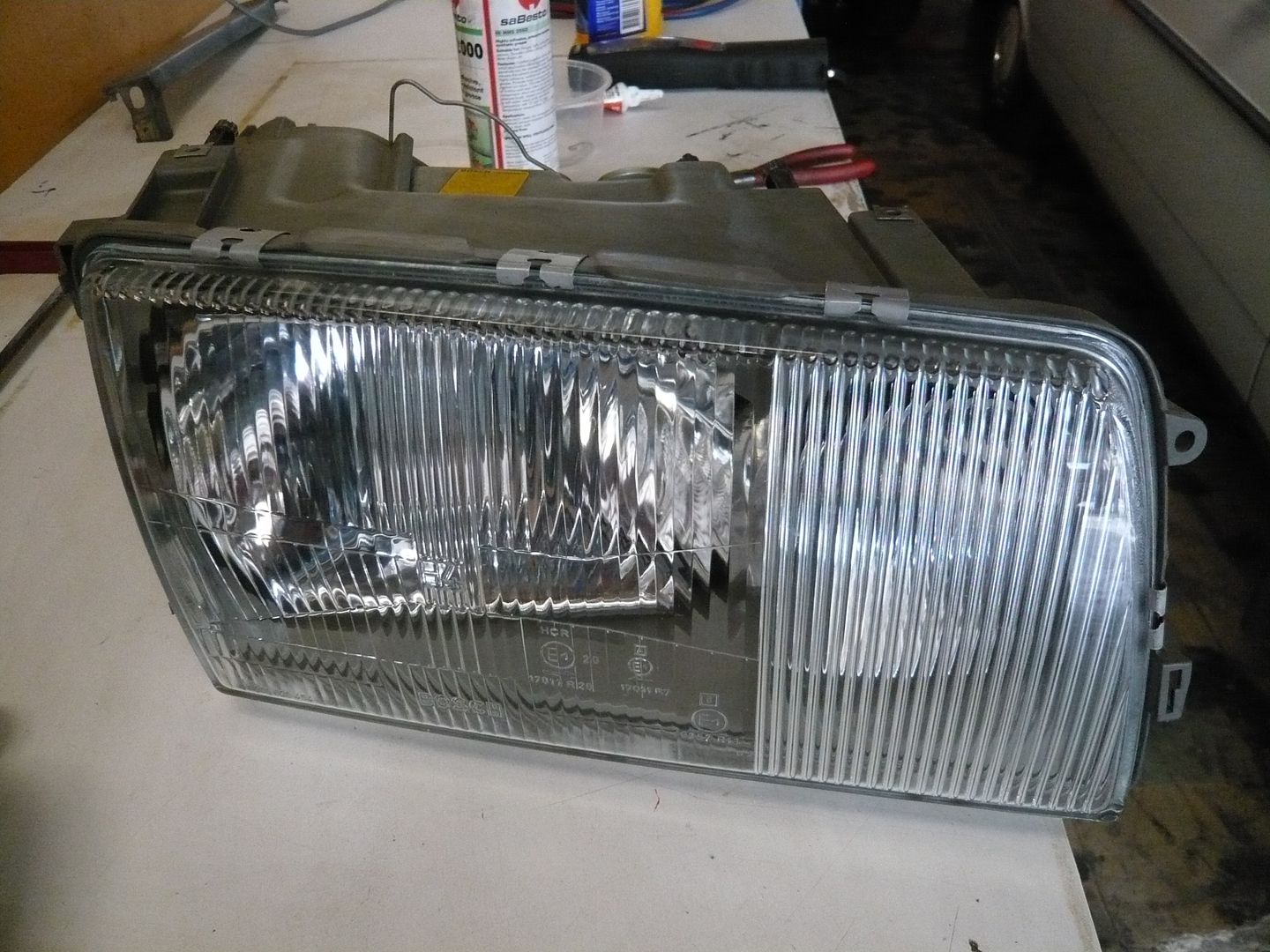

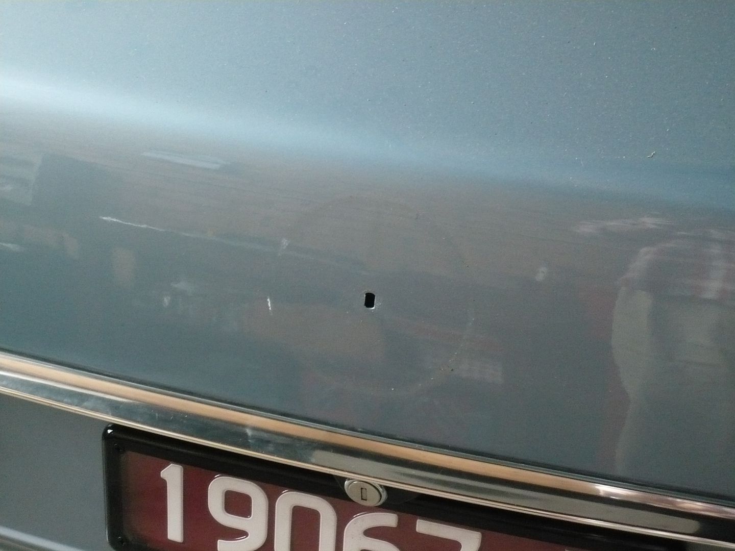

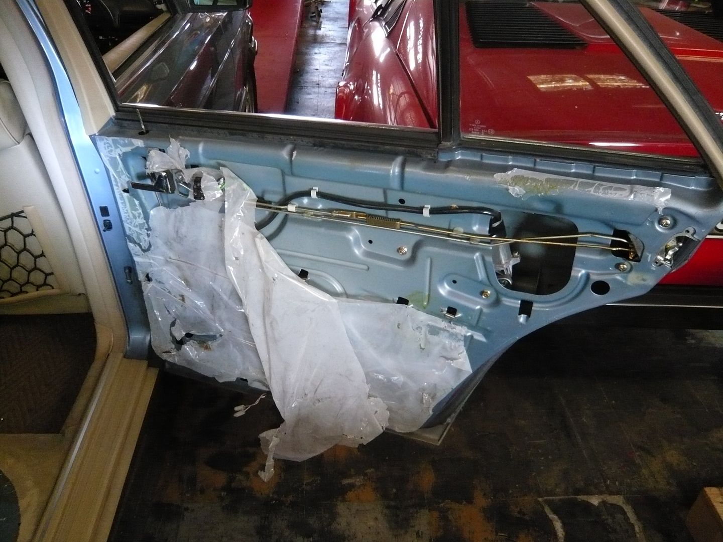

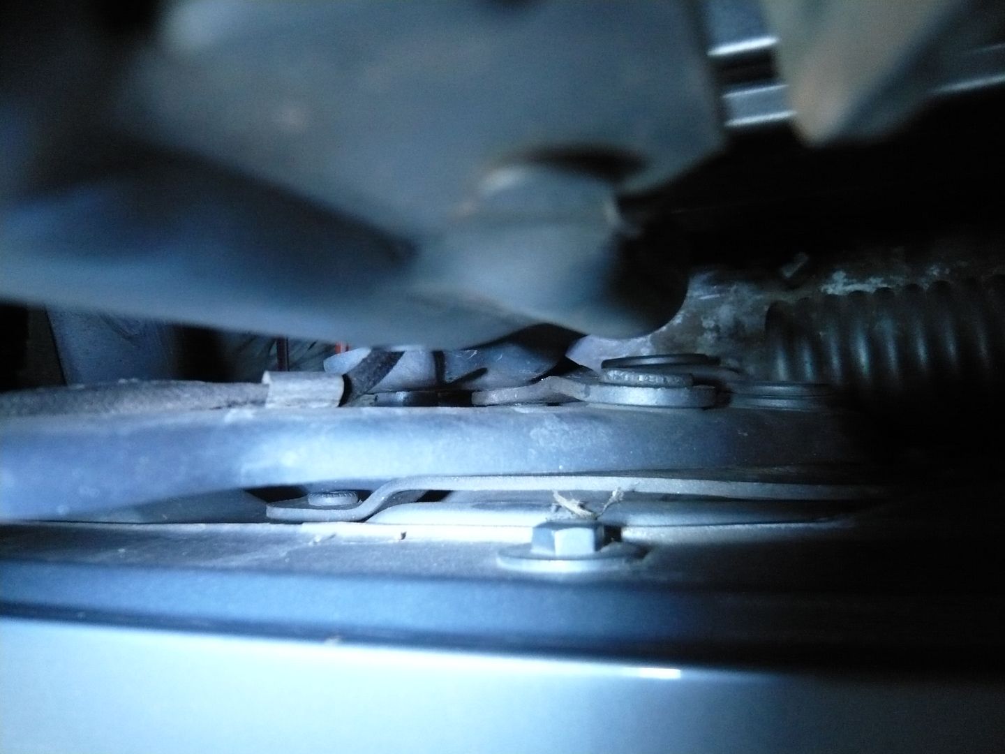

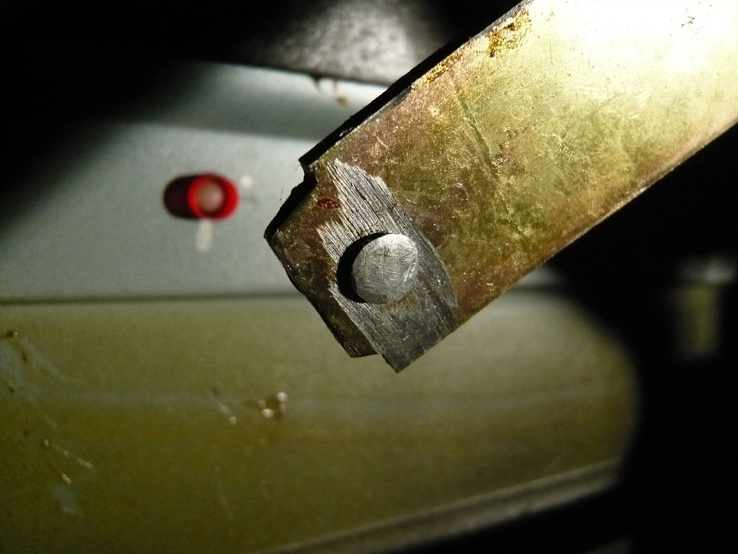

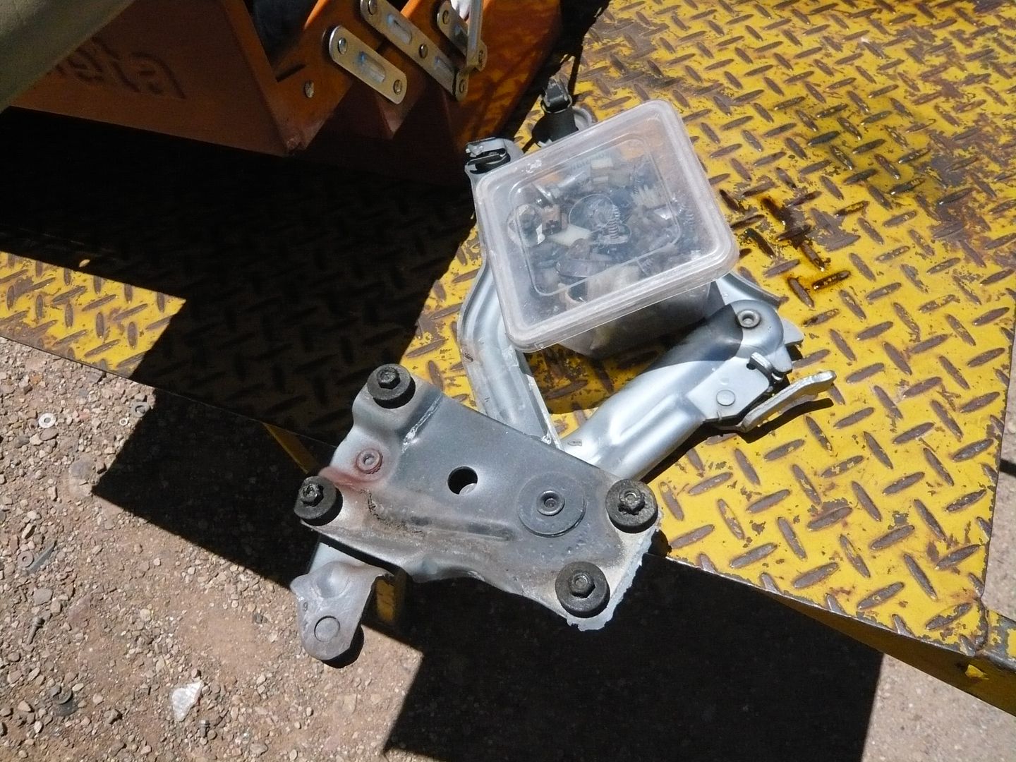

I couldn't work out what was wrong with the headlight except to say it appeared the level adjustment mechanism had become detached from the vacuum unit inside the housing. I have not had a chance to test it yet. It's amazing what a difference cleaning the glass and reflectors makes. Of course, now I notice the passenger side is slightly foggy!
This was the boot as I found it:
Some mindless violence and it's sort of pressed back into shape! I have a new grommet for the base and will paint the underside as previously mentioned.
So almost back together now:
The next step it so replace the indicator lenses after cleaning, adjust the headlight aim and check the vacuum aim adjustment. I will flush the cooling system and pressure test it. I'll need to do some work in the coming week, but the next item on the list is to remove all the door trims and have the paintless dent repair chappie to go over the entire car. Then removal of the plastic skirts along with the front and rear bars for repair and painting. Quite a bit more still to go.
Carl.

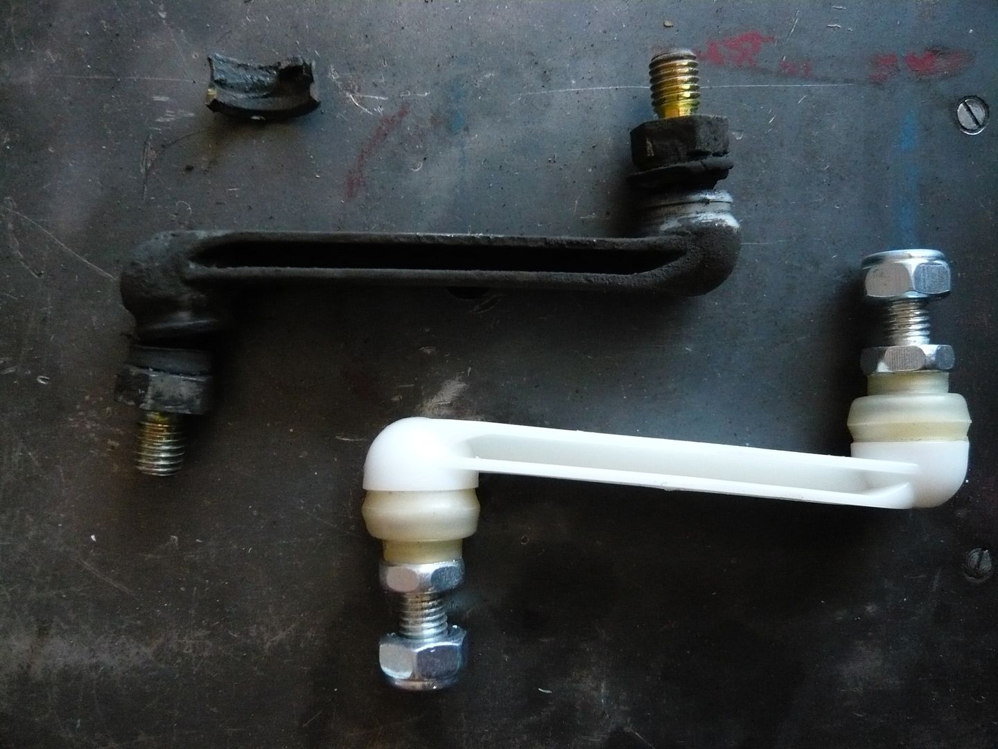

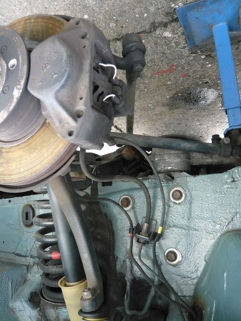

I had this intermittent ABS engagement at parking speeds. Whilst the wheels were off, I removed the ABS sensors and cleaned them. I was surprised how much build up there was on the end of the sensors. Not a great picture but here is the sensor after removal from the hub. You do have to be very careful as the locating part (Plastic) appears as if it would fracture very easily. I applied some rost-off to the unit and it came out slowly, the body of the sender is almost an interference fit in the hub. Note the "O" ring at the end. I cleaned it and applied some rubber grease and the sender fitted easily back into the hub. I then tested the car just in the driveway and it appears that the issue may be resolved. When I change the differential oil, I will inspect the sensor in the differential as well.

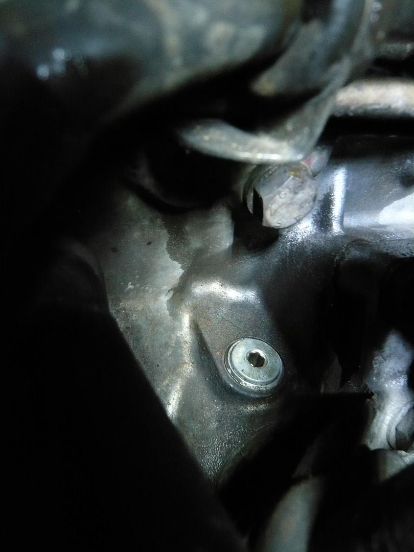

I've just flushed the cooling system. Including removal of the radiator drain plug and the two engine block drain plugs. I have some radiator flush, however, I noticed whilst the claim was that it was safe for aluminium engines, it contained potassium hydroxide. My laymans understanding of chemistry tell me that this is not safe for aluminium, unless perhaps the content is so weak to be of no consequence. Would anyone care to comment? I decided not to use it.
I drained the radiator and block then filled the engine with pain water, ran it up to temperature then allowed it to cool. I then drained the radiator and block again, but this time placed the garden hose in the various drain holes and flushed the system for about 30 minutes. I could not detect any sediment or nasties being expelled so it was either clean to begin with, or nothing was dislodged!
Draining the block is a little tricky because the drain holes (One per side) are tucked up under the mainfold:

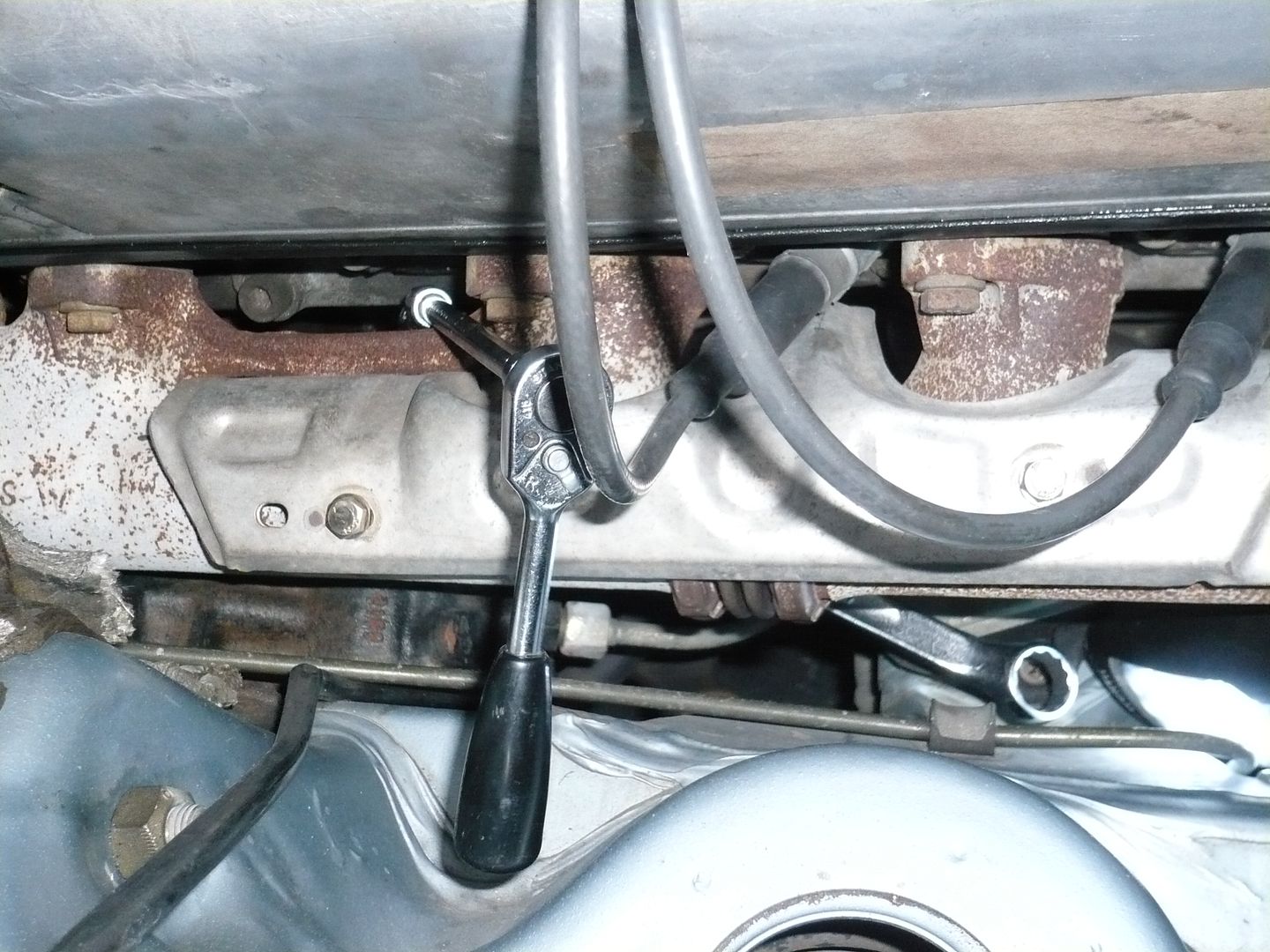

Note, the drain holes are the 6mm INHEX screws as pictured above at the top of the frame. NOT the 17mm hex nuts at the bottom, they support the three middle bearing caps.

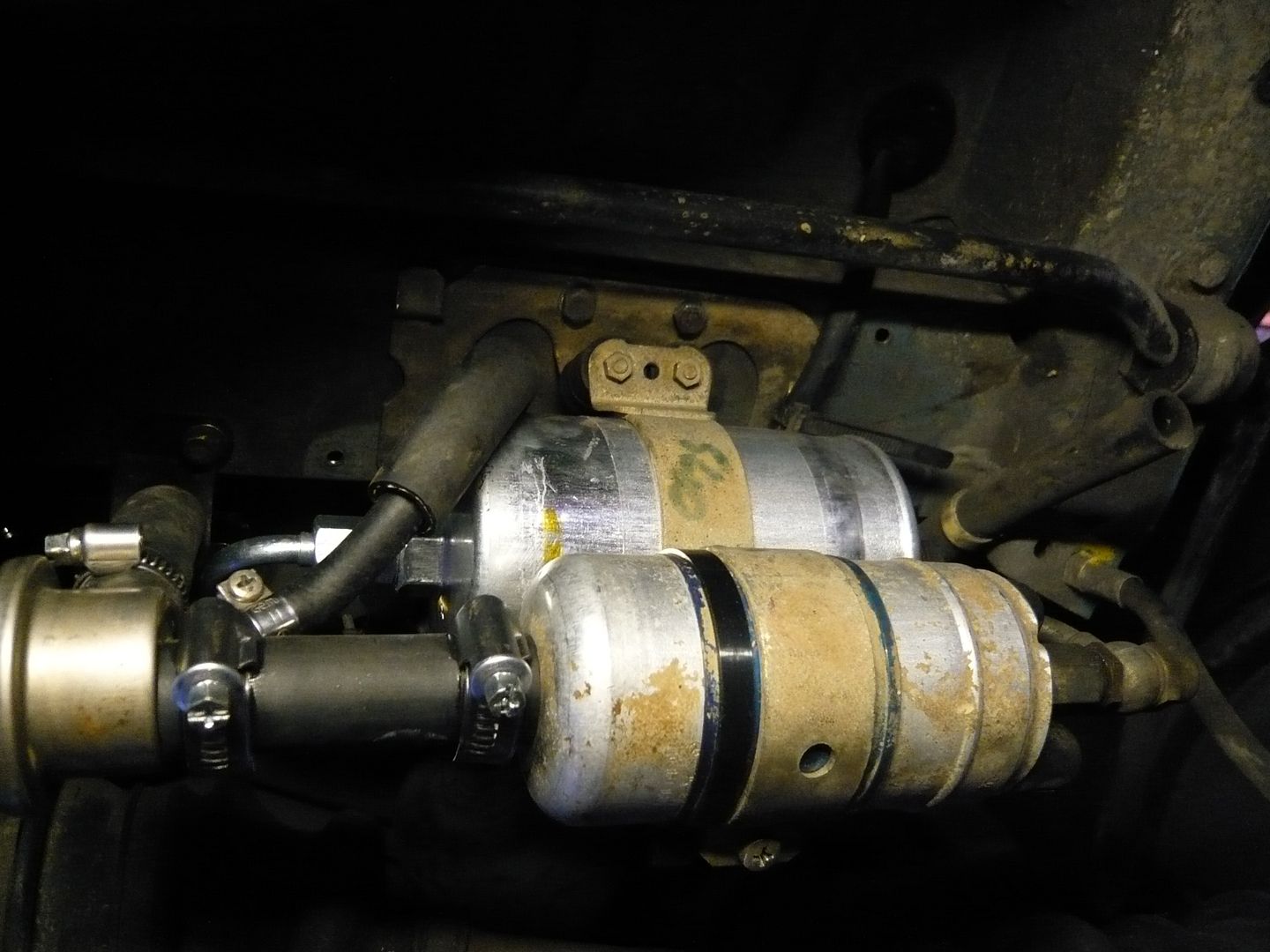

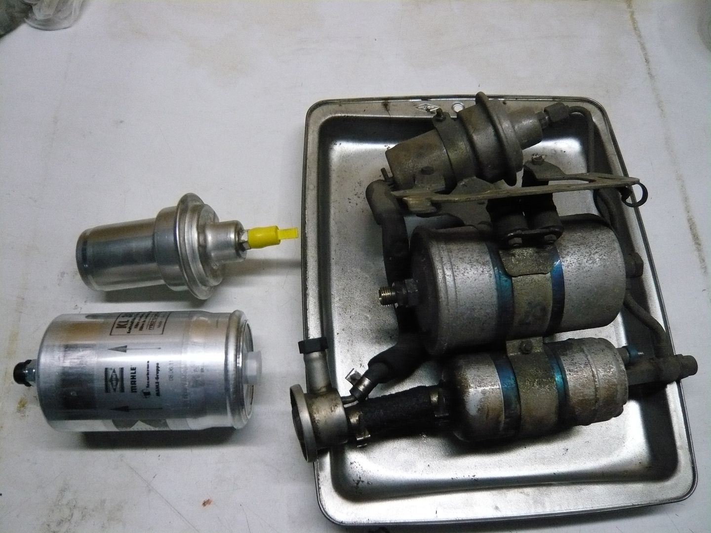

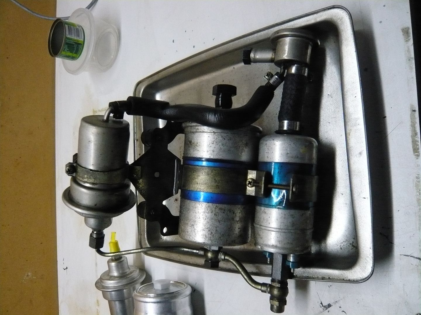

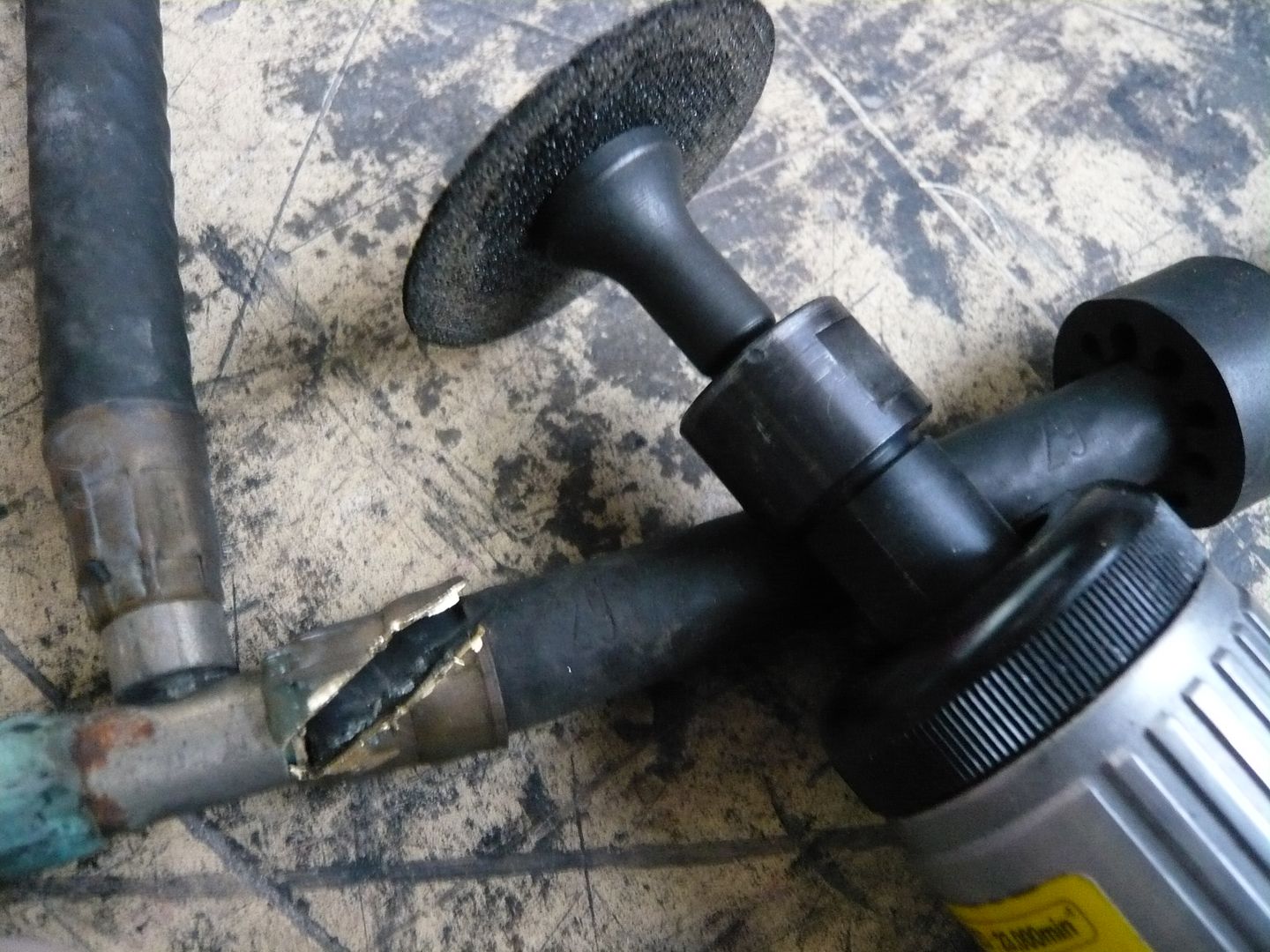

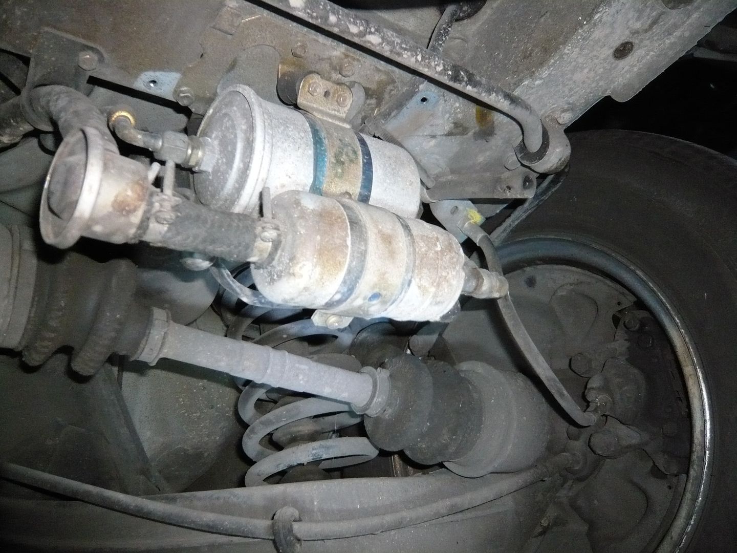

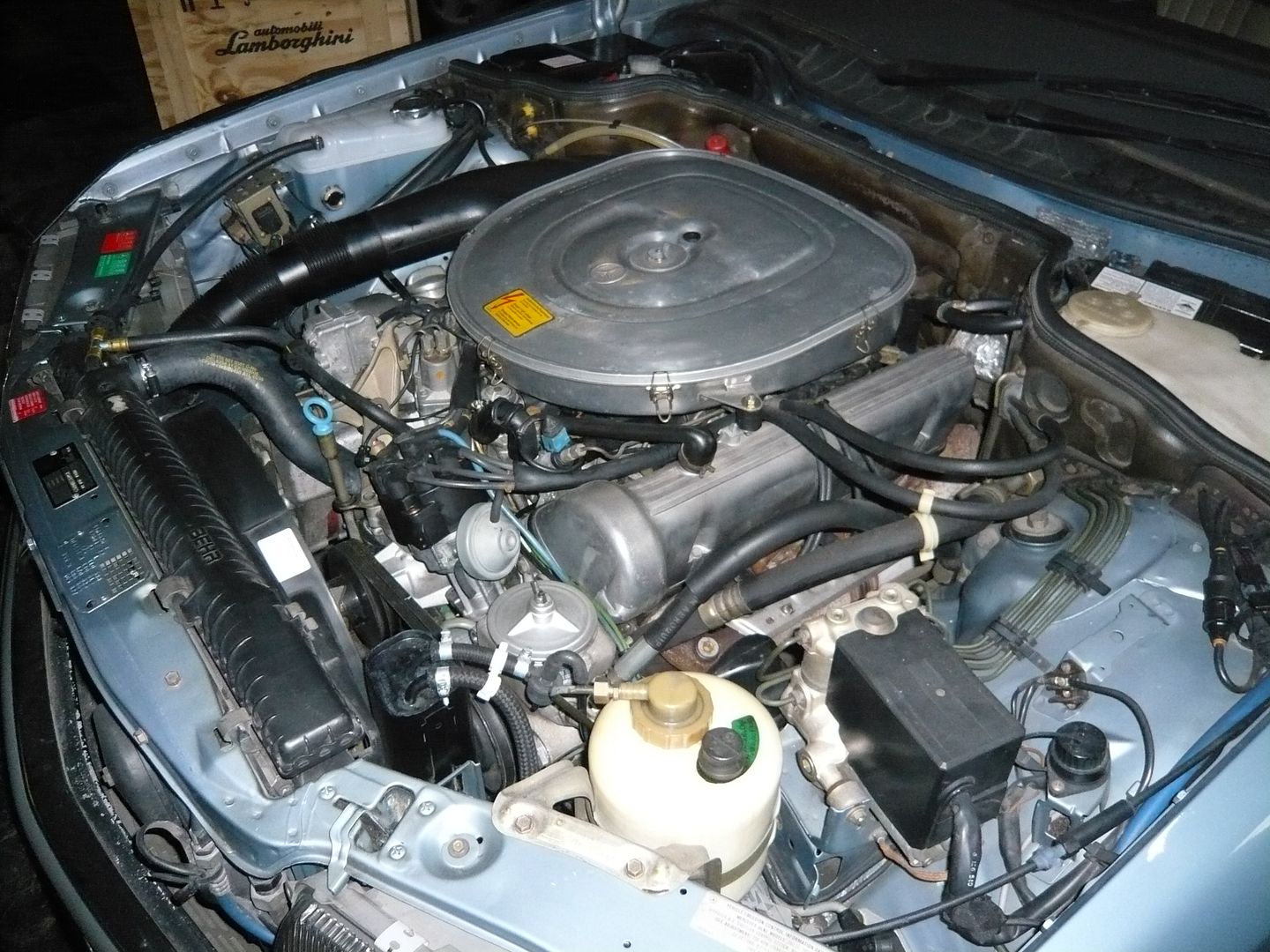

The car is due for some maintenance being at 110,000 kms so although an oil change is early, I'll do it to bring the schedule into line. First job was to change the brake fluid however, since that was last done a little over a year ago. I've been using this product from Penrite recently, it's a 600 degree F. brake fluid and I can't believe the price. It's about $25/500 Ml. which is extremely good value next to Castrol SRF or AP550/600 at over 5 times the price. Having a vacuum bleeder makes such work fast and mess free, and you can do it on your own.
I decided not to change the engine oil just yet, but instead change the fuel filter and the fuel accumulator (Thanks to kim for the suggestion re: the accumulator). Of course the snowball effect took a strong hold....

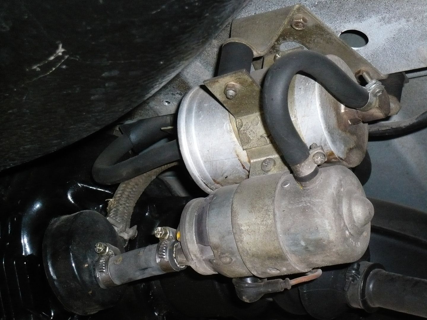

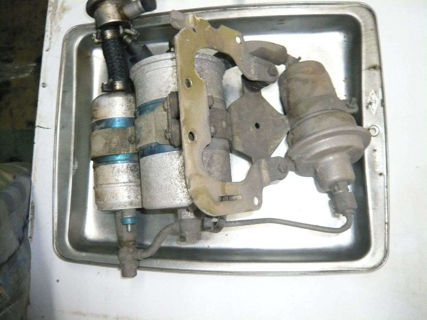

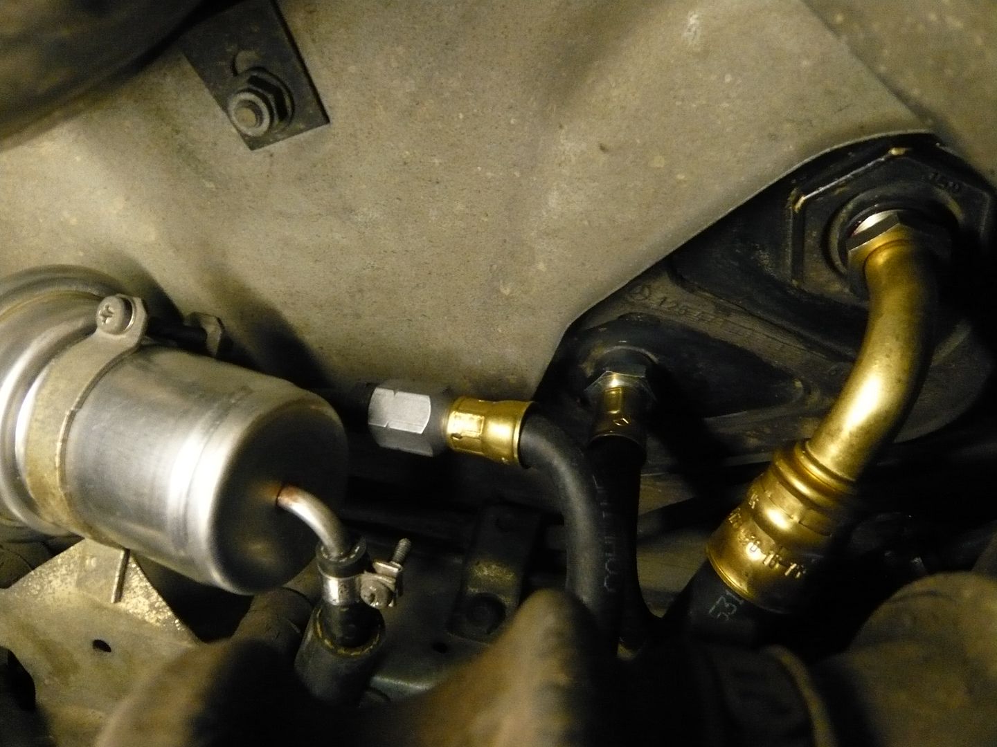

Rather than change the filter and accumulator in situ, I decided to remove the whole assembly:
There might be some more cleaning to do around here!
Ready with the new parts:

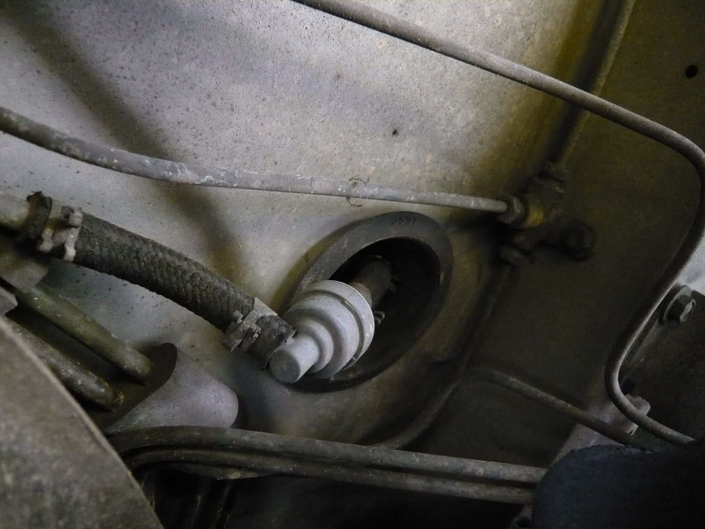

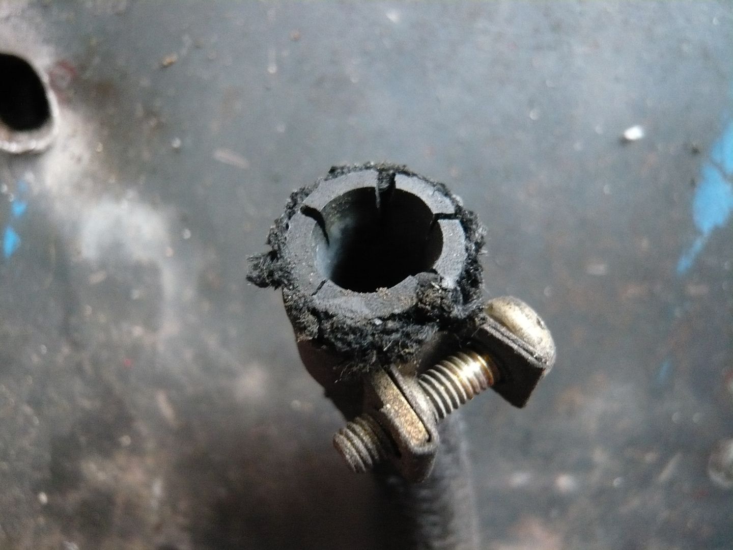

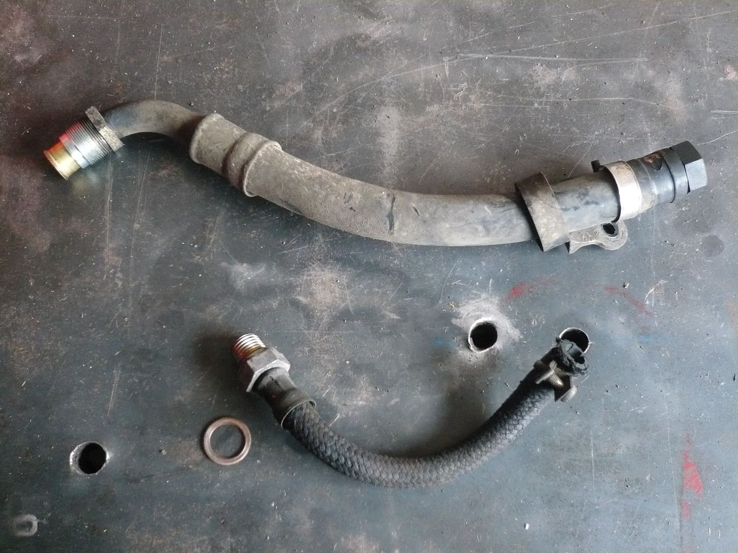

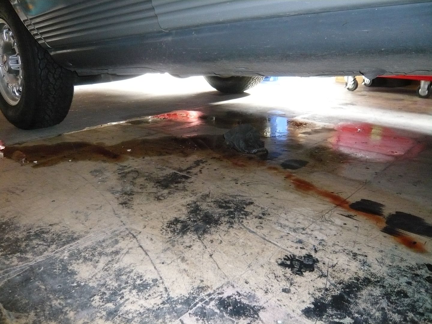

I threw a tantrum with the assembly, it was filthy. I plugged the open lines and threw it into the parts washer. It came up a little better.
1984 dated fuel hose, which is to be expected being a 1985 car:

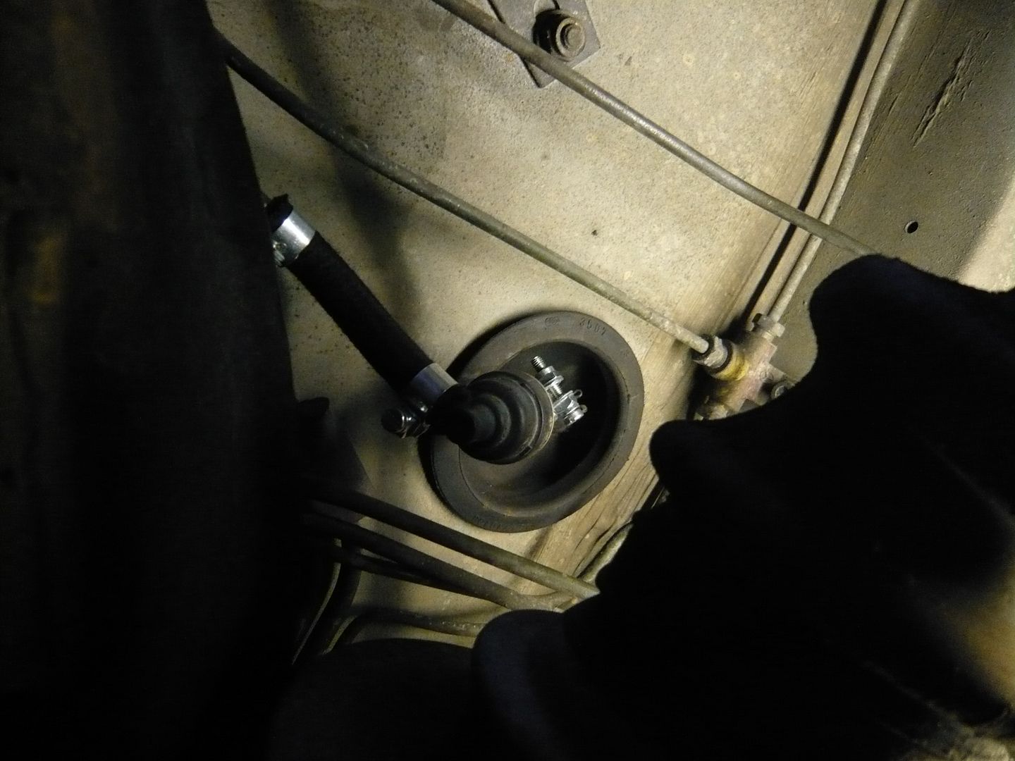

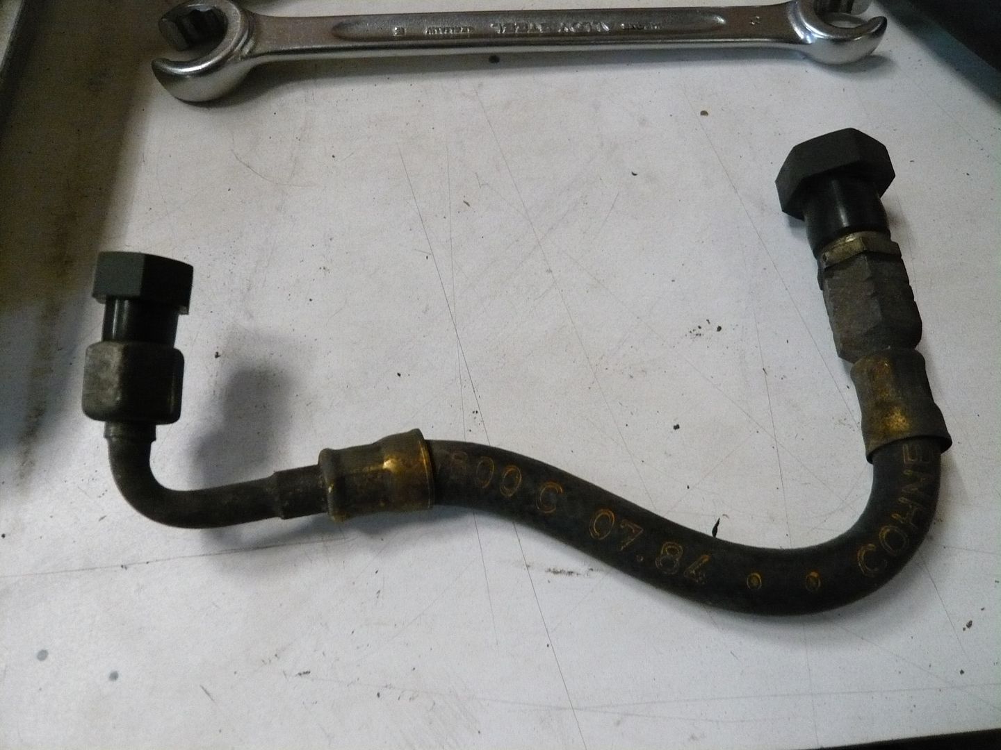

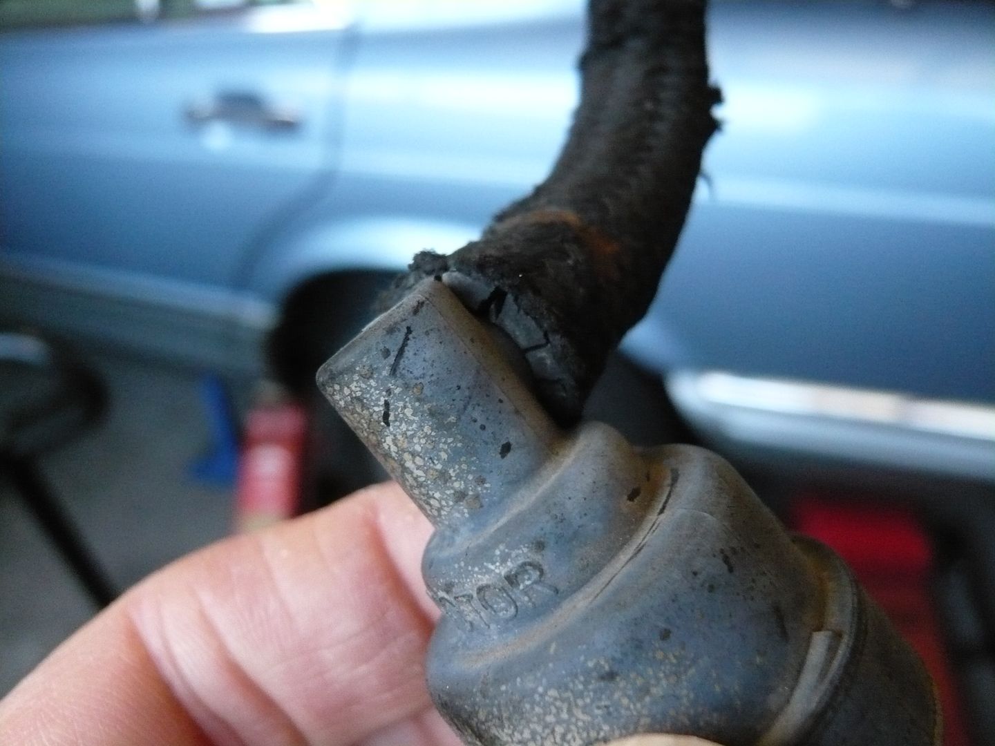

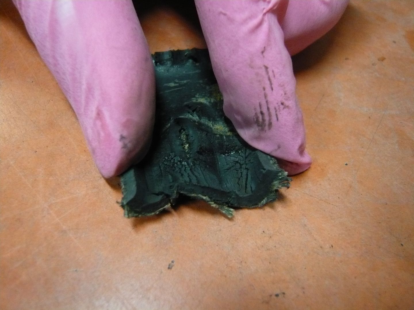

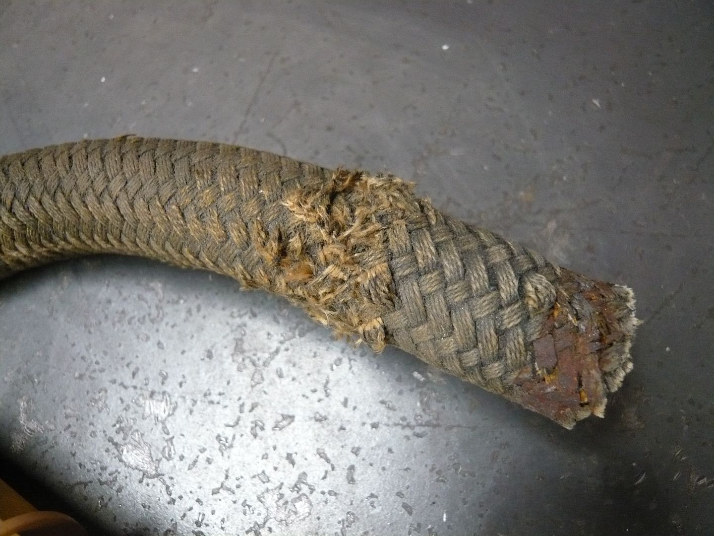

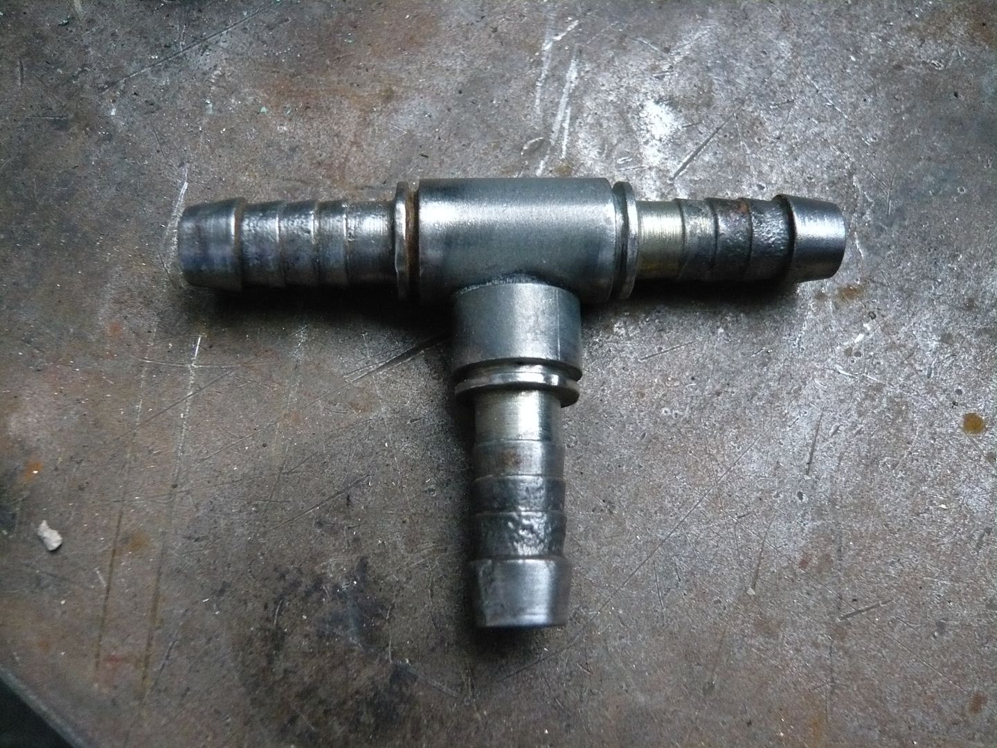

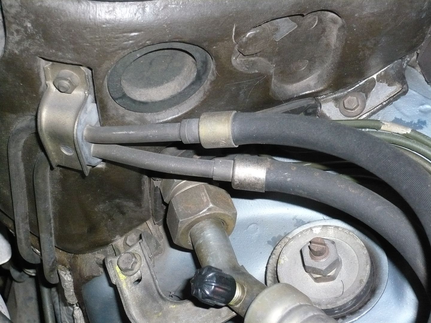

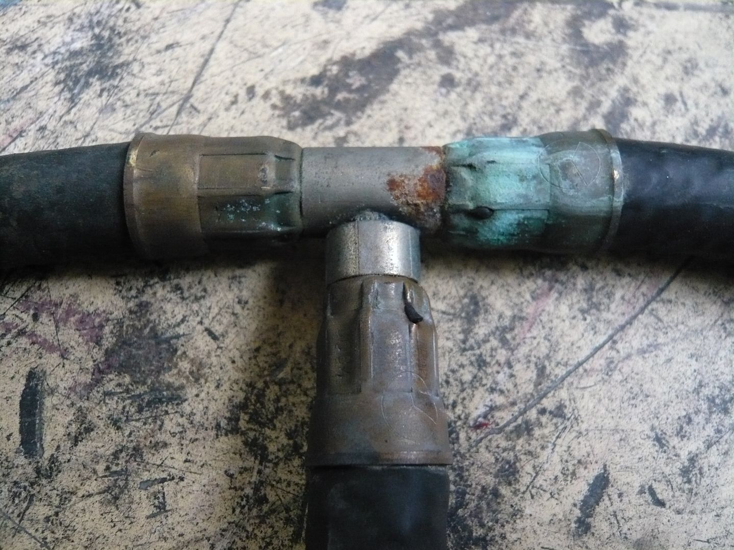

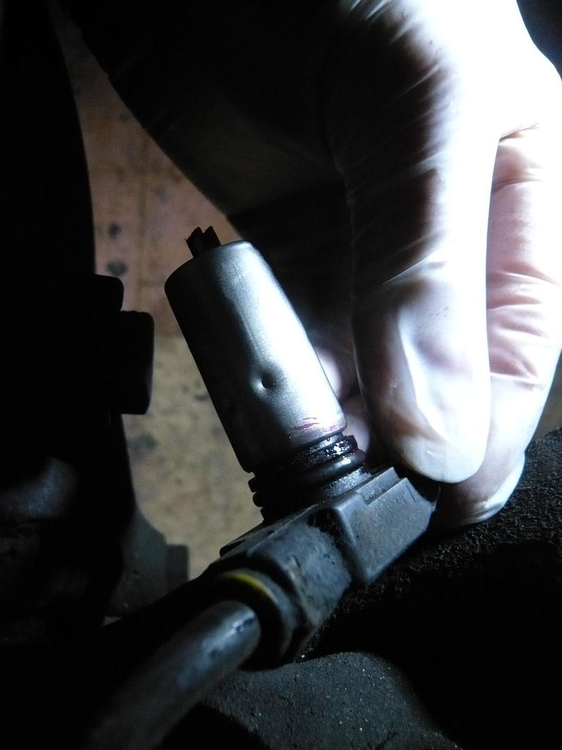

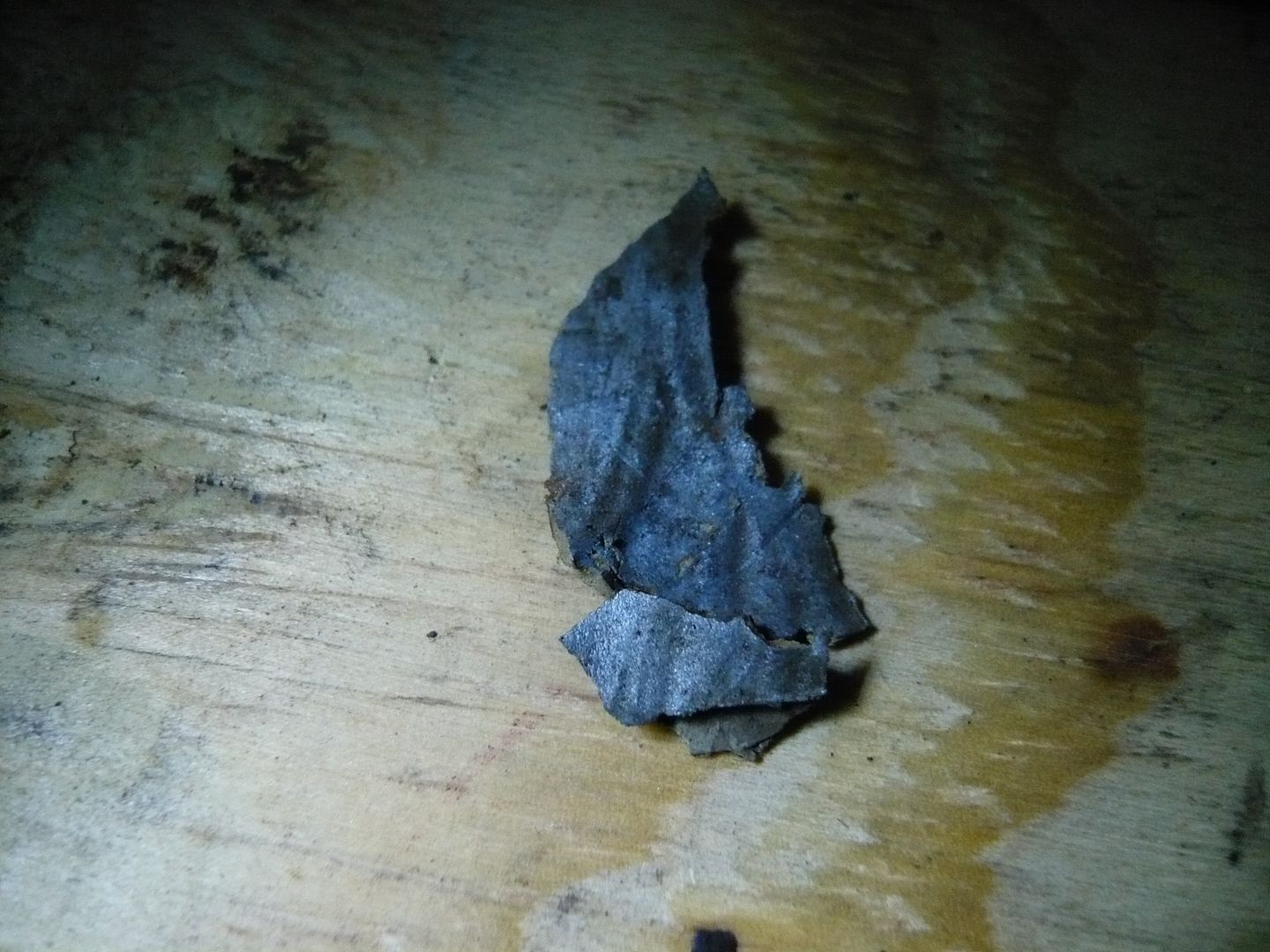

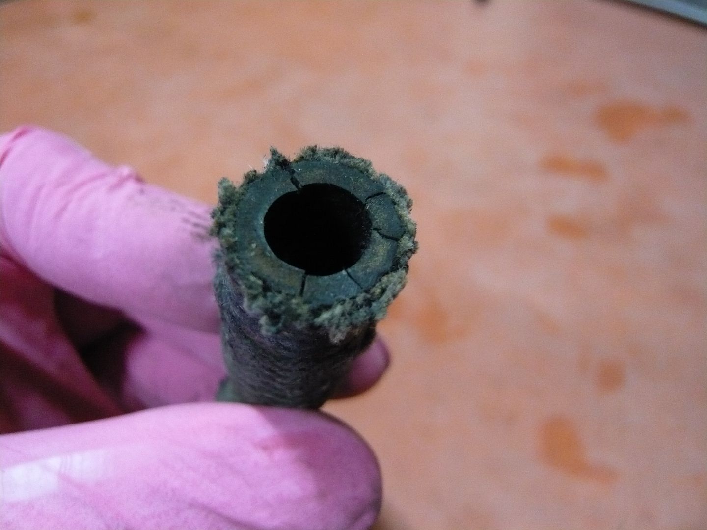

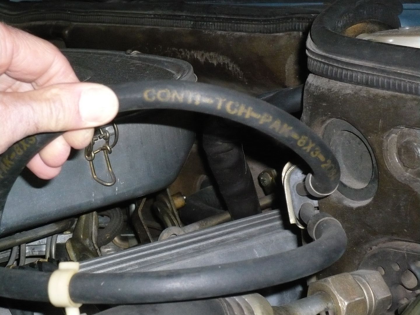

And so further investigation revealed this, two hoses, one at the rear of the accumulator to the fuel supply line and one at the pump intake:

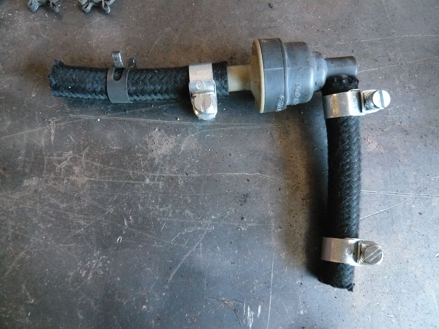

Sigh, luckily I had both hoses new and re-assembled the unit with the new filter, copper sealing washers, clamps and fuel accumulator. The bracket itself still looked grotty, the plating had tarnished somewhat. I toyed with the idea of re-plating it, but decided I wanted the car finished this year, not in 2017:
The hoses looked fine from the outside, and in fact were quite pliable, but inside was a different story. So the problem now is that I really have to do the remaining hoses, two at the bottom of the tank:
And the line with the fixed ends that runs from the outlet of the fuel filter to the solid steel line at the rear of the car:
They may both be fine of course, but I can't cut them in half to check! The resultant labour component if I have to do these remaining hoses at a later date not to mention the safety aspect of having the lines fresh entails that I do the lot now. I also noticed (Not pictured) that the return vapour lines from the charcoal canister to the tank at the rear were also cracked so they will be done as well.
Won't be able to get near it for a week or so but its getting there, somewhat slowly.

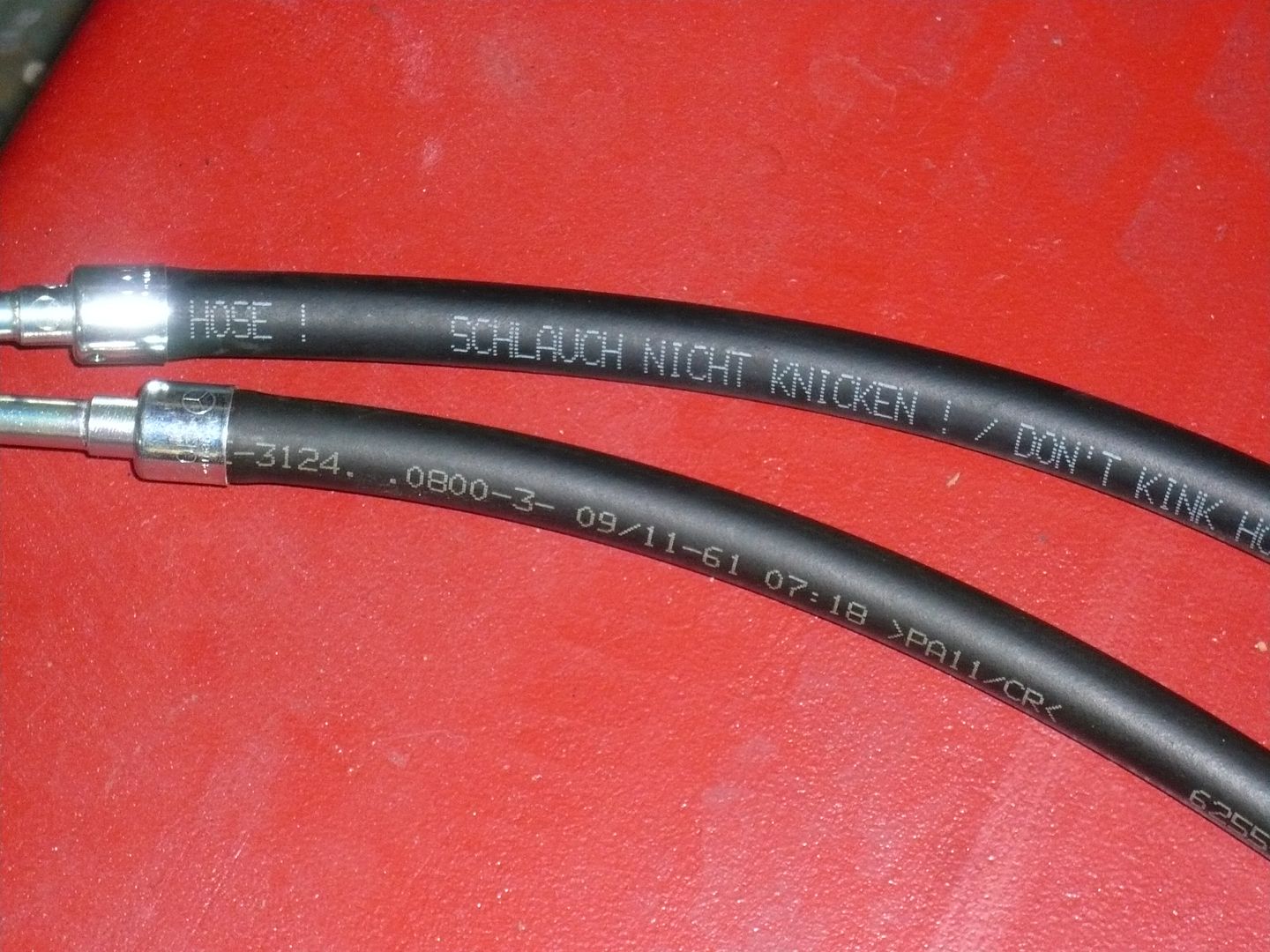

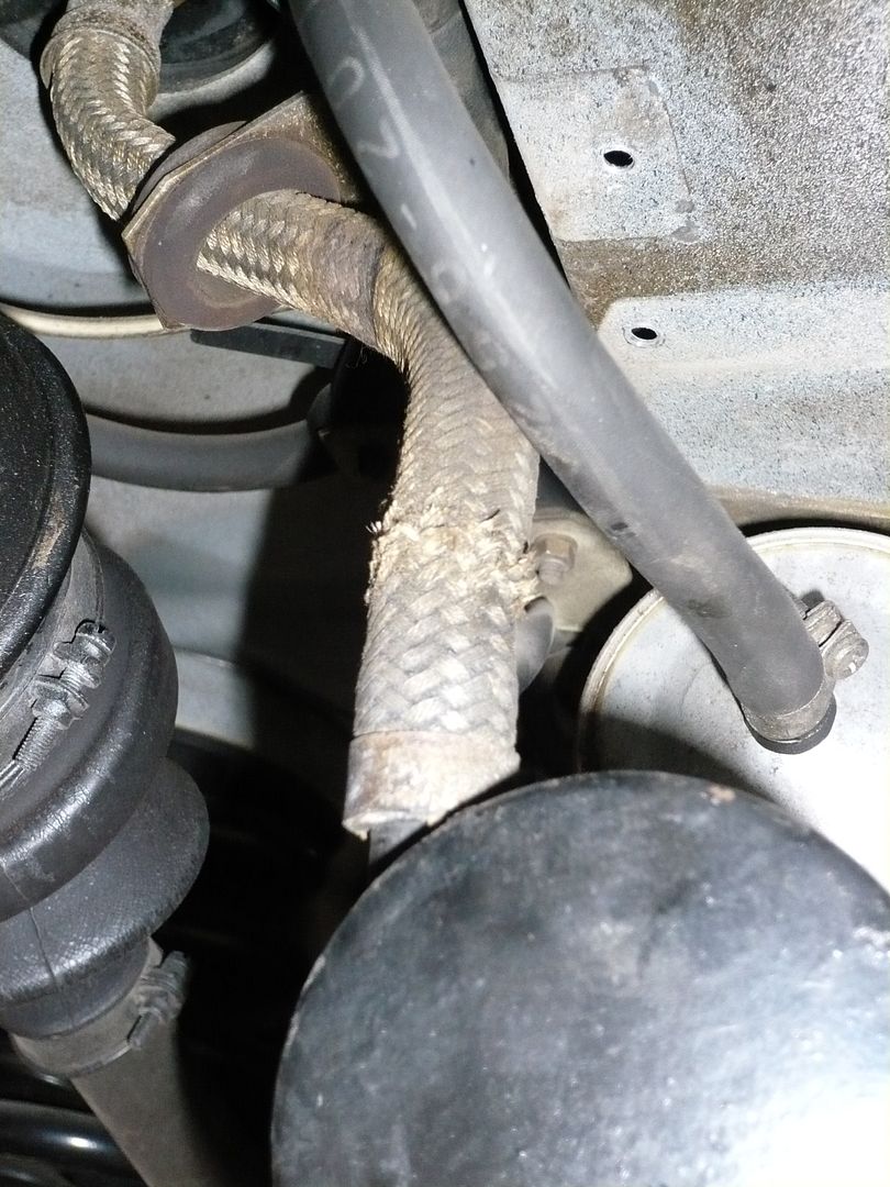

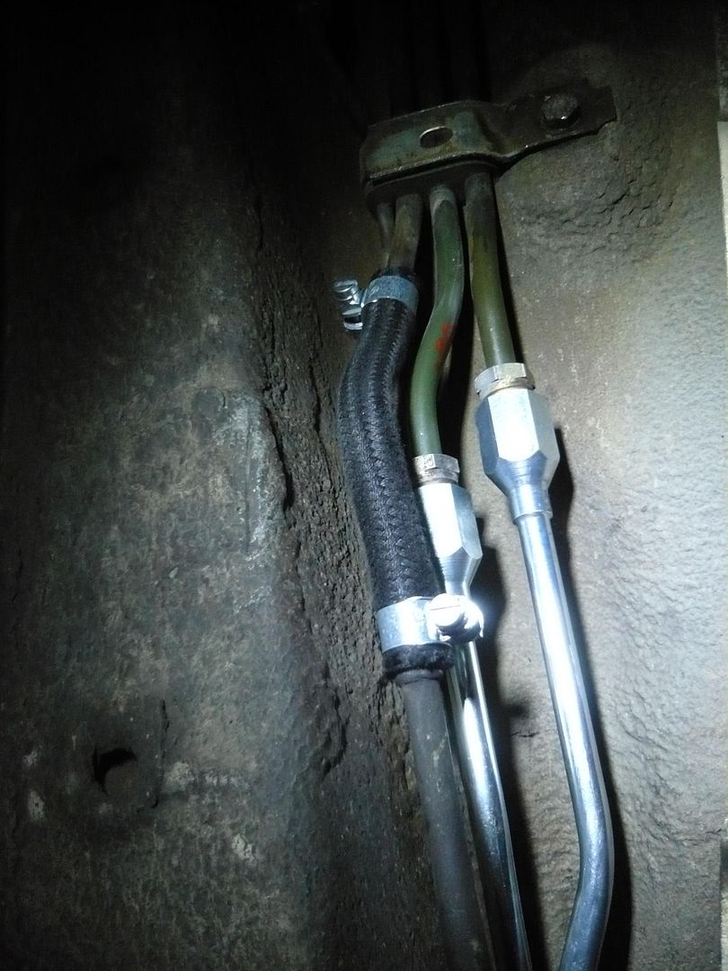

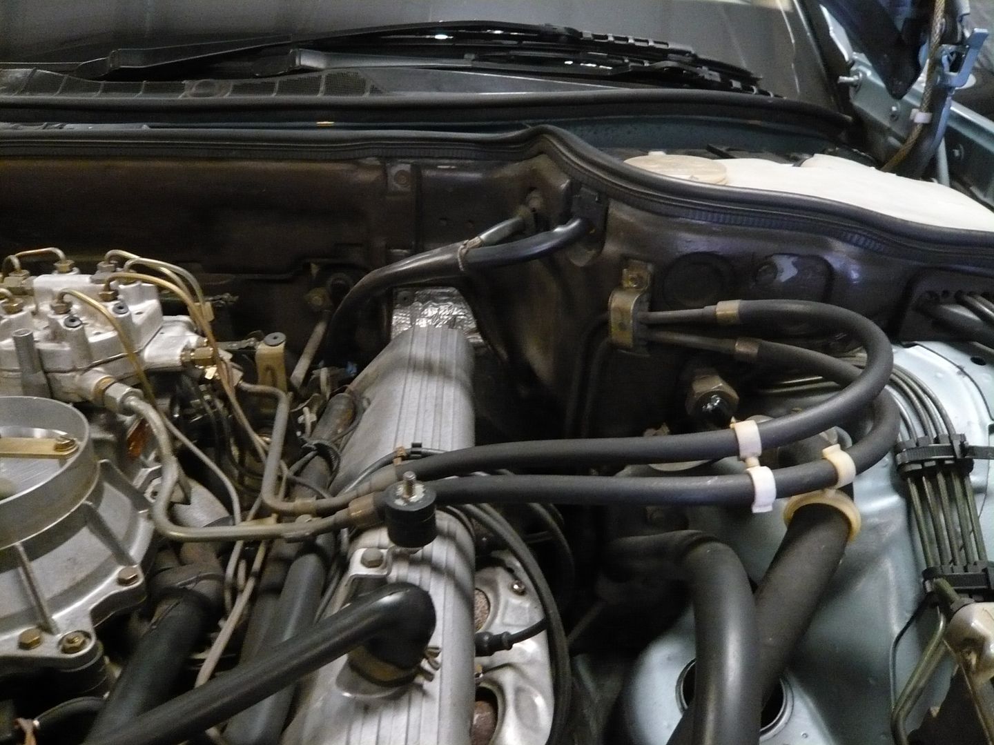

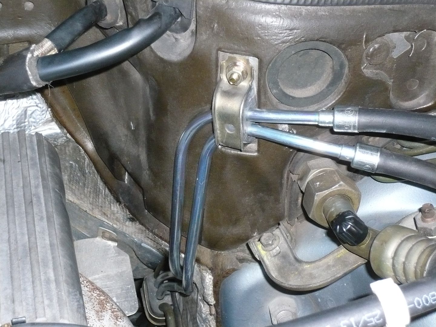

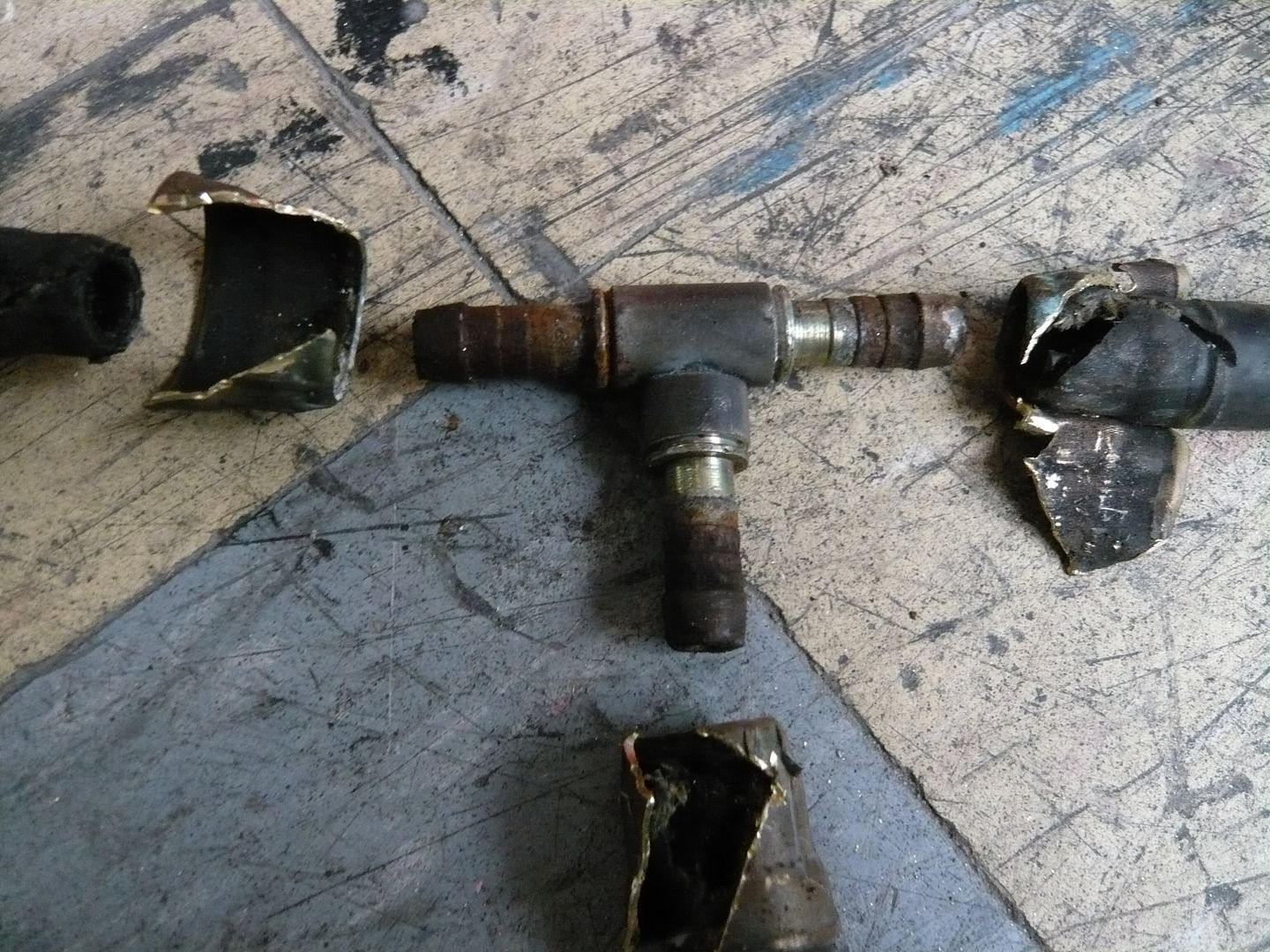

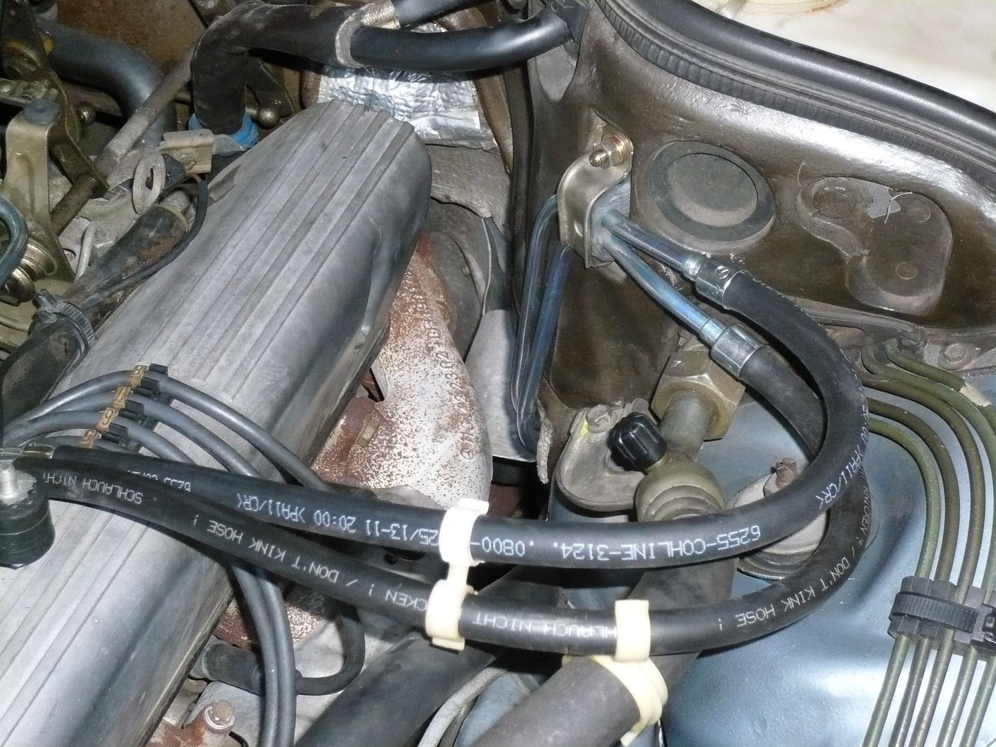

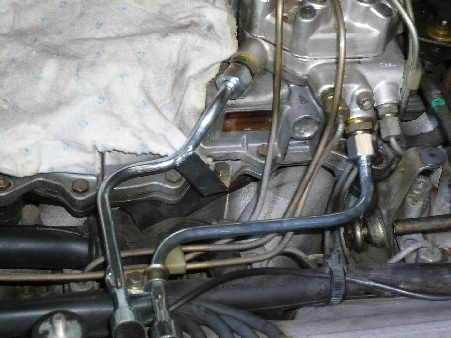

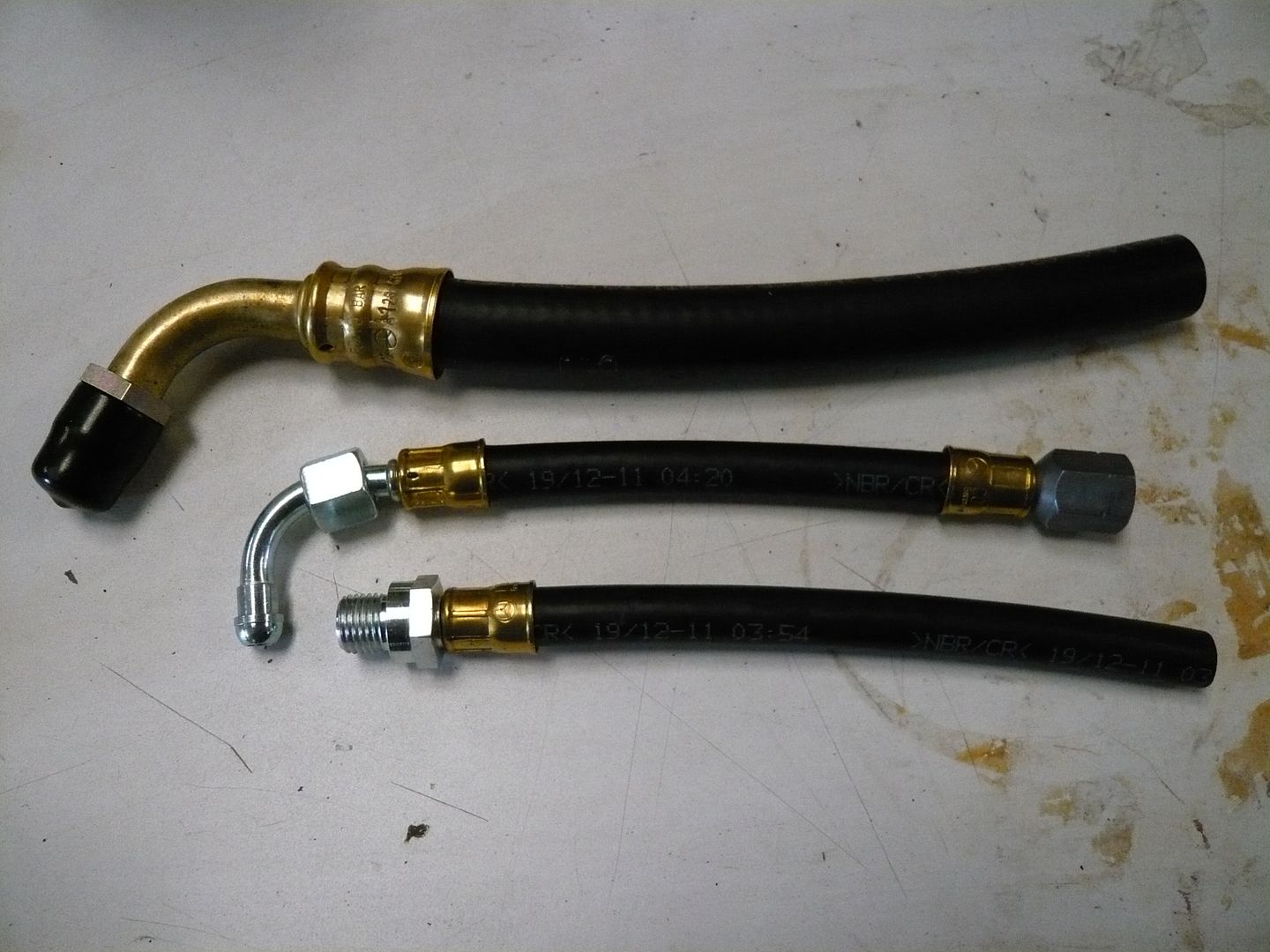

I just dug out some pictures of the fuel hoses I replaced on my 1974 W116. I performed this work in 2009 so the car was then 35 years old. I am guessing that the right time to do the hoses is before 30 years based on what I've found. The 380 SE is 28 years old being a 1985 car and I think it's time to do them now. The W116 at 35 years was a time bomb, see below for some pics of the original hoses as I found them:
Of course, we haven't discussed the engine bay fuel hoses. In theory at least, these should suffer the effects of age and use far more readily due to heat cycling from the engine bay. As opposed to the fuel tank hoses under the relatively cool and protected rear area of the fuel tank.
Having just had a look at mine in the engine bay, they do appear, sadly, somewhat hard and inflexible. They are made by Conti (Continental) and from the fuel distributor (Supply and return) on the LHS they run as per the pictures to the first firewall where they are crimped to a steel line then continue inboard of the passenger side chassis rail downwards and terminate to a screw fitting under the passenger side footwell. Some pics:
The other line in the last picture joined by a traditional hose is the vent line.
For the engine bay fuel hoses, list price from Mercedes-Benz is $362 for the supply line and $192 for the return, I just checked, yikes! Let's see what John G can do.

The engine bay fuel lines are a bit over half price in the USA compared to dealer list here not including freight, just did some searching whilst waiting for MB Spares to get back to me:
http://www.mbpartsworld.com/showAssembl ... =fuel+line
$170 and $92 USD + Freight + Currency conversion.
Some items are very competitive here, the tank strainer for example is about the same price here as the USA. There seems no rhyme nor reason to the MBA pricing.
On another matter, I decided to cut open the old leaky coolant hose "T" piece from the upper header tank/radiator/thermostat housing to see if it was re-useable. It is, as long as you don't mind using hose clamps on it rather than the original crimp (I don't have access to a crimping machine, but perhaps it could be done through Enzed or Pirtek)? Too late for me unfortunately, I already bought a new one.
Some pics:
And, a little parcel arrived this morning, the hoses for the rear:
It will be a few days before I can install them.

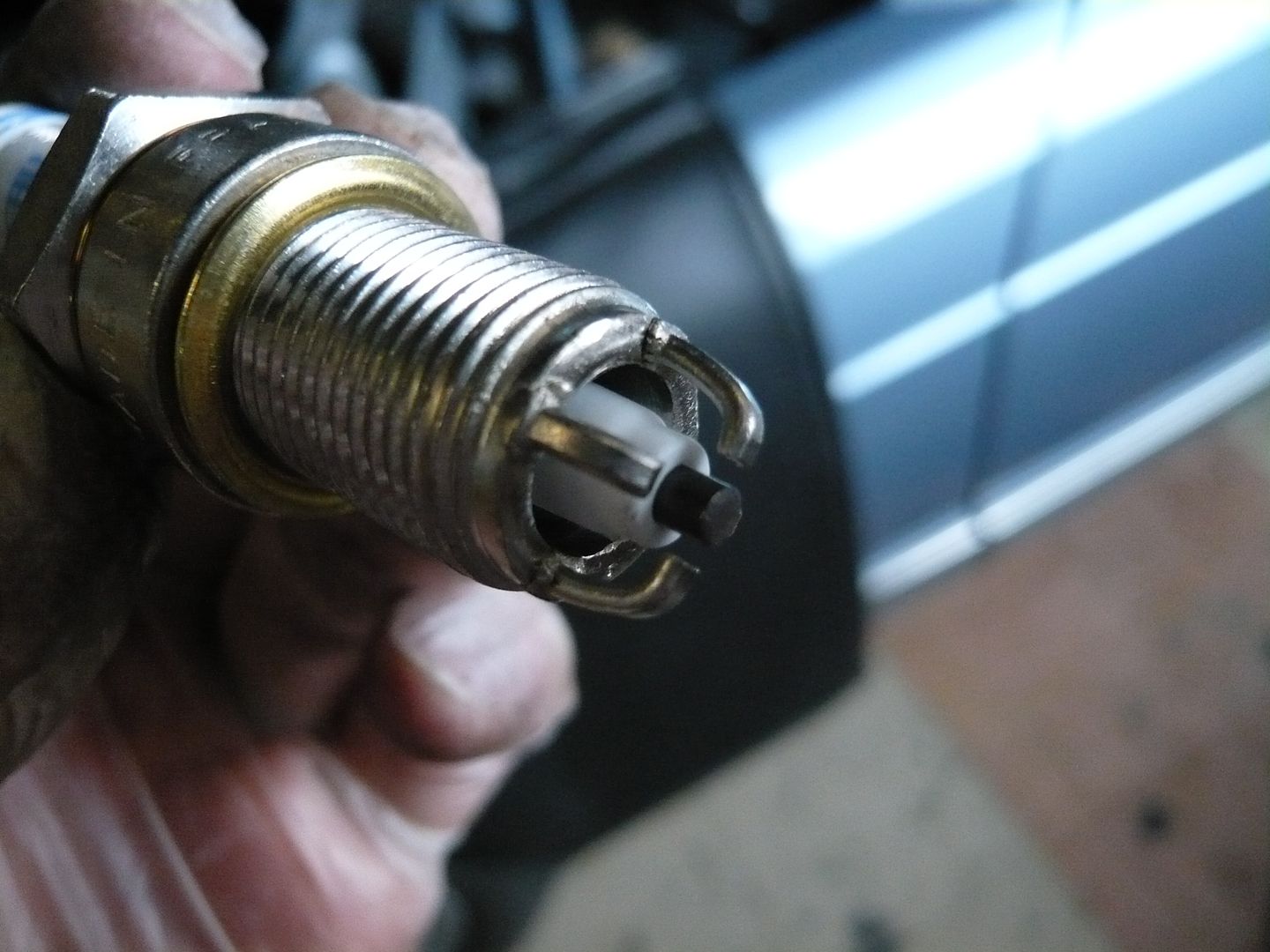

I decided to throw some decent plugs in it, some Beru UXT2, can't say I notice the difference over the NGK BP6ES that came out of it.

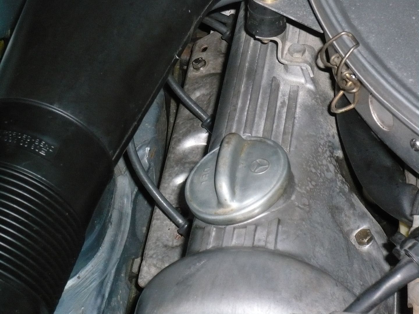

My struggle with the remains of the EGR has been resolved. On the LS side of the engine the EGR valve was finally relegated to the shelf thanks to the sump plug from a BMW K100 fitting the manifold beautifully. 18mm X 1.5mm thread.
It's very nice to see how uncluttered the engine bay looks with all that rubbish off. Not to mention the correct style oil cap!
I was surprised how difficult it was to remove the M8 screws that affix the heat shields to the manifolds. They were particularly rusty and I seriously thought I may run the risk of snapping off the screw heads. Luckily, some localised heat and plenty of Rost Off encouraged them off. Common sense prevailed and instead of replacing them with the same mild steel type, I fitted the same screws but in 304 stainless and lubricating the threads with nickel. I'll have to hide from the originality Police!

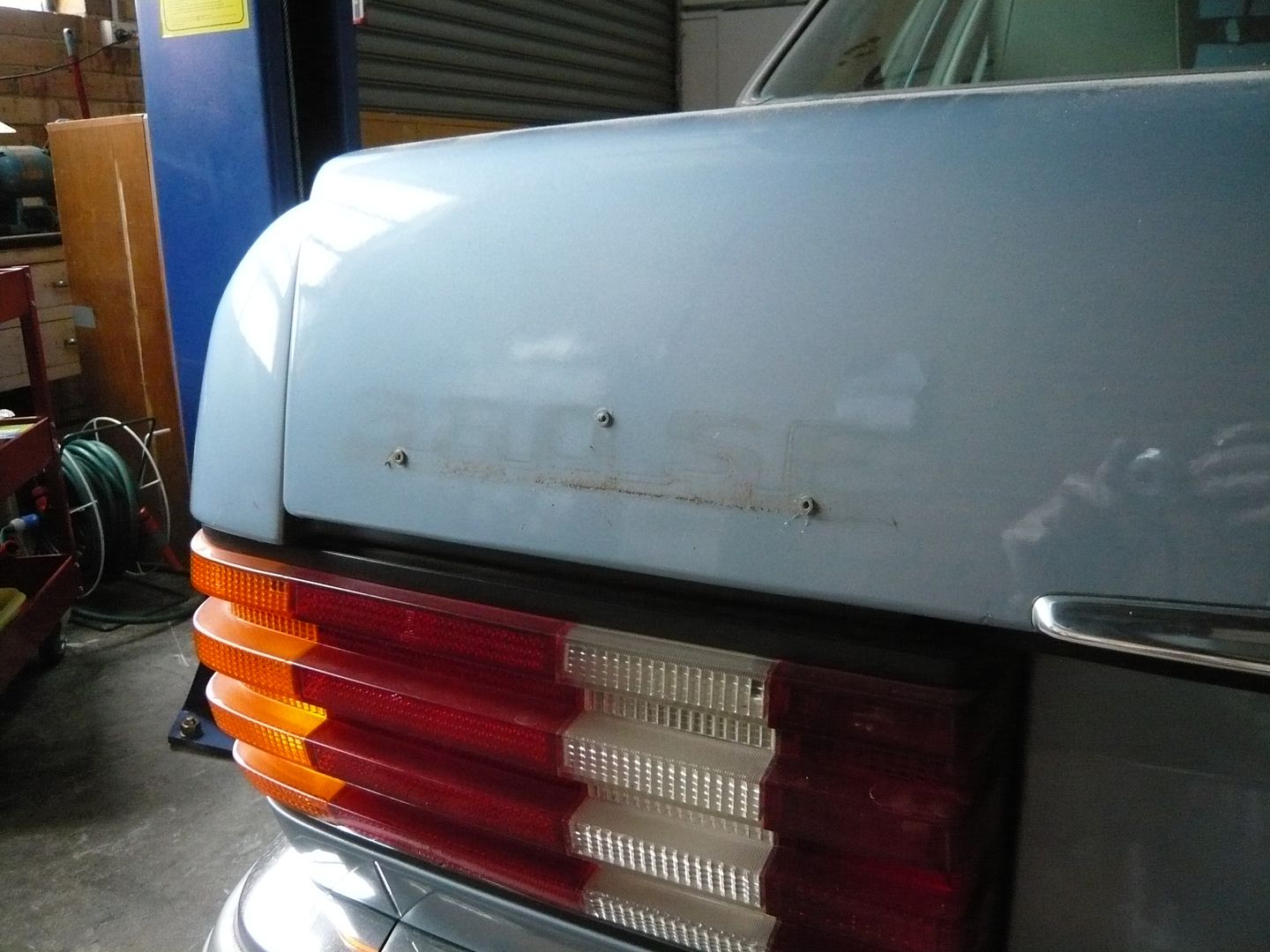

At Chris' I found a nice boot lid trim, mine was damaged. Of course, things snowball, so off came the badges for a clean.
Horror of horrors, I found some surface corrosion under the master cylinder when looking at the drivers side bonnet hinge. The only reason I detected it is because the seam sealant appeared to be bubbly. It appeared to have been applied slightly too thin in one area allowing water ingress. Luckily, it was only surface, and I treated the area with rust converter then applied a liberal dose of seam sealant, being careful not to block the drain hole nearby. The pictures should be self explanatory.
And the old sealant that just flaked off when I started probing around:
And the treatment, rust converter, wait a day, then the sealant:

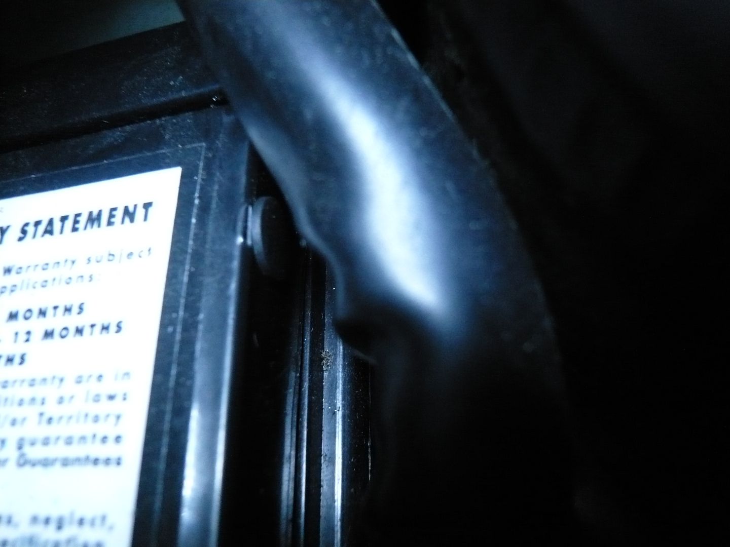

Here is something of which to be very careful. Make sure your battery has a breather hose, that doesn't exit into the tray (Even wondered why you see so many rusty W126 battery trays?). Most batteries should have two breather ports, one in each end. They are connected and you should just blank off the port on the side you don't use. In the breather kit, you should have a right angle adapter, the hose, and a plug for the port you won't be using. The pics should explain it.
Back to the spare wheel well area, it was dented as pictured in a previous post.

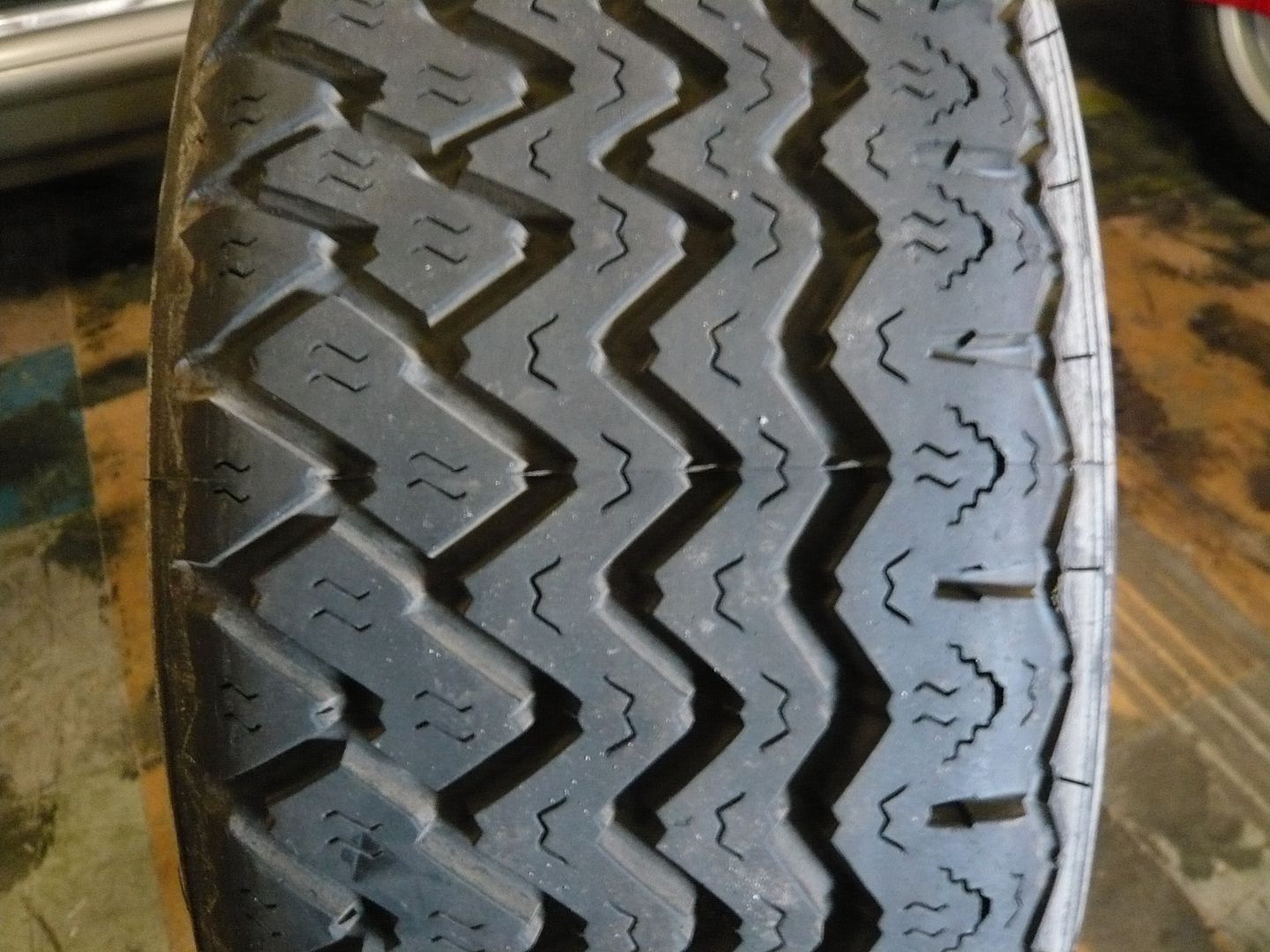

And, all happily back together with the correct 205/70-14 XWX spare.
You may recall the wheel issue, where I managed to source four "Spare" wheels to replace the kerbed originals. It ended up being very cost effective compared to painting (Which to do properly, is very expensive). However I still needed a decent fifth wheel for the spare. So I decided to paint one of the the originals myself.................with a spray can! Here we go....7 coats of base silver and 5 of clear. The match is alarmingly close. The base coat has a little too much metal and you can see it with the wheels side by side, but as a spare, it will do until I turn up an unused spare.
I let the rim cure in the sun for a week before I fitted the tyre. No knock on weights of course.
I accept that much of this displays all the hallmarks of OCD to most and there is no rational reason to spend time resurrecting such a clinically uninteresting vehicle. However I like to do things to the best of my ability and despite the time and the cost, I believe it to be a noble endevour. Having said that, if there was only one job that I would perform apart from regular maintenance, I would strongly advise anyone to check the fuel hoses. Not just on a Mercedes-Benz of this age, but any car of this age. The following should be self explanatory. Part two of the fuel hoses...

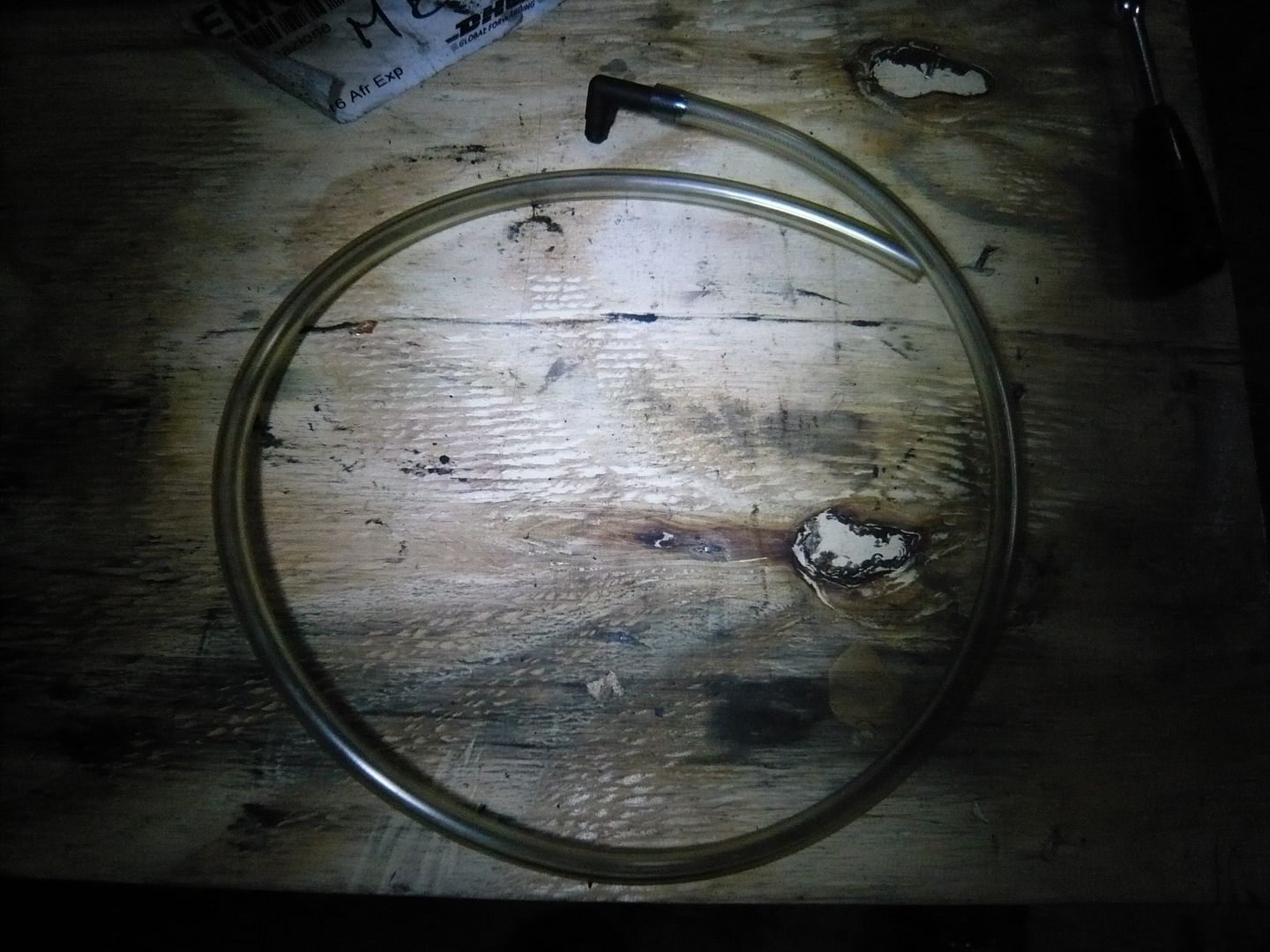

And the new hose going on. The first two images is the line from the charcoal canister.

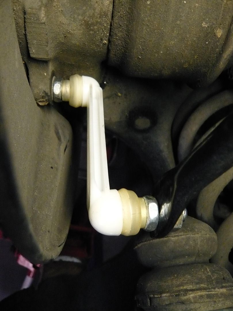

Whilst fitting the new tyres and rims, I noticed the rear anti-roll bar links were worn. Small somewhat feeble looking plastic links, they seem to do the job but time for replacement. It appears the rubber gaiters over the ball joints perish exposing the innards to the ingress of contaminants. They would wear very quickly after that I imagine.
The car was sitting for 6 weeks whilst I was working on other projects. One morning, this was the sight that greeted me! The leak is from the automatic transmission pan seal. It's on my job list.

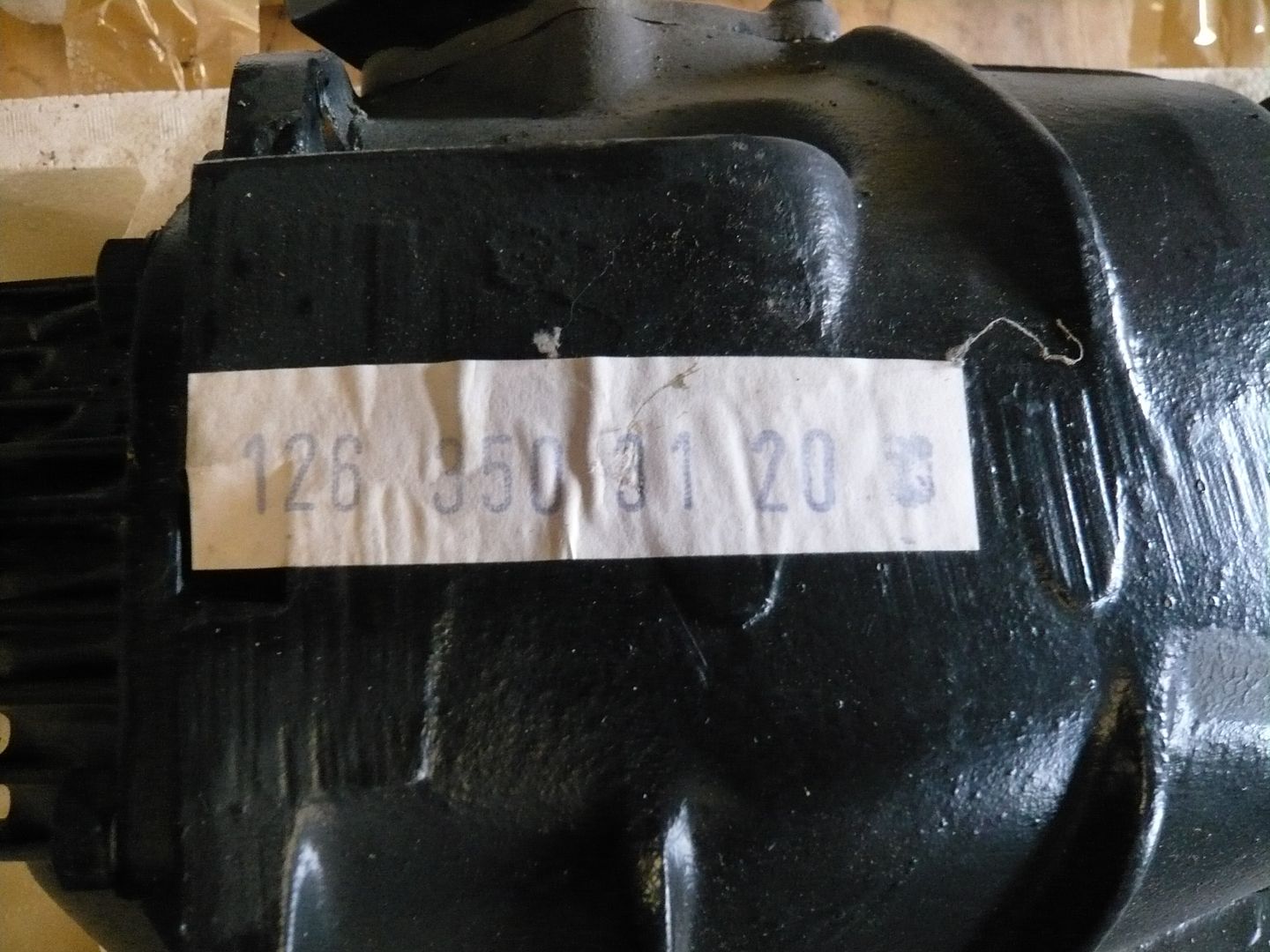

As the front was off the ground, I adjusted the steering box. Initially it looked very difficult to adjust, but with a 19mm ring spanner and a 1/4" drive 6mm INHEX between the head and the manifold it was done.
One thing that was bugging me was the bent drivers side bonnet hinge (I bent it accidentally on the hoist you may recall). I toyed with the idea of straightening it but decided to source another from a wrecker as it was riveted together and the chance of getting it straight somewhat remote. Of course the odds of finding an excellent condition W126 Diamond Blue 355 drivers side hinge was rather low, or so I thought. A friend suggested I try "Pick-a-part". So I headed off to Campbellfield armed with a toolbox, a hat and gloves.

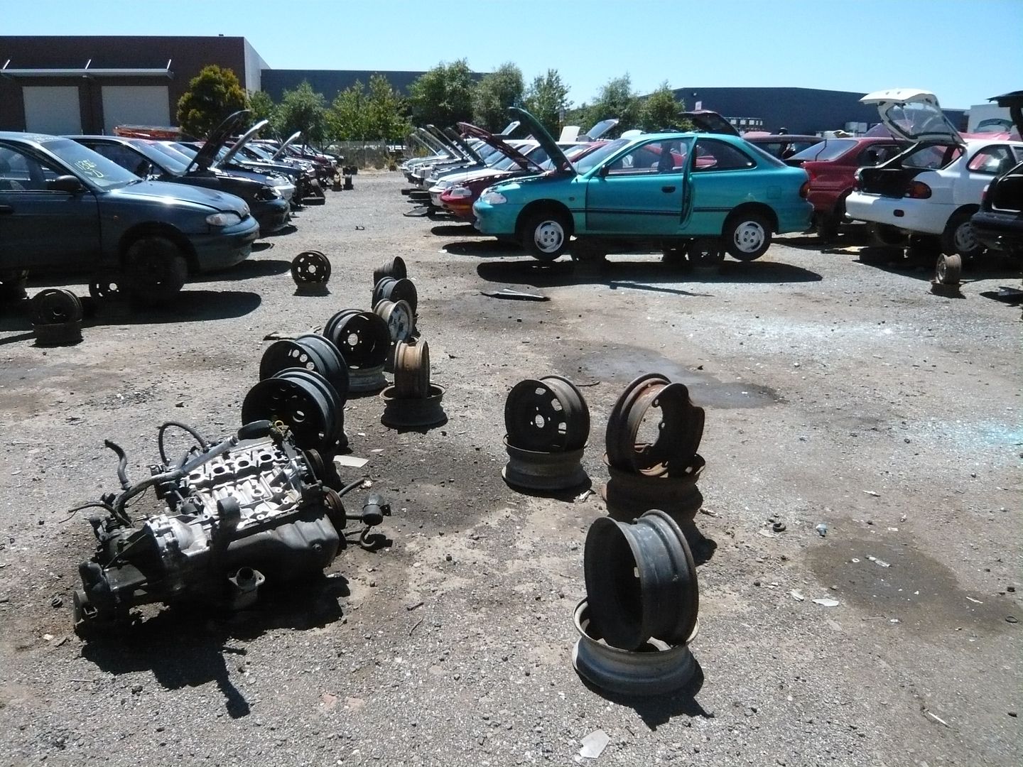

For those unaware of this concept, you simply pull off the parts you need yourself as no one is there to help you (After paying $1:00 entry fee) and go for your life. Pass the parts past the cashier on the way out and that's it! This is the scene that greeted me upon entry, somewhat apocalyptic with a definite Mad Max bent.
In the "European" section, I was surprised to find a Diamond Blue 355 380 SEL! And so I set to work.
Well, four hours later I had a bonnet hinge, an alloy wheel for the W123, assorted clips and clamps and amazingly, an untorn drivers side "B" pillar trim in cream 275, joy of joys!
Fitting the hinge was easier than I thought (But it helps if someone can hold the bonnet!). The bent hinge is pictured below, you can see the curve on the pantograph arm. This manifested itself by pulling the bonnet too low in relation to the front fender. Very annoying, since I bent it myself.
Cleaned up and lubricated hinge ready to go on.
I noticed when I bought the car that someone had replaced the drivers side front wing and fitted and incorrect rear bonnet pin. Pick-a-Part to the rescue! The advantage of these items of course is that they are already painted the correct colour.
Another thing I noticed is how the black paint under the bonnet is applied after the hinges are fitted. When the clips are removed, you can see the shadow from the clip.
Having a look inside the front wing whilst tightening the hinge screws I noticed that when it was replaced (The front wing that is) no cavity wax was applied to this new part. I checked in the workshop and it indeed refers to the application of cavity wax in the event of repairs. This repair is obviously of poor quality so I will address this issue shortly.

What I didn't mention in the section re: wheel painting, was the preparation. I turned the wheel on the tyre changer and used a round file to take the curb rash off the rim outer. I then rubbed the wheel down with 1200 wet and dry, washed it in brake cleaner and left it to dry. Blasted the wheel with compressed air and painted it inside and out.
The wheel did come up very nicely and I admit I was surprised how well it came up but the process was quite time consuming, a few hours for one wheel. Like all paint jobs, it's all in the preparation, the painting itself took only 20 mins or so.

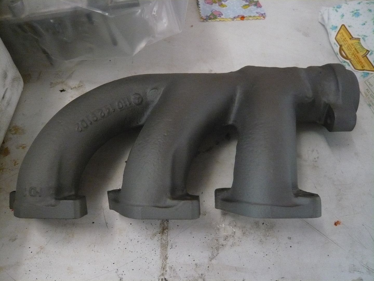

Just completed probably the most time consuming, frustrating and tricky job of the resurrection of this hopefully once pitiful vehicle. The replacement of the fuel lines from to the underside of the car to the fuel distributor. The process sounds straightforward. However the problem was that the new lines did not quite follow the same profile as the old ones. Meaning I had to install them, mark where they needed to be bent, remove and bend, then re-install. Each line could not be bent in one go, I had to remove them multiple times, for each one (Supply and return). For some reason, even following the profile of the old lines didn't quite work. I even found the utterance of some choice language failed to provide the necessary relief. In all, about 8 hours labour, grrrr. Still, it's done, and the new lines are particularly pliable compared to the old ones. Being fussy, you could complain the zinc chromate finish is not as nice as the original yellow chromate however I can live with that...
Late last year I attended a MBCV swap meeting and of course didn't intend to buy anything. I found a N.O.S. 3.27:1 differential in the box for sale. What caught my eye was the 'Limited Slip" tag on the rear. My father bought a new 380 SEL in 1983 and ordered it with a LSD. When he traded the car three years later, the salesman at Lanes Motors South Melbourne told him he was the only nutter to have ordered a 380 of any description with the LSD option. Dad of course poked fun at my car as it didn't have an LSD. So of course I took it around to show him. Fitting this unit will not be a priority, but I know it's there. Of course, I bought some other things I didn't need. I can sort of justify the mirror purchase as they cost $20 each, and mine both need paining as the silver has peeled off.

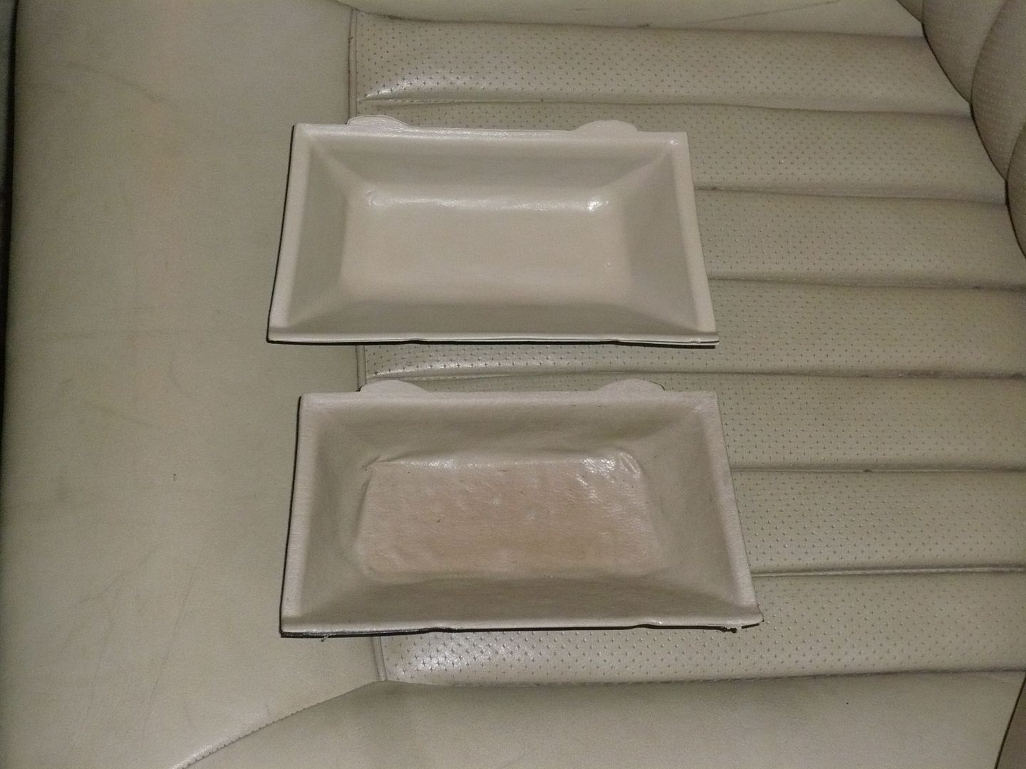

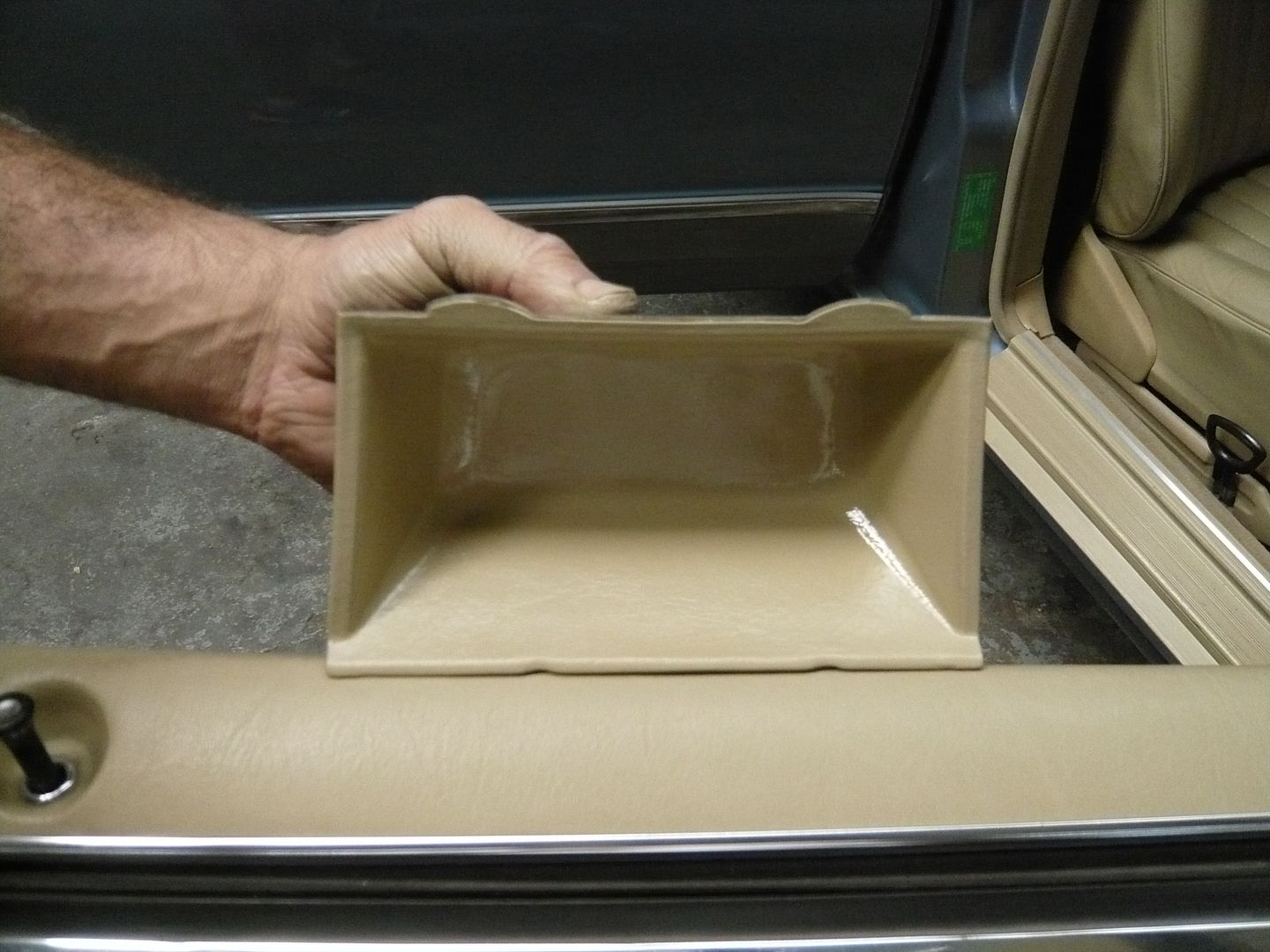

My battle continues with the centre console coin tray. I purchased another however it was not that great. It's often startling how some small items can get away from you time wise. I re-stuck the trim and although in the correct trim colour (275, cream) it was somewhat battle scared and stained. Unusable.......I decided to enlist the help of Billy from Leather Creations in Richmond, Melbourne. He's a genius with colouring vinyl and leather, along with leather restoration itself. I can thoroughly recommend his work and have provided his details. Today he recoloured the tray in the base coat, tomorrow will be a final colour check and if a match, he will coat it with a matte clear. We will see. The pics show the tray after cleaning, a somewhat Heath Robinson device concocted by myself to keep the tray flat whilst the adhesive was doing its work, Billy applying the colour and finally a colour check with the trim of the car.
Whilst the tray was being attended to, I decided to have a bit of a play with some cleaning materials. Have a look at the results of using this vinyl cleaner named "Dissol" It's amazing! Can you see the cleaned section of the trim? And I'd cleaned it with a decent cloth and soapy water when I bought the car. Looks like I'll have to go over the whole inside.

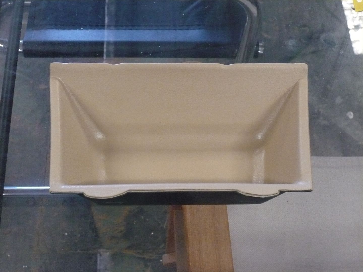

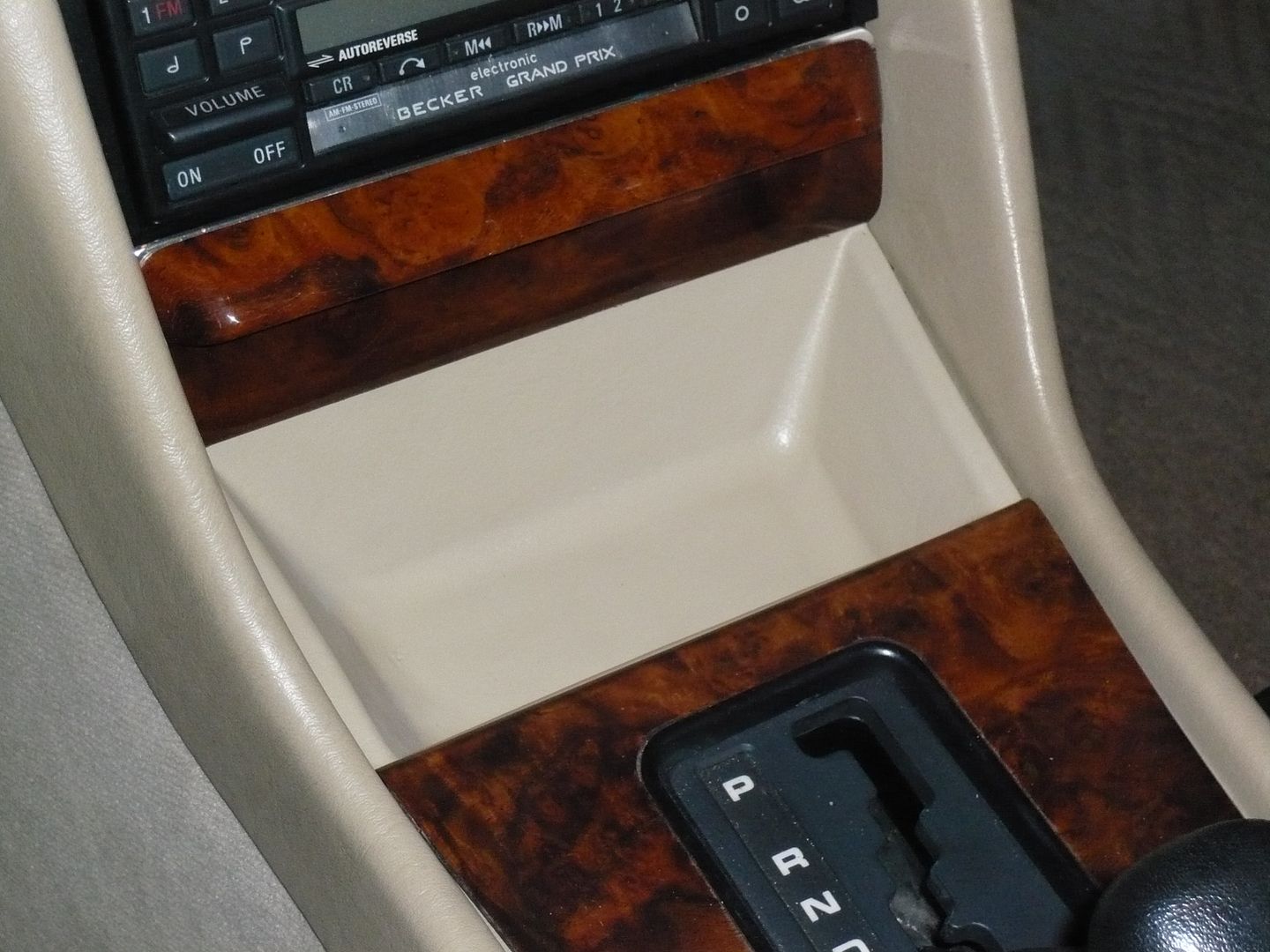

Just one pic today, picked up the tray from Billy after having its final coat of matte clear, looks great!

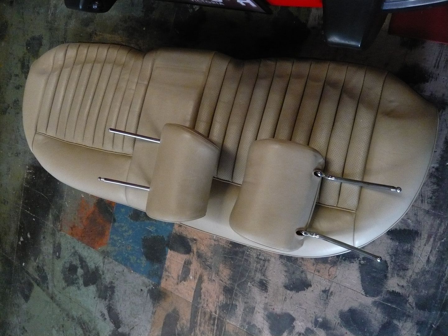

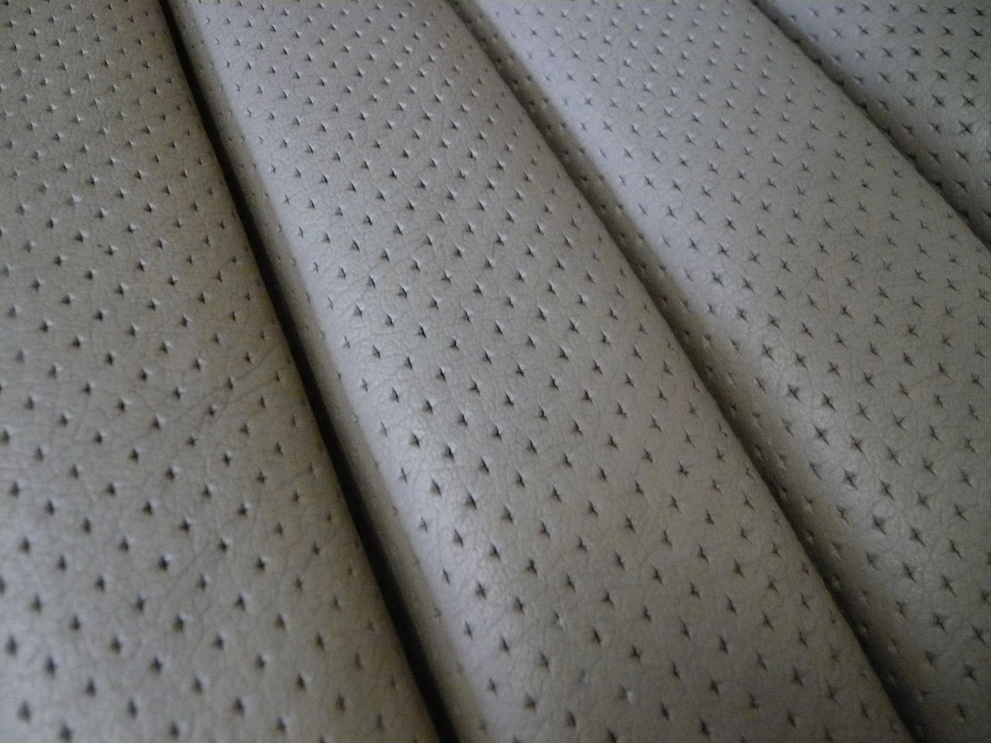

The next job is to clean the leather properly. Seats coming out, beginning with the rear:
My helper Paul at work!
The process is quite time consuming. Firstly, cleaning the leather is quite slow and laborious. Particularly in this case, as I don't think it had been cleaned before. However, slowly the leather is coming back to life. The Connolly Hide Food has been applied generously and left to soak into the hides over the past week. I'll give it another go in a week or so. No rush.

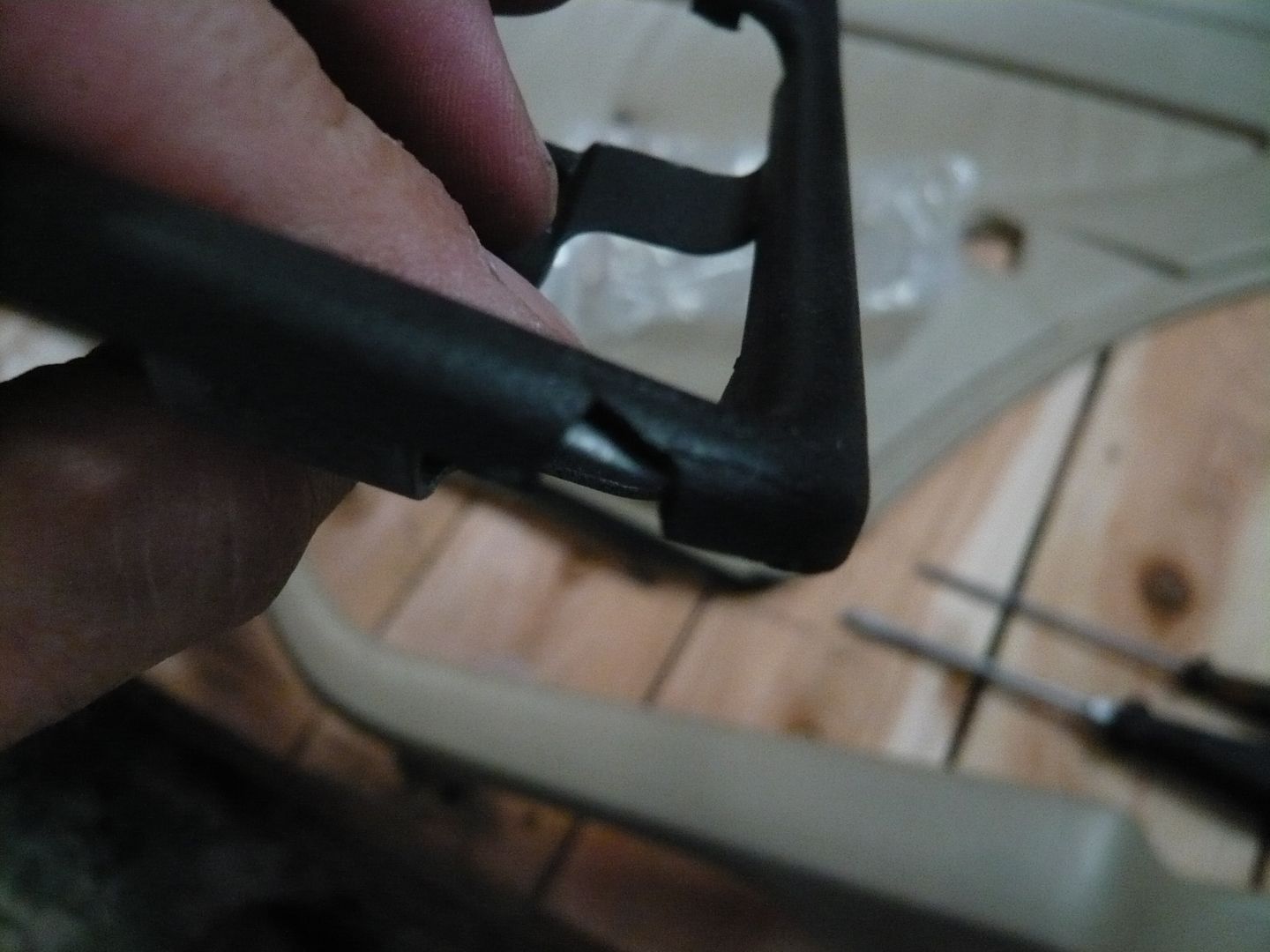

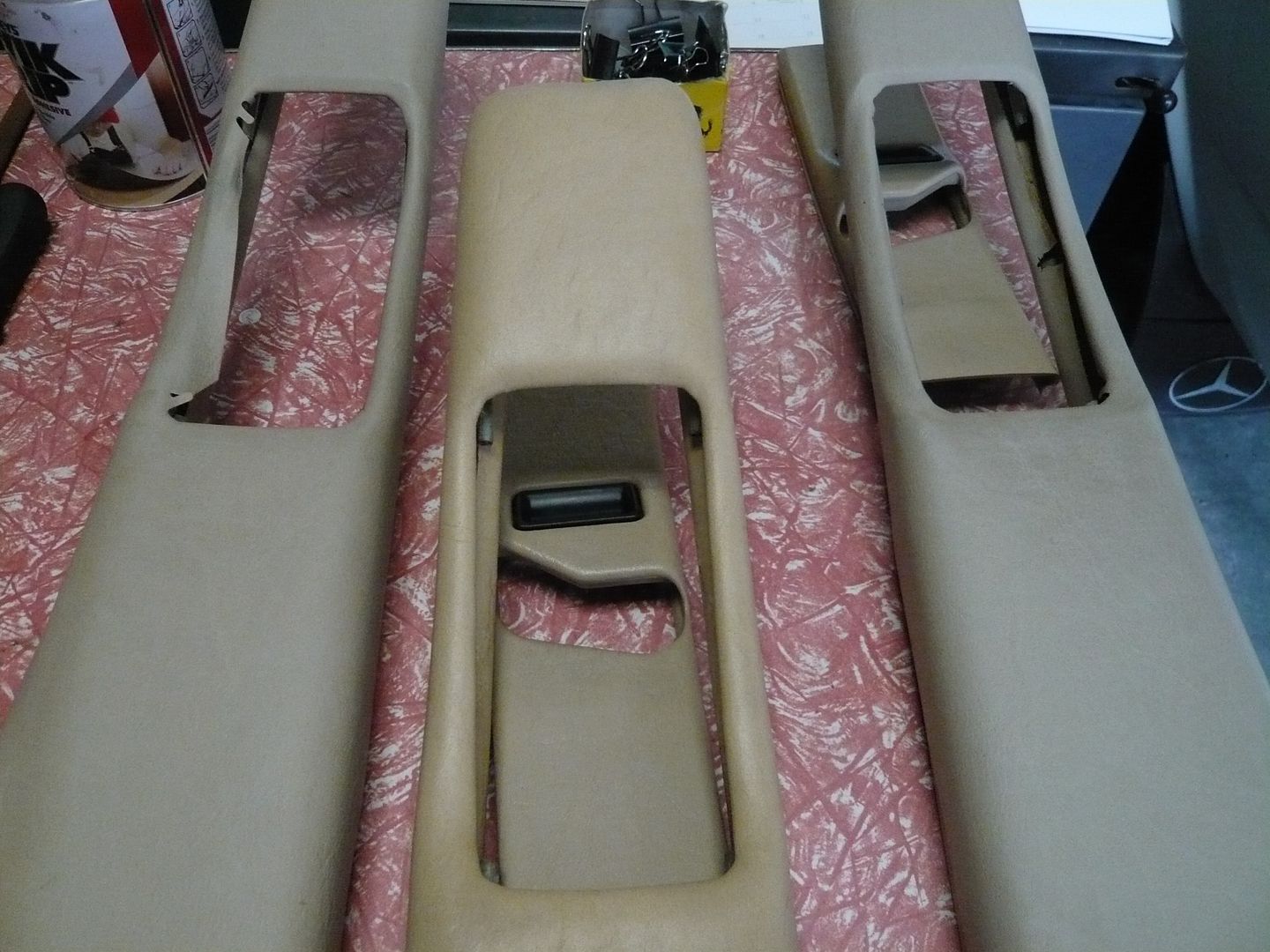

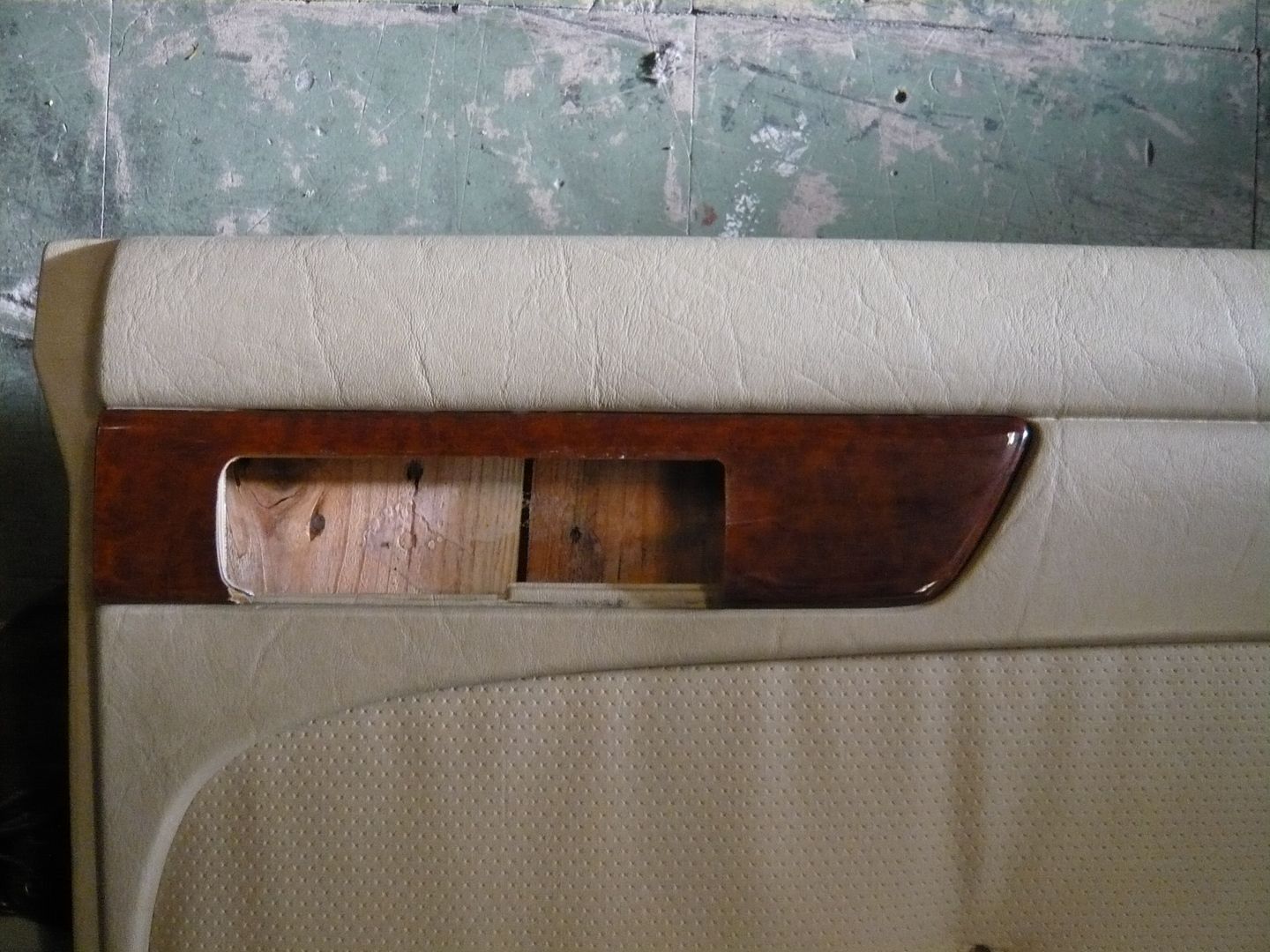

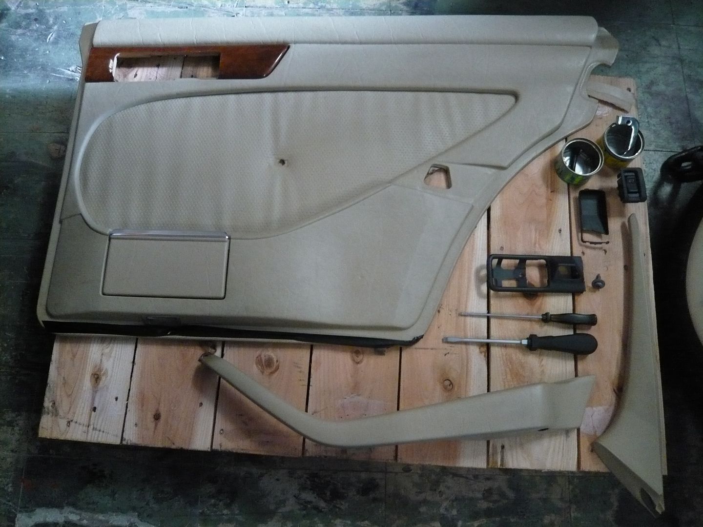

Particularly disappointing is the damage to the drivers side rear door trim (The electric window is inoperative) that is clearly the result of a ham fisted mechanic. Whoever performed the 'Repair" couldn't even remove the liner in one piece. Thanks to my friend Robert, his 500 SE donated the required fasteners and trim items.

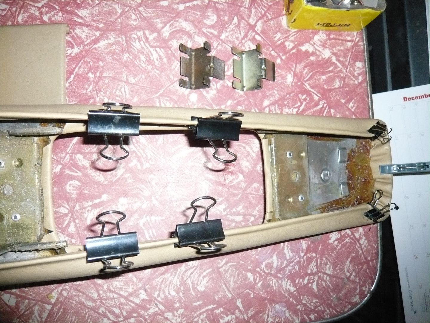

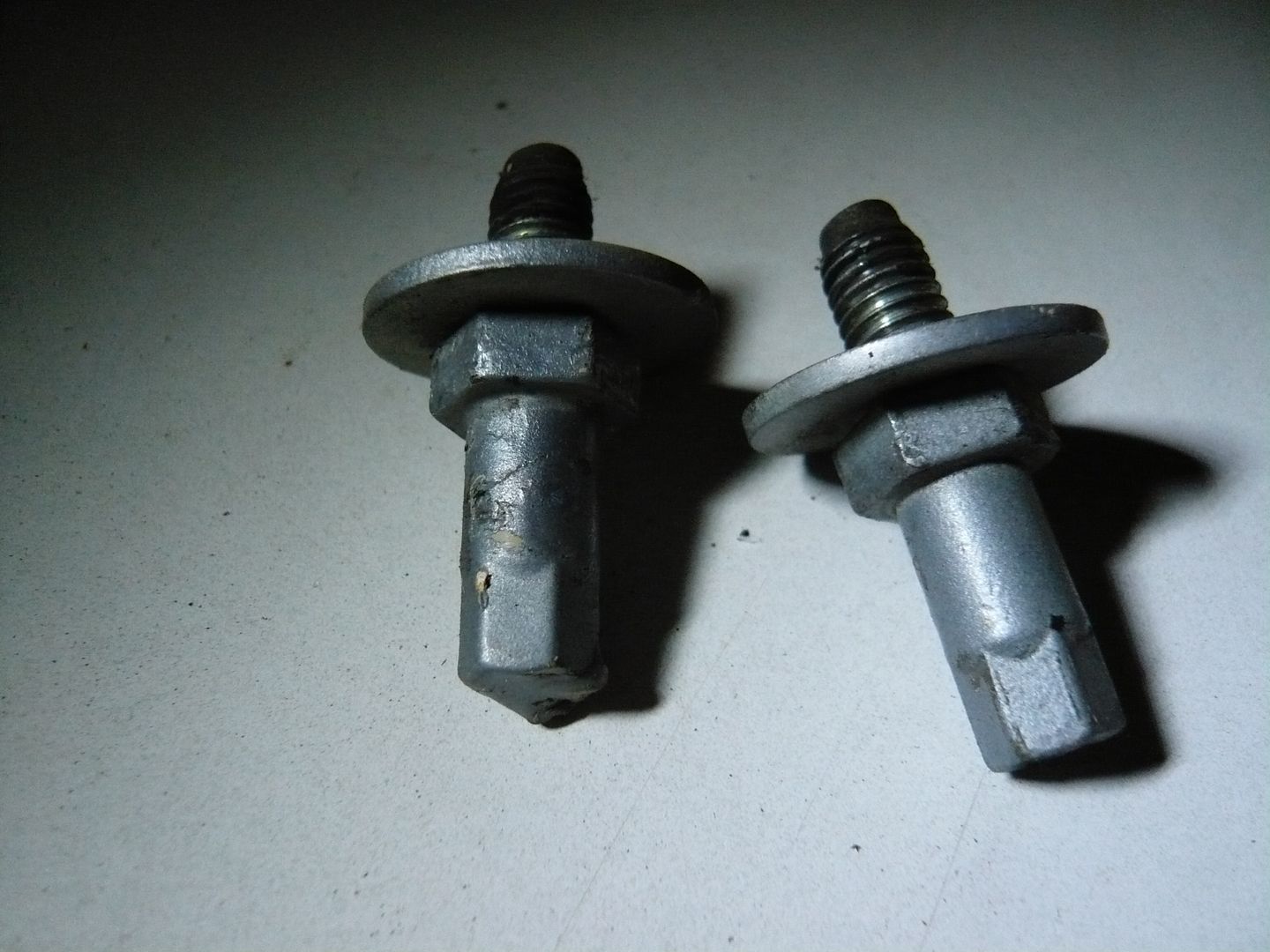

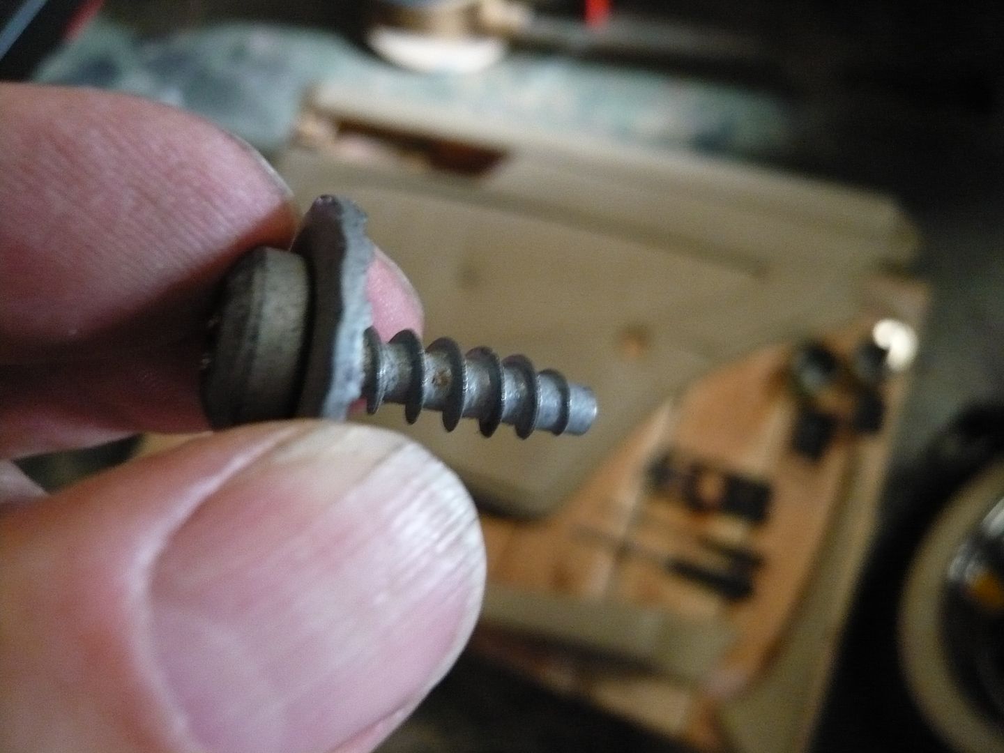

This was the fastener used to affix the centre section of the arm rest to the door trim...........I think it's a roofing fastener......
Here is the lower section of the window regulator, broken away from the slider in the base of the window.
It's a little tricky to replace, the new part is below, you need to grind off the head of the slider, replace it with the new part and pein the head over the regulator arm. It's a little Heath Robinson-ish.....not sure why a simple plastic bearing with a captive nut on the slider would not have been better?

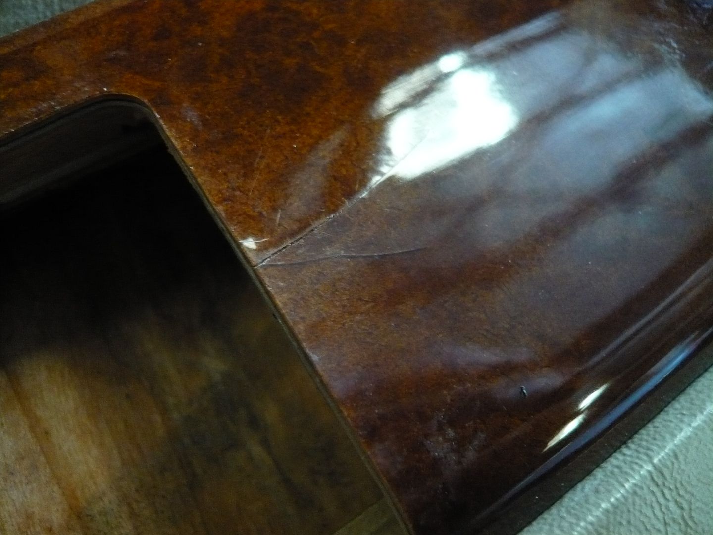

On another matter, I was disappointed to see more damage to the timber work. It appears a lever of sorts has been used to remove the electric window switch and in the process, cracking the veneer on the drivers side rear capping. I hadn't noticed until I took the trim off. Anyone have a spare in walnut in perfect condition?
The process now is to remove the front seats and clean and feed the leather. Clean the carpets properly and perhaps even give the headlining a wipe with Dissol! When the front seats are out, I'll replace the drivers side "B" pillar trim, it's torn. Finally, I'll remove the other three door trims and clean them and check the window regulators. A secondary benefit of this is to gain access to the inner doors so that I can have some paintless dent removal performed. More later.

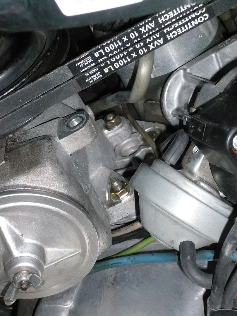

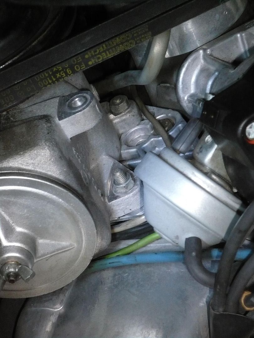

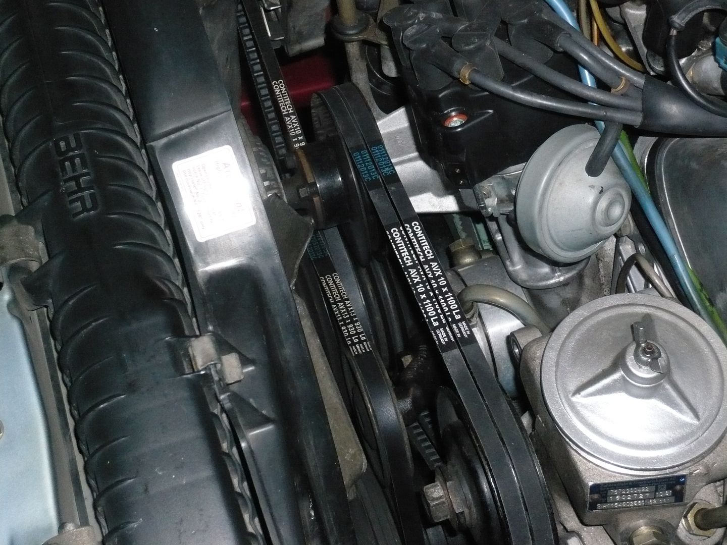

A quickie, thought I'd be smart and change the "V" belts as a precautionary measure this evening. I read the sizes straight out of the owners manual, then checked in the workshop manual. I couldn't read the sizes from the belts that were fitted.
No problem with the water pump/power steering and air conditioning compressor, however, the alternator belt has caused a problem. In the owners manual, the size for the alternator belt is quoted as a 9.5 X 990mm. The WSM also quotes this size, however, it lists the pre-energy concept M116.961 engine as a 9.5 X 950. The post 1981 to 1985 M116.963 (As fitted to my 1985 car) coincides with the owners manual as a 9.5 X 990.
Imagine my rage when I pulled the belt off and discovered it's a 9.5 X 950, as what should be on the earlier M116.961 engine!
Anyone else has this problem?

Re the broken window slider plastic piece. This is a piece of shite. Mercedes engineers must have been on another planet when they designed this crap. Previously I have replaced my broken sliders with an identical one like you have. However, even these have broken again.
Anyway I ordered in some of the solid one piece slider pieces from Mercedessource in the States. Here is a link on their site:
https://mercedessource.com/store/search ... tegory=All
The problem with the original white plastic sliders is that they come in two pieces and are prone to fail. The solid one piece sliders should last for years.
Hope this helps.

Post by AMG » Fri 21 Feb, 2014 3:39 am
Most belts are 10x or 11x these days. They sit a little higher in the pulley and grip a lot better.
Get genuine conti belts if you can they are the quietest and longest lasting by a good margin in my experience.

Post by carl888 » Fri 21 Feb, 2014 6:41 pm
Kim...thanks for the tip. I did see the uprated window sliders and was tempted....however I've not broken one before and I noticed that the friction of that affected window is greater than the others. So I'm wondering if the issue is not the slider, but rather too much leverage required to open it? The fastening method I agree is poor, a rivet surely has no place in this position? We will see I suppose. I've not broken one before, but I notice in the documents that came with the car, there is a receipt for a previous repair to that faulty window regulator. I will check the runners before assembly to see if I can ease the increased friction over the other windows.
Joe...interesting, the replacement Conti belts I bought are marked 10mm, but are in fact, identical in width to the OEM Conti belts I removed marked 9.5mm. Perhaps they changed the way they measured the width :) In any case, I bought a 10 X 960 belt to replace the 10 X 990 belt and it fits a treat. I am still confused at to why the owners manual and WSM state it should be a 990.
Some pics, the new belts (On the right of the first image are four new exhaust clamps, more about that later).
Here are the original belts for the water pump/power steering pump, and predictably, the 13mm hex nuts that hold the power steering pump to the bracket were burred. When I undid them, the upper stud backed out of the bracket as well. Sigh, what's wrong with these people over tightening things! Notice the belt marked 9.5mm
After replacement, new belts and hex nuts on the pump.

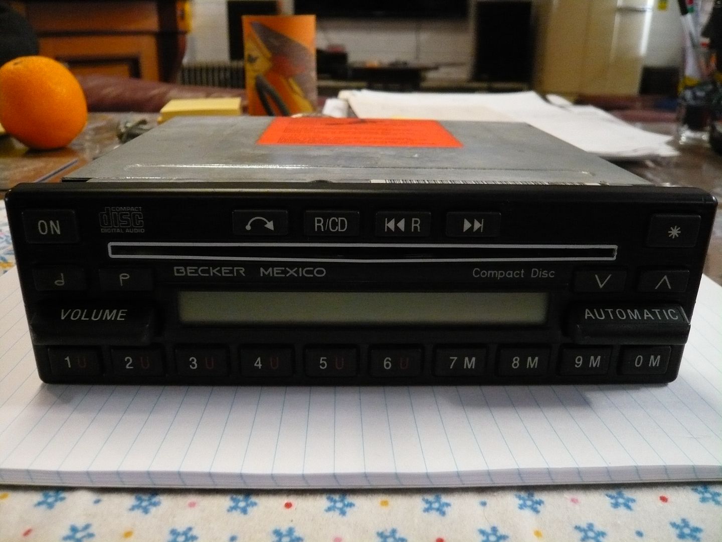

Another little win today, I've been chasing one of these for ages. A Becker 848, only made for two years apparently before being replaced by a stacker for the W140. Was standard on the late 560s only. Undecided whether to fit, but not a priority at this stage.

Do you have the amp for Becker CD player? Where in the car would you mount the amp if you were to install it? In the boot behind the right rear wheel is where they went officially, how hard is it to retrofit an amp here?
Paolo

I do not have the amplifier for the Becker 868 sadly. And I imagine it would be somewhat hard to find too! But I'm a patient man, and one will turn up eventually.
I am not aware of any thermal ventilation requirements for the amplifier, and I would therefore probably put the amplifier under the glovebox, there seems to be room there. I'm not that partial having to run two sets of wires to the boot, then forward again for the front loudspeakers.
I did manage to find an instruction book however, so I can work out what is missing!
http://www.koenigs-klassik-radios.de/en ... 8/a-55065/
I wonder if there is a demonstration CD like there is with the cassette version?
I see there is also a Becker 865, I wonder what the difference is?

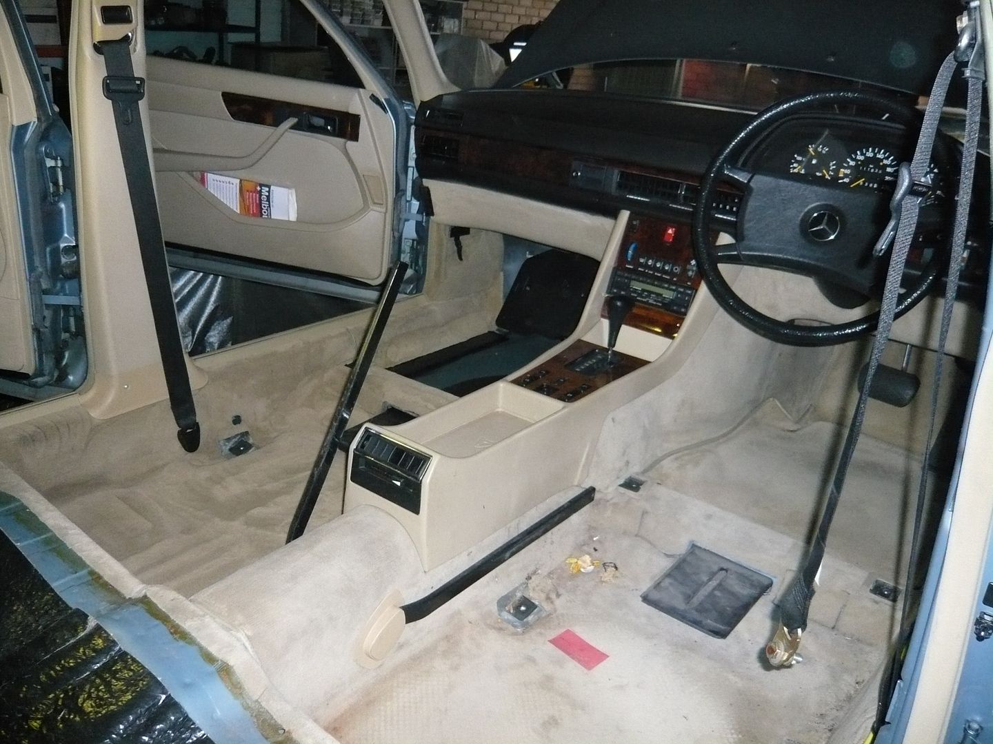

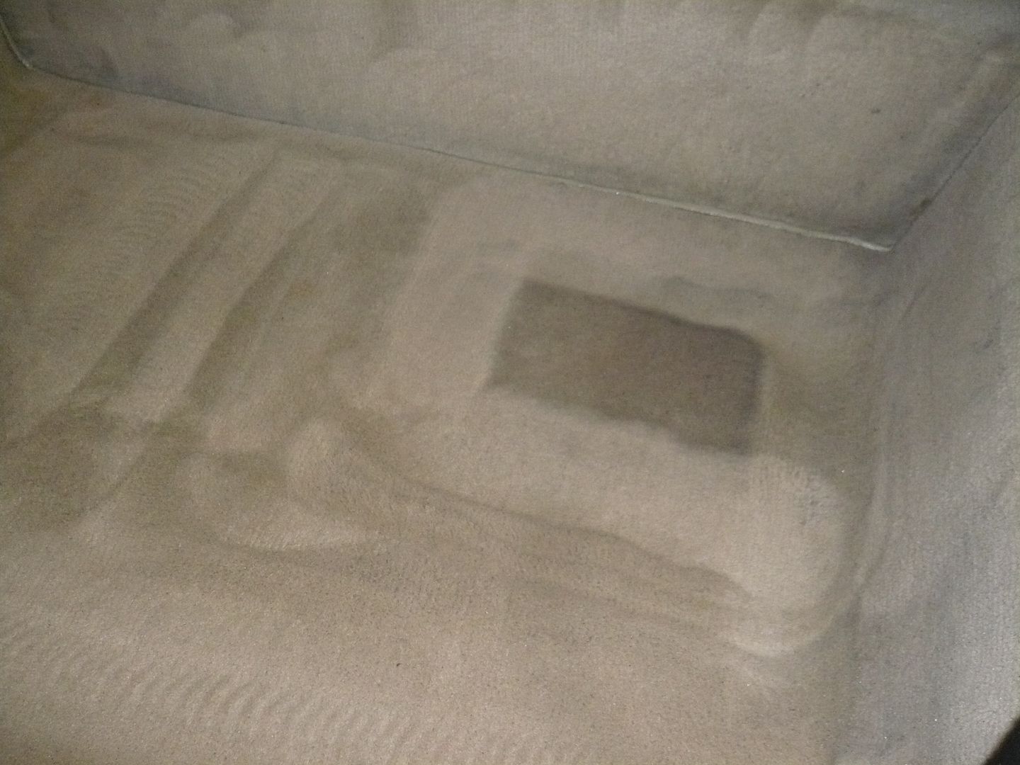

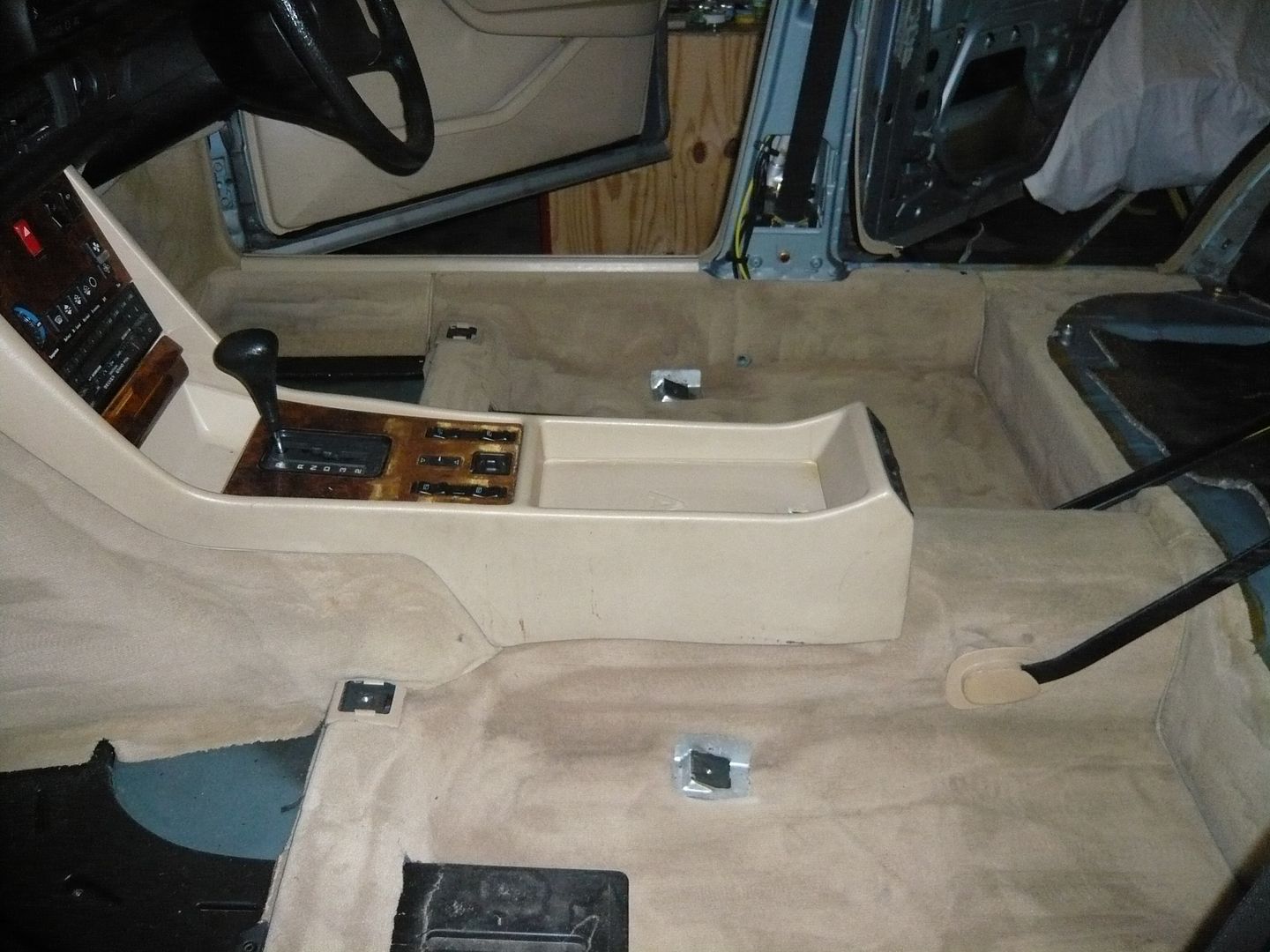

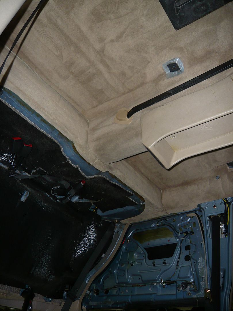

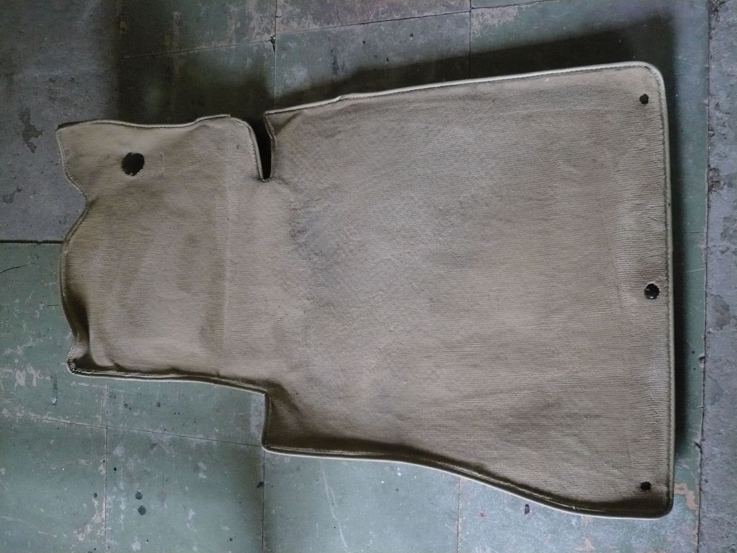

Moving on to the interior...not quite sure where to start. The seats are out, a few more leather feeding sessions to go and some work to the interior, gosh it was really grotty. Funny how a car interior seems so much more expansive with the seats removed!

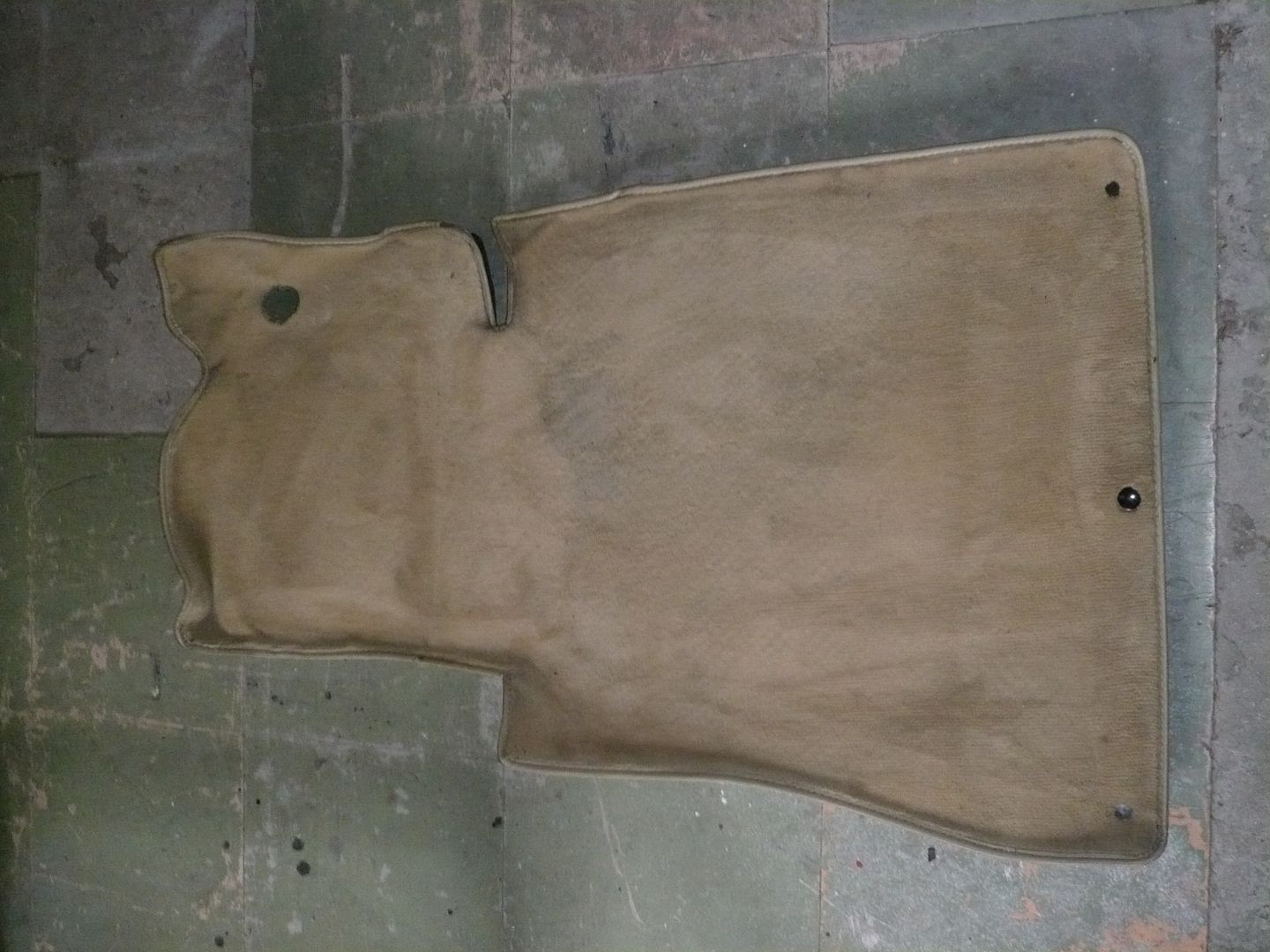

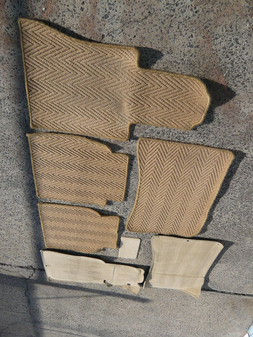

Time to get stuck into the carpet. I saw a demonstration of the Tornador Classic carpet cleaning gun at Motorclassica and bought one on the spot.
http://www.tornadorcleanau.com/#!produc ... asic-z-o10
Its ability to lift dirt and grime from the carpet piles is unprecedented in my experience. You do have to be disciplined the way you use it however, holding the trumpet about 2cm from the carpet and using it in a circular motion worked the best. It's also pretty air hungry, about 250 CFM it merrily consumes, so it will work the average compressor quite hard. It took about five hours to do the whole interior twice, including the mats. Well worth it.
I thought the carpet was clean until I used this gun. Have a look at the cleaned section, the rectangle is the area I haven't cleaned yet:
The carpet before cleaning:
I have run the gun through the centre section of the foot rest:
Some images of the carpet cleaning:
The removable front mats were shown no mercy:
Same with the over mats, cleaned on the left, before cleaning on the right:
Outside drying:
Whilst the carpets were drying, time to get stuck into that wayward "B" pillar trim. The drivers side was torn:
Found a perfect (The driver must really have never used the belt) drivers side "B" pillar trim at Pick-a-part on my last visit. The only issue being it was a slightly different colour, despite being cream 275. The camera shows the difference well, but in real life it's hard to pick. Oh, it's the one in the middle in the first picture :)
Even thought the replacement trim was undamaged, the trim was starting to lift, so best to use contact adhesive to re affix it. Left over night to cure. Same with the passenger side.
Inspection of the RS system revealed that had never deployed, yet!
It was heartening to see how clean and tidy the car is behind the trim (As I would have expected) but you never know! Rear door trim removed to repair the window regulator. The other three door trims will also be removed to attend to some paintless dent removal in the doors. On good thing, the car has a spectacular head lining, no marks, stains or creases, phew. From there the skirts and bumpers will be removed and into the paint shop to repair the scrape in the DSR wheel arch, and numerous scrapes and marks in the skirts.
It's been a busy last few days, more later.
