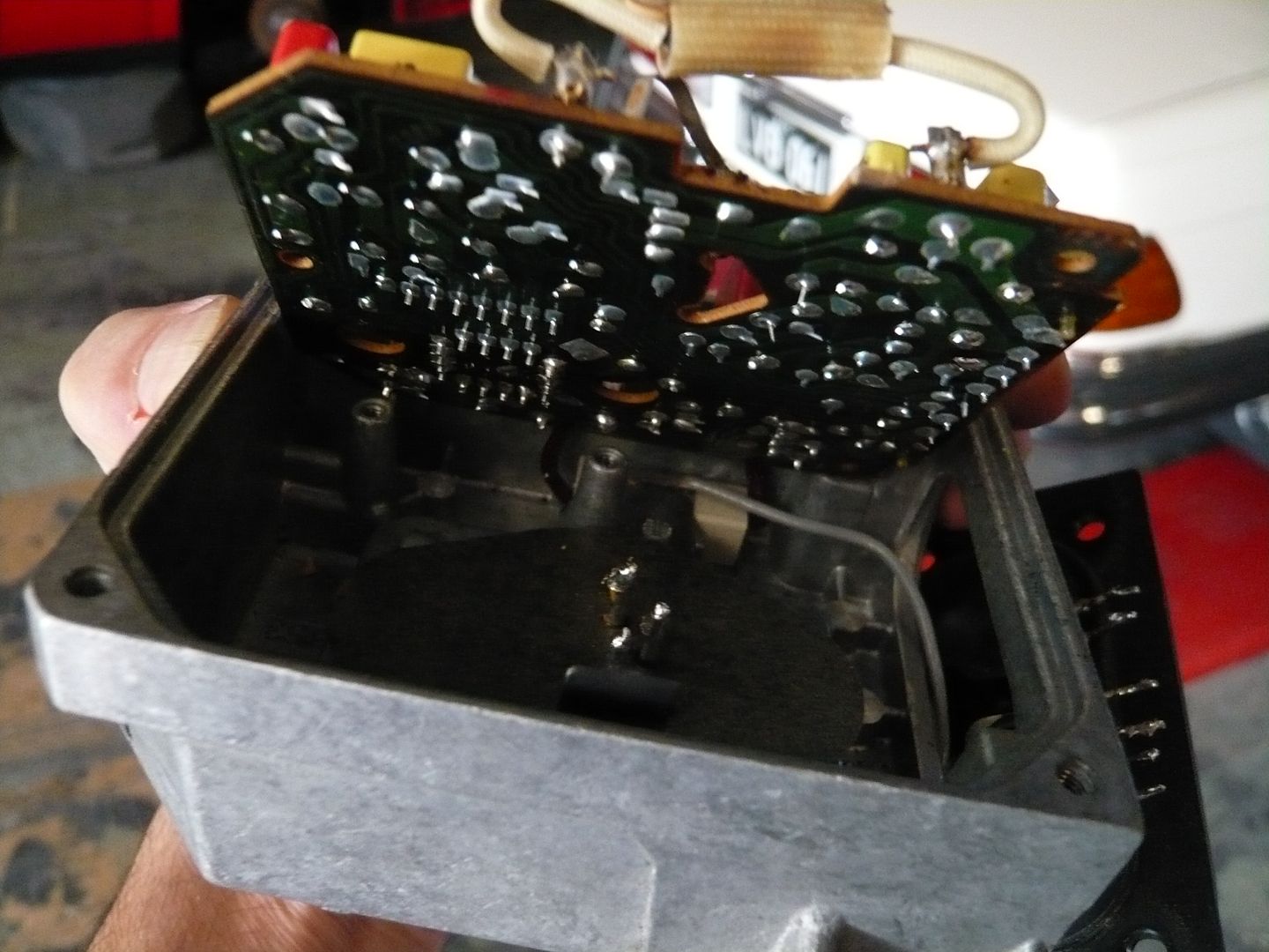

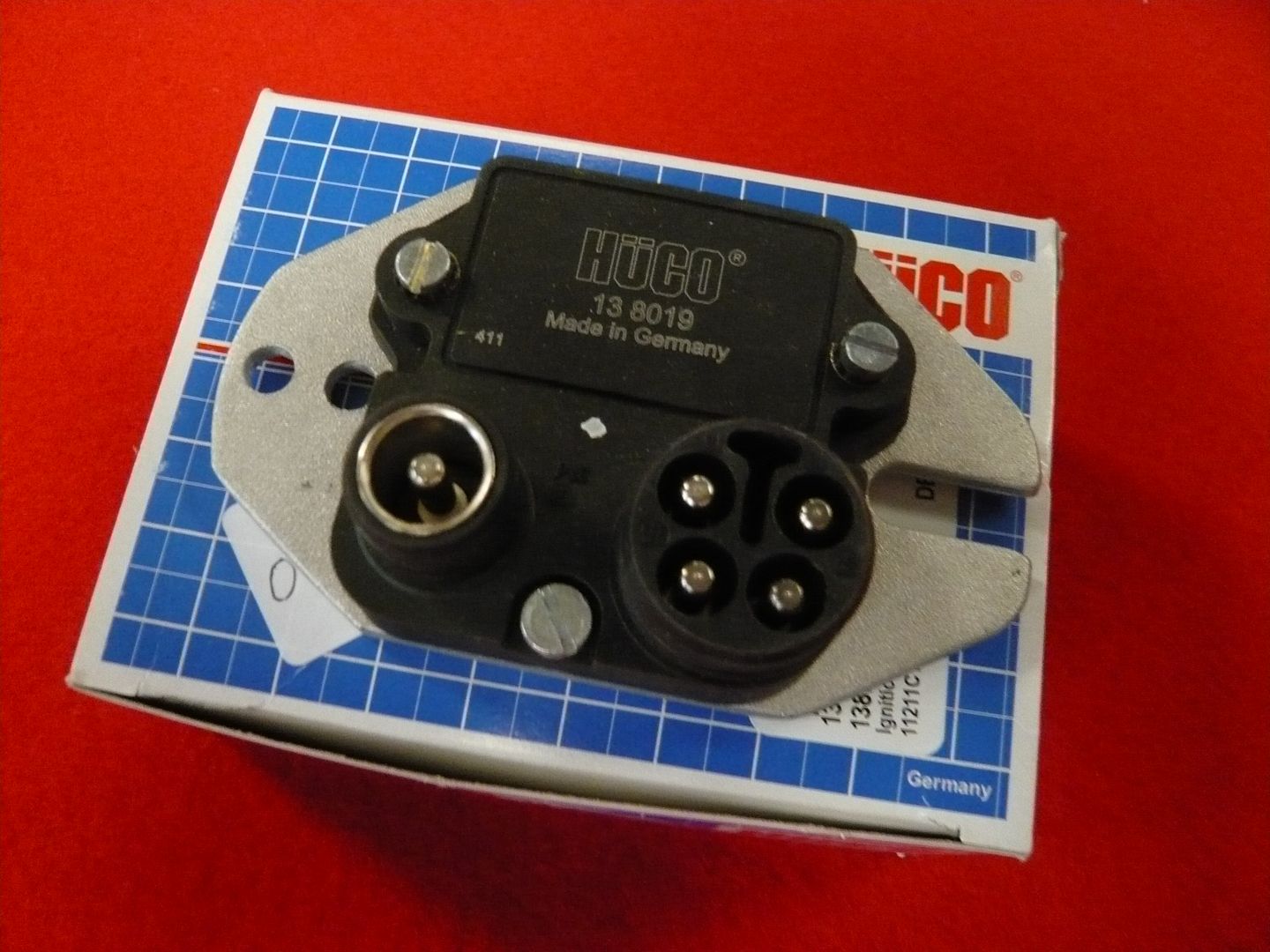

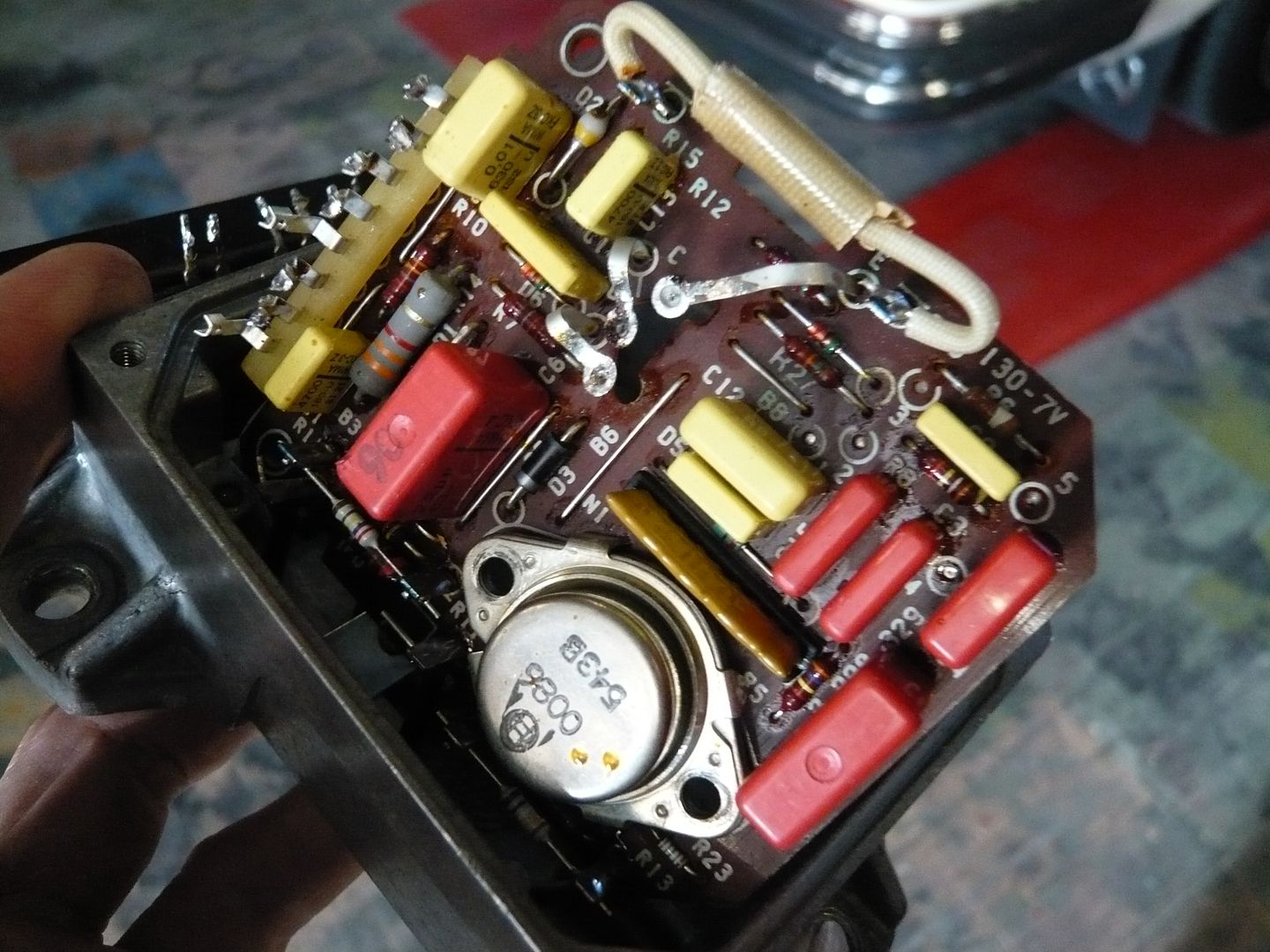

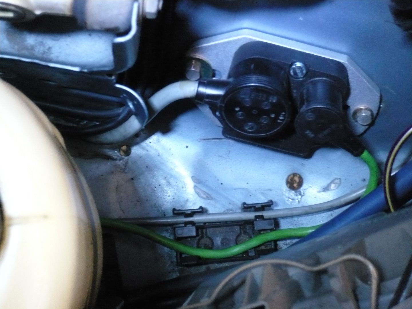

Fixed the intermittent no start with a new ignition module. It wasn't exactly a drop in replacement, I had to mount it upside down and bend slightly a bracket (Not used for anything) on the base of the ABS pump to stop the cables from chafing. Pics:

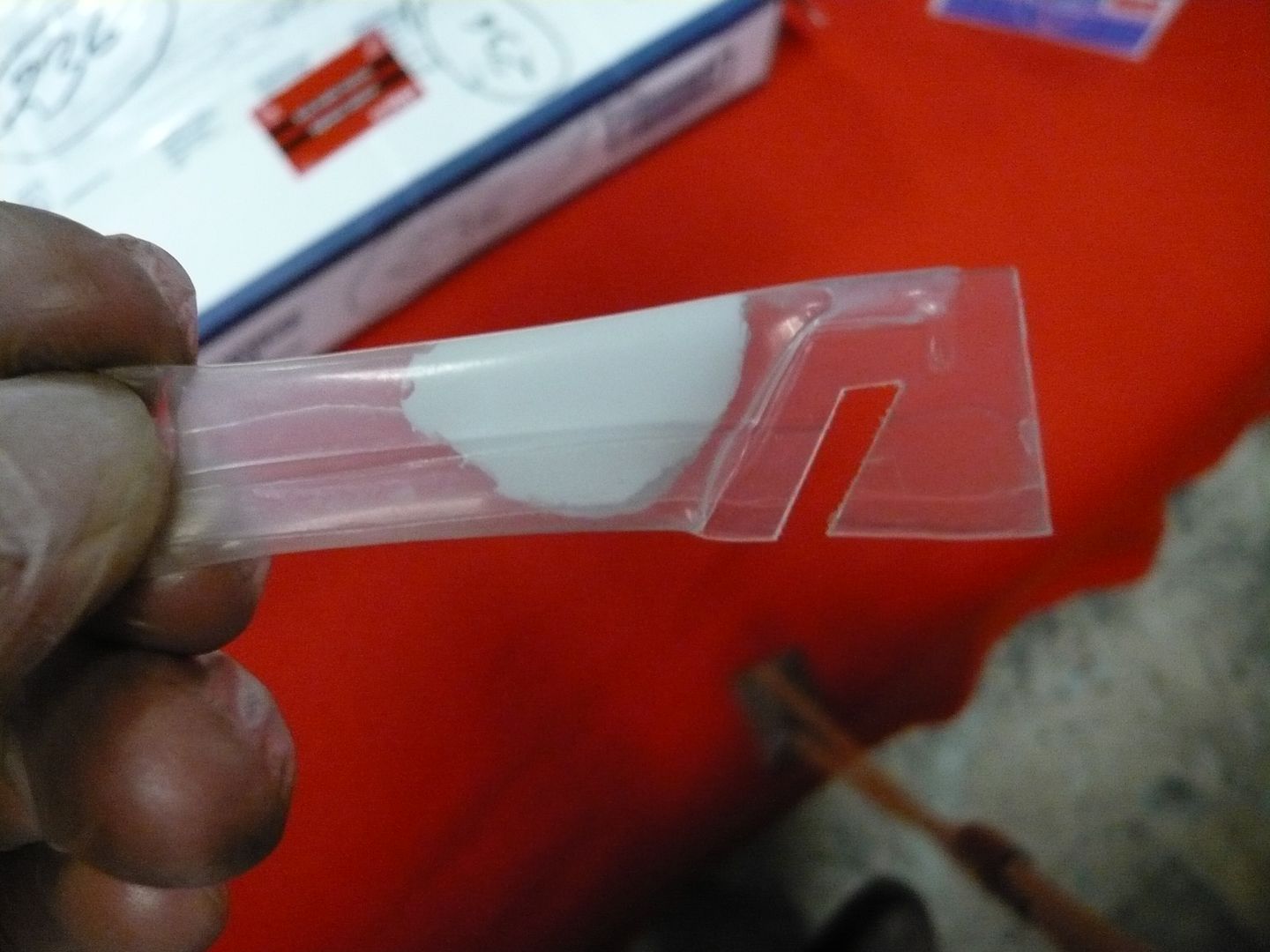

I wonder if this is beryllium oxide (For the heatsink, supplied with the unit) but it sure looked like it to me! Applied to the back of the unit.
I pulled apart the old unit, both T03 cased transistors checked out ok, so possibly a dry joint, now a desk paperweight.

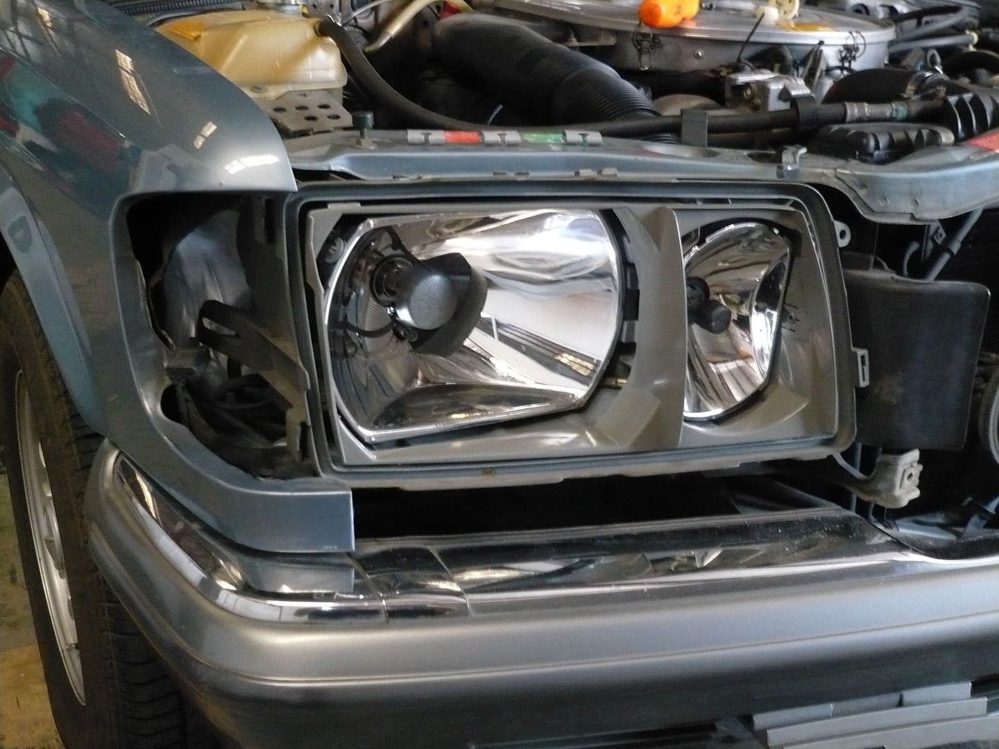

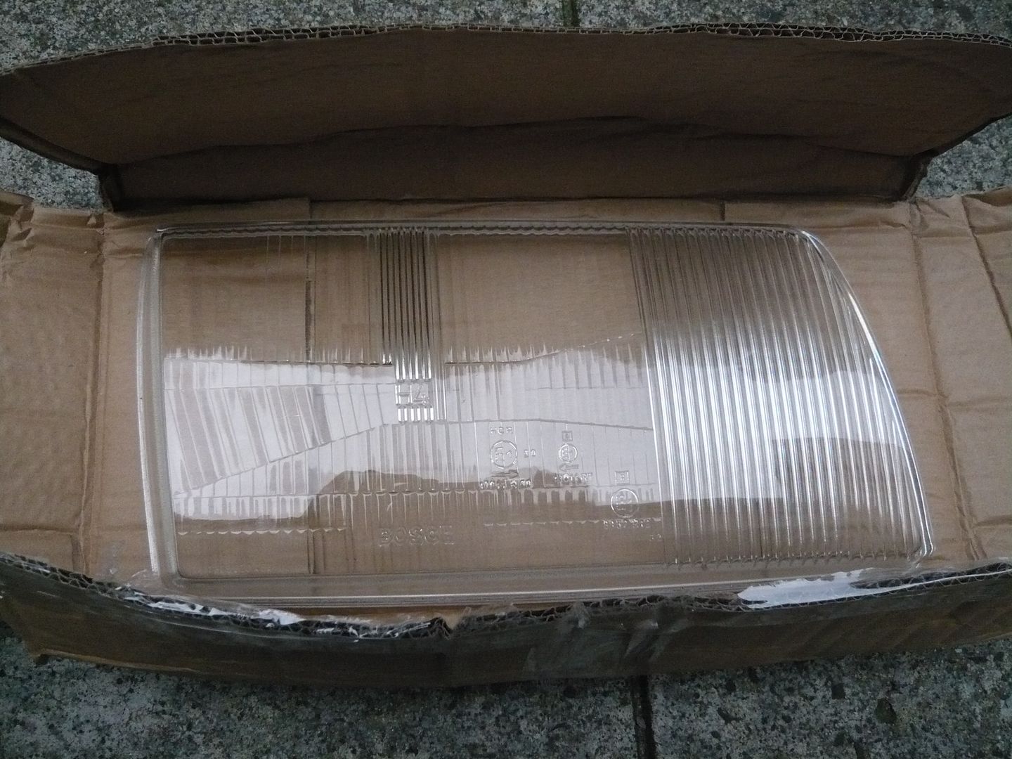

Now to replace the LHD headlight glass with the correct RHD unit, of course, two of the headlight glass clips were missing. What's wrong with these cars, and this was dealer maintained...
Of course in removing the indicator part of its mount broke, out with the JB weld!

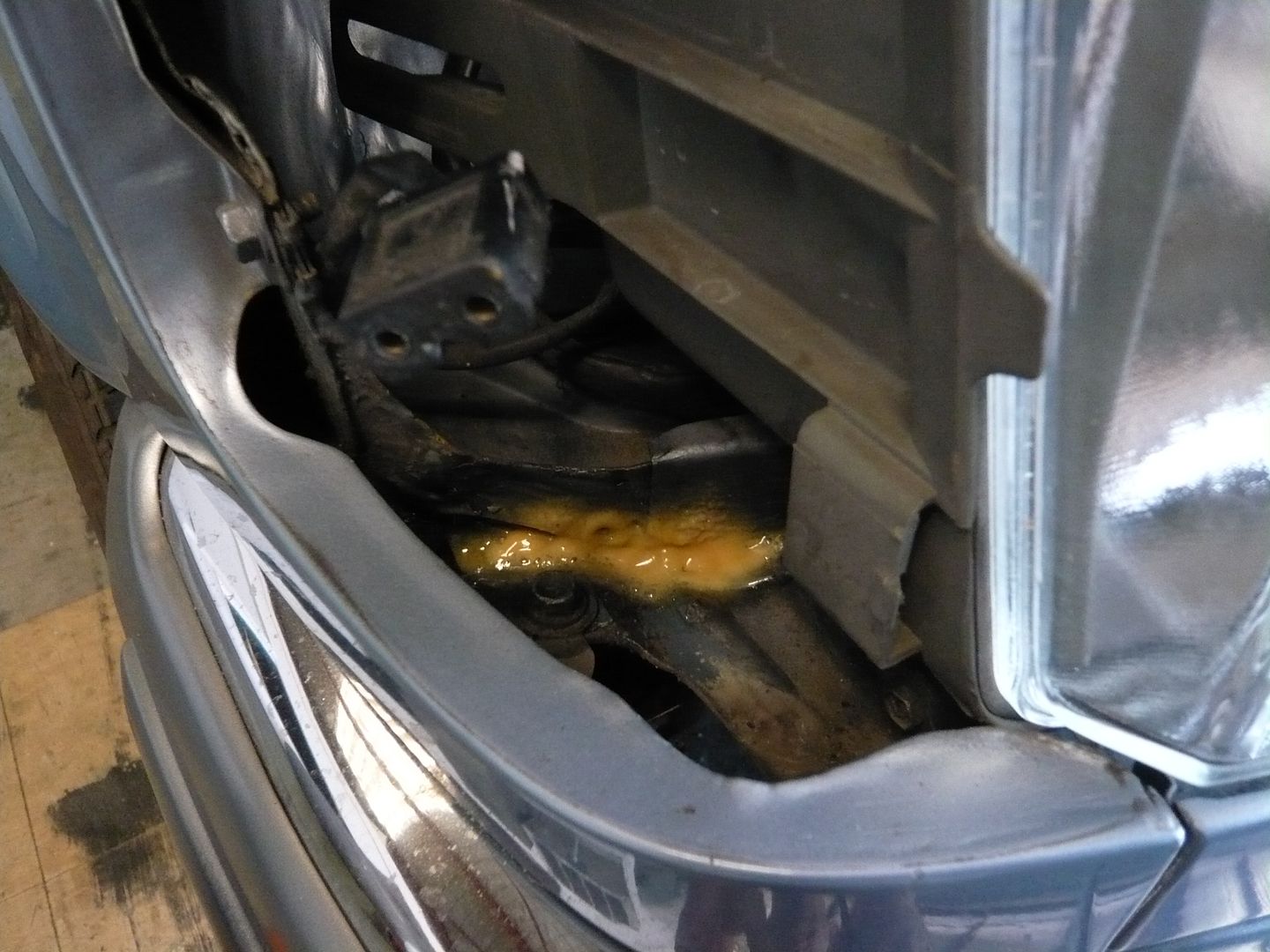

Lets throw a little cavity wax in here before it goes back:

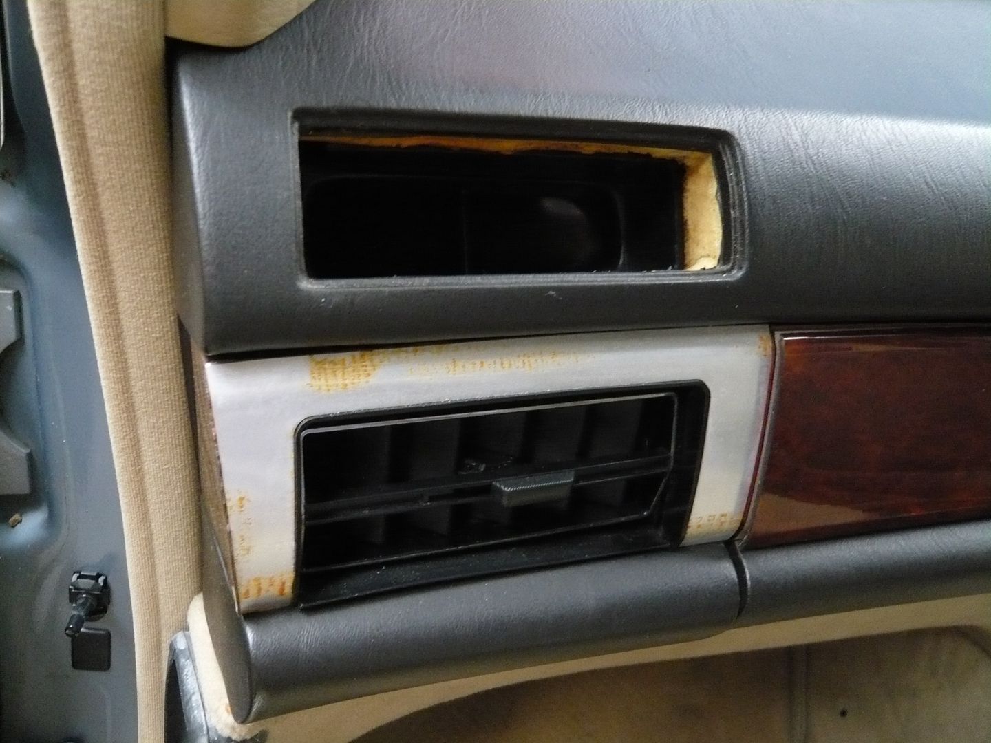

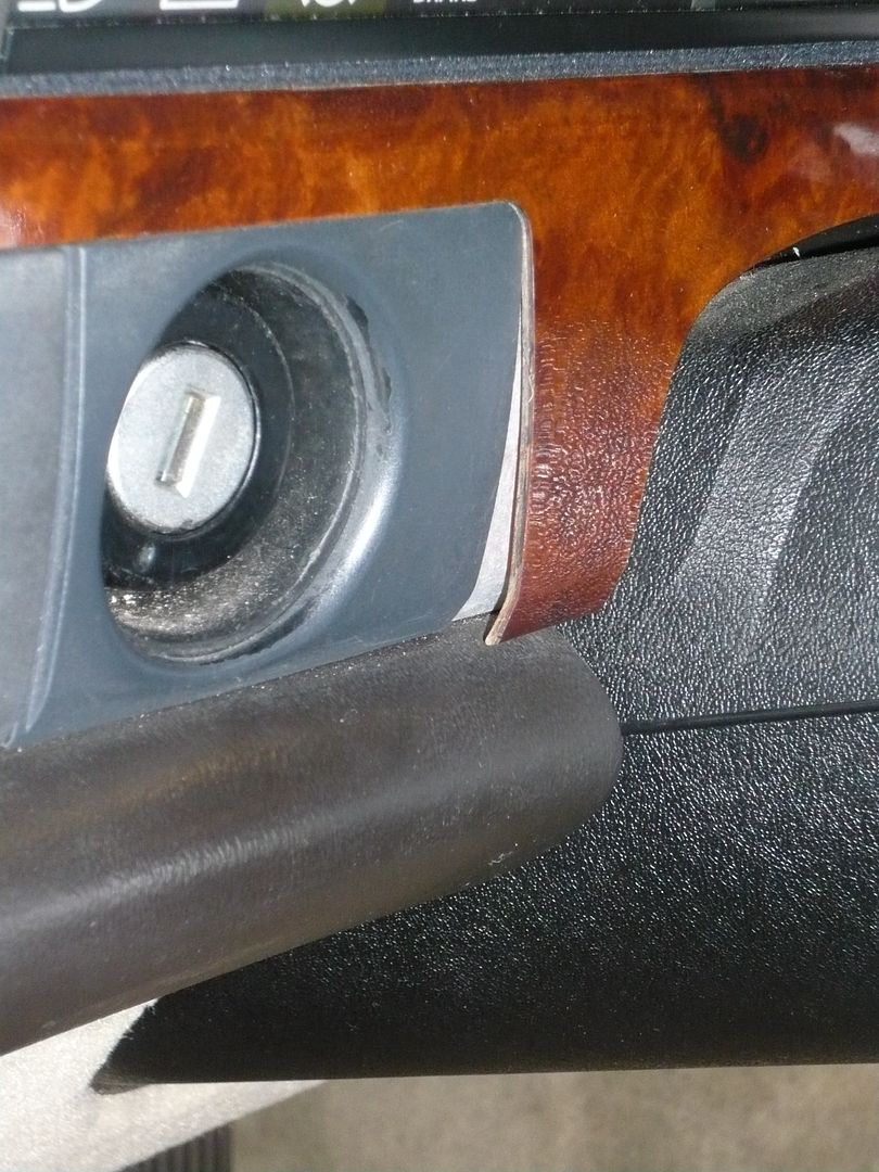

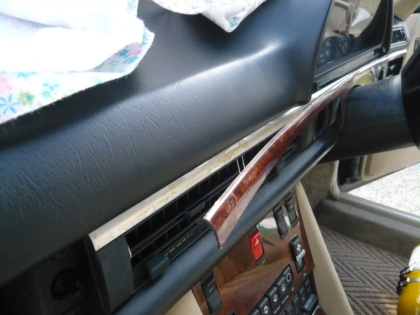

Back to the cosmetics. I am unsure as to why the walnut veneer had delaminated. I suspect the interior has become very. very hot in the past. Which is odd as there are no cracks in the dash at all. Anyway, started by cleaning off the old adhesive in preparation for the contact adhesive:
And notice around the headlamp switch:
And ignition switch:
Here is my improvised veneer clamp!
and
And for the glovebox, managed to score this:
http://www.ebay.com.au/itm/310539395008 ... 1497.l2649
Let's see what it's like when it arrives. Still need to source the trim for the area around the left hand vent, anyone?

Ooops, forgot, here is a pic of the tidied up headlight.
Posts: 1554
Re: 380 SE
Post by KimB » Wed 06 Mar, 2013 2:34 pm
Looks fabo!

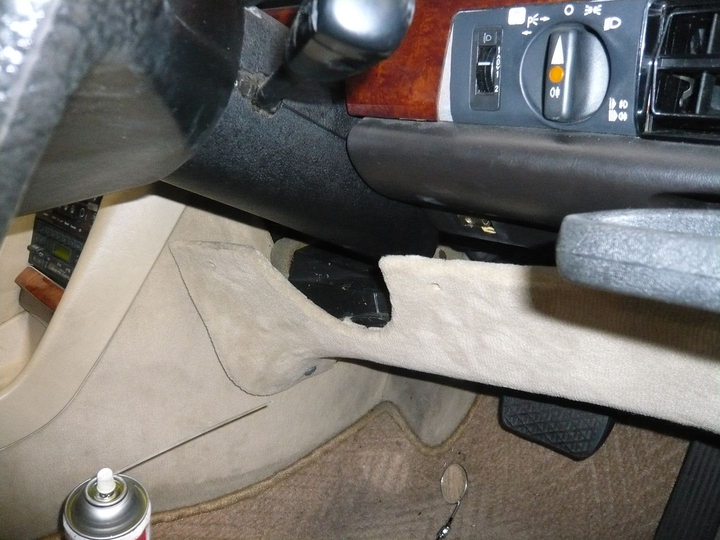

Joy of joys, a parcel arrived today and contained this; of course I had to install it immediately! Came from a 500 SEC out of the UK.
Easy to install, just have to be careful to ensure the internal catch sits atop the plastic trigger at the back of the handle to open the glovebox. The veneer match is not quite the same, under certain light you can see the differing grain, the flash accentuates the difference, under ambient light, it's very good.

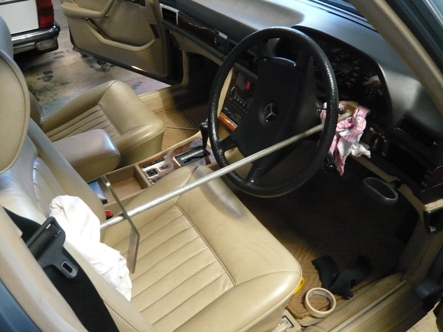

Update, removed the LH vent trim no problem, a bit involved, have to remove the glovebox liner, pics to follow when the new trim arrives.
